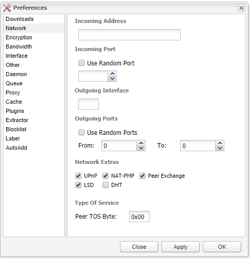

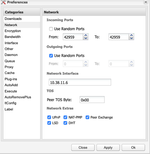

I recently switched almost all of my torrents from uTorrent 2.2.1(25110) to Deluge 2.0.4.dev23. The files have always been on a server here in the house, but the torrent client was on my desktop. Now, the client and files are on the same server.
Install wasn't without headaches, but I know just enough networking to keep things running as I need them to be.
I added ~450 torrents to Deluge, and things were mostly going well. A few errors here and there, but fixed. Today I find that 290 torrents are giving me Error: Port 6881 is blacklisted.
Here are the Port Mappings as shown by the Docker tab in unRAID:
172.17.0.2:58846/TCP192.168.3.195:58846
172.17.0.2:58946/TCP192.168.3.195:58946
172.17.0.2:58946/UDP192.168.3.195:58946
172.17.0.2:8112/TCP192.168.3.195:8112
172.17.0.2:8118/TCP192.168.3.195:8118
Pretty sure the last two are for the webui. The 58846 port is forwarded in pfSense and open when tested using GRC ShieldsUp! 58946 is closed. Not sure why.
I can't find 6881 anywhere in the .config files for deluge.
I don't use a VPN.
Please help. Where do I start?
Edited by jeff.lebowski
I don't use a VPN.
58846 is the deamn port. Your issue is 6881 is the default port which is why is blacklisted. Go into Deluge via the webgui > Network. What ports do you have set up here?
16 minutes ago, jeff.lebowski said:
You are missing information. I suggest posting your log file. Make sure to remove any info with username/password/wan IP before posting it
I'm using binhex-delugevpn and this is what mine looks like.
