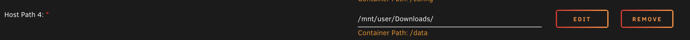

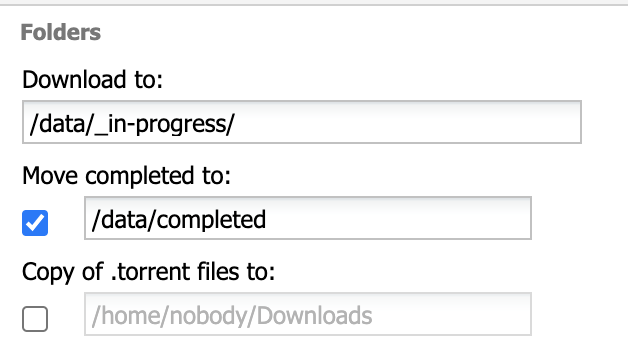

Hi guys, I'm having some trouble with DelugeVPN in combination with PIA since a couple of weeks. I read a couple of pages back but couldn't find my exact issue (also checked the FAQ), so maybe someone can point me in the right direction.. I also had the Exit code 52 thing at first, but first that by updating my PIA files. I'm using France (and tried Sweden and some others too) as ovpn file.
The problem: Everything starts up fine. My torrents get added to DelugeVPN. But they all hang at 0.00%. The docker container logs show no errors. What could possibly be the issue?
It also shows IP: N/A in de bottom right of Deluge. Not sure if that's supposed to happen.
Edited by Hypercube
this sounds like a classic case of incorrectly configured incomplete and completed folders in deluge, can you post a screenshot of your settings in the deluge web ui for the incomplete and completed folders settings?

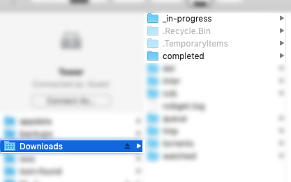

I'm not the OP but I've had this issue too and the only thing that fixes it is rolling back to older versions
