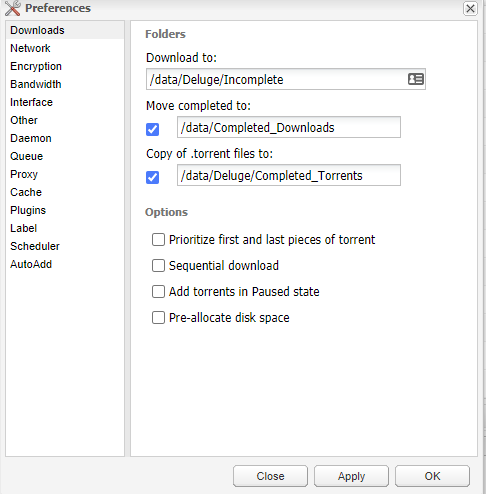

Morning everyone...I'm having a strange issue.  Deluge is only moving SOME of the downloads it completes to the folder.  Here's my settings in deluge:
Here's the docker config:
Media is the share name, Process is a folder under it.  Completed_Downloads is a folder under Process.
Here's a torrent that it finished downloading):
And here it is sitting in the Incomplete:
The video file in question is complete - plays end to end without issue.
Any ideas?  Sometimes it works, sometimes it doesn't.  I'm not sure where to go looking for the deluge log file.  Clicking on Logs from the docker icon menu for the docker only shows system type logs with no log info about transfers, moves, etc.
Thanks!
