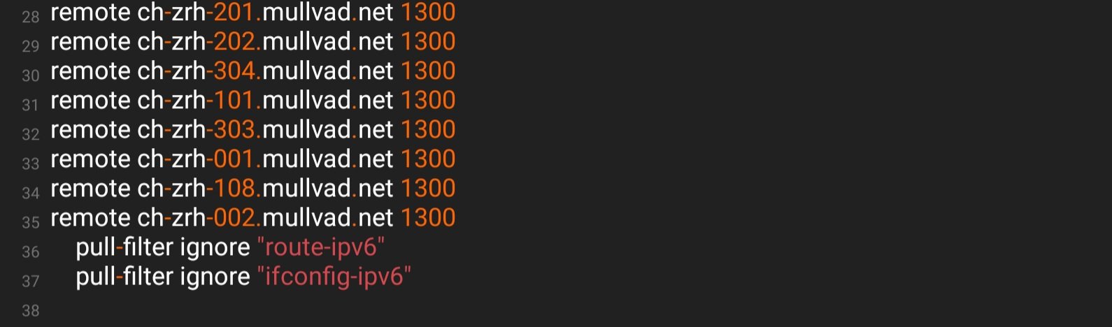

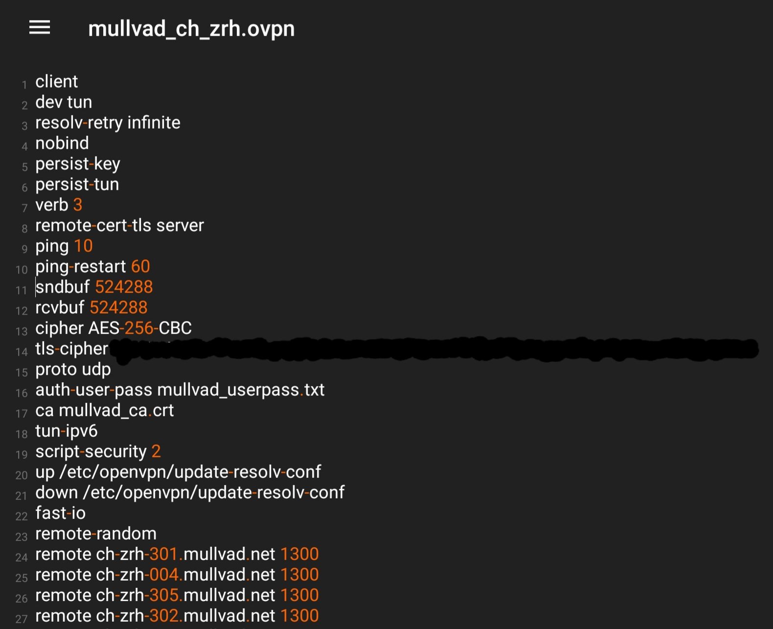

    Found the solution on reddit.   Due to the recent change in the authentication process, using your email and password for the manual connection method will no longer work. You will need to u
  • How to set up ProtonVPN in Deluge   I thought I'd share how I configured binhex-delugevpn to use ProtonVPN for those fellow paying ProtonVPN users. I don't know if this will work for the fre
  • I wanted to summarize how I got Mullvad working with DelugeVPN as I had to piece together several "solutions" from different comments in this thread and there was some incorrect info; likely old.

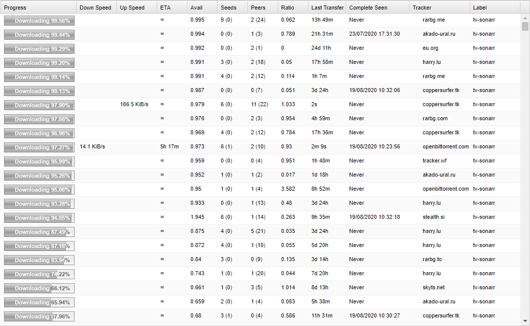

OK, so small example - 5 active torrents, this is availability & speed on PIA:
& the same 5 files on AirVPN
Difference, to me, is fairly nominal on availability - but the speed is horrendous, considering I am getting well over 10Mbps on my main rig, through both VPNs on the same torrents.
This would suggest the endpoint issues I, & other people, was having were temporary; however, this opens up a new query for me: why are my DelugeVPN speeds so bad?

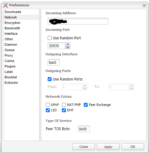

6 hours ago, strike said:
Have you set the port you forwarded in the deluge settings under network?
Can you please explain this in more detail. Thanks.
In the DelugeVPN webui, click 'Preferences' > 'Network'. The incoming port here should match the forwarded port number you've been assigned by AirVPN.
If you're configured for PIA, I believe this is automatically done for you.
(I'm not sure if the incoming address was specific to me, so I obscured it🤣)

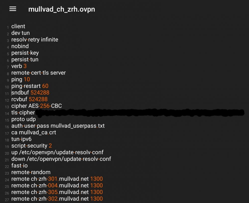

First go to https://mullvad.net/en/download/config/?platform=linux (you may have to sign into your Mullvad account first), select a region, leave "Use IP addresses" and "Connect via our bridges." left unchecked, then click "Download". This will download a .zip file with all your config and cert files.
The .zip file will contain a folder with the following files:
mullvad_ca.crt (the cert file)
mullvad_<whatever region you selected>.conf (the config file)
mullvad_userpass.txt (a text file with your account number)

Hello,
Further to my last post, I have taken out a trial with Mullvad. I am having difficulties however in getting DelugeVPN and SabnzbdVPN to work with the change of VPN provider.
I've followed the advice quoted above, however both DelugeVPN and SabnzbdVPN fail to load and the logs gives the following error;
2020-08-22 17:08:17,515 DEBG 'start-script' stdout output:
Options error: Unrecognized option or missing or extra parameter(s) in /config/openvpn/mullvad_ch_zrh.ovpn:21:     (2.4.9)
I've attached two screenshots below of my ovpnfile (the only change to within the file are the additional two lines at the bottom);
Any assistance would be greatly appreciated.
***EDIT - Well, I was reading @binhex VPN faq and decided to try copying the two "pull-filter" lines directly from his page and copying that into the config.....and that seems to have done the trick. I'm not entirely sure how as they both look exactly the same from what was suggested above, however I have been wracking my head for the past few hours so the error is probably right there in front of me. 😂
