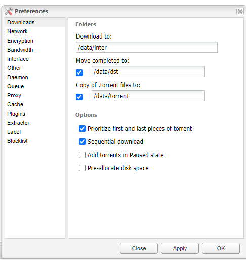

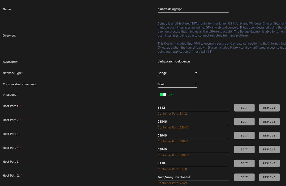

All,
I seem to be having problems with my download directory. I can't seem to get the directory right.
This shows at the bottom of the delugevpn page....
When I add a torrent it starts ok and then slowly dies off (because it seems it has nowhere to store the files???).
I think its one of those "I'm lookin' at it but ain't seeing it"🤔
How does the path provided in the docker property sheet match with the setup in the actual Deluge preferences? Does the docker property sheet = the /data directory and go from there in the actual deluge Preferences?
I guess I still have Sonarr or Radarr setup in my head.....
This is the structure of my Downloads folder:
Could someone point me to a detailed explanation of how this works? (I think I have a flat spot on my head from banging it against the wall--ow!)
Thanks in advance.
downloads or Downloads ?
You have it both ways and linux is case sensitive
