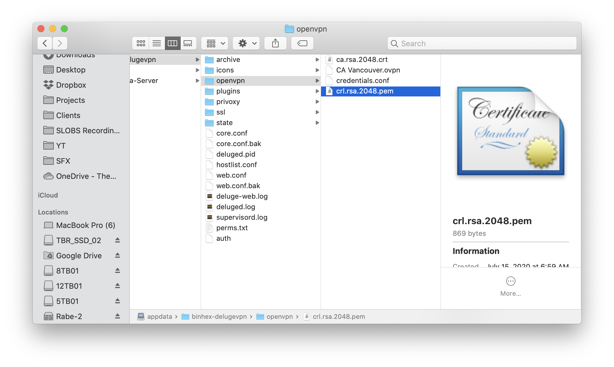

Hello -
I am trying to get Deluge VPN setup with PIA. My end goal is to be using this with Sonarr and Radarr.
I basically followed this video exactly (https://www.youtube.com/watch?v=5AEzm5y2EvM&t=309s) except that I copied over Switzerland certificate instead of Netherlands (I read in the comments Netherlands is no longer supported and checked on PIA that Switz is...)
After I copied the cert files over, in the video he is able to get right into the web GUI, but mine did not start up, I get the error:
This site can’t be reached
192.168.1.30 refused to connect.
Try:
Checking the connection
Checking the proxy and the firewall
ERR_CONNECTION_REFUSED.
Attaching logs and screenshot of appdata.
Anyone have any ideas on why this isn't working?
deluge logs.rtf

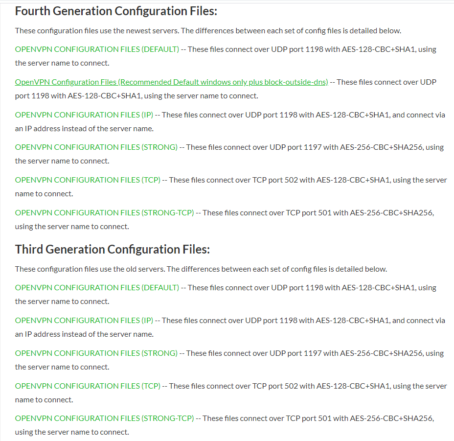

Many PIA endpoints no longer work with port forwarding. Try using CA Vancouver.

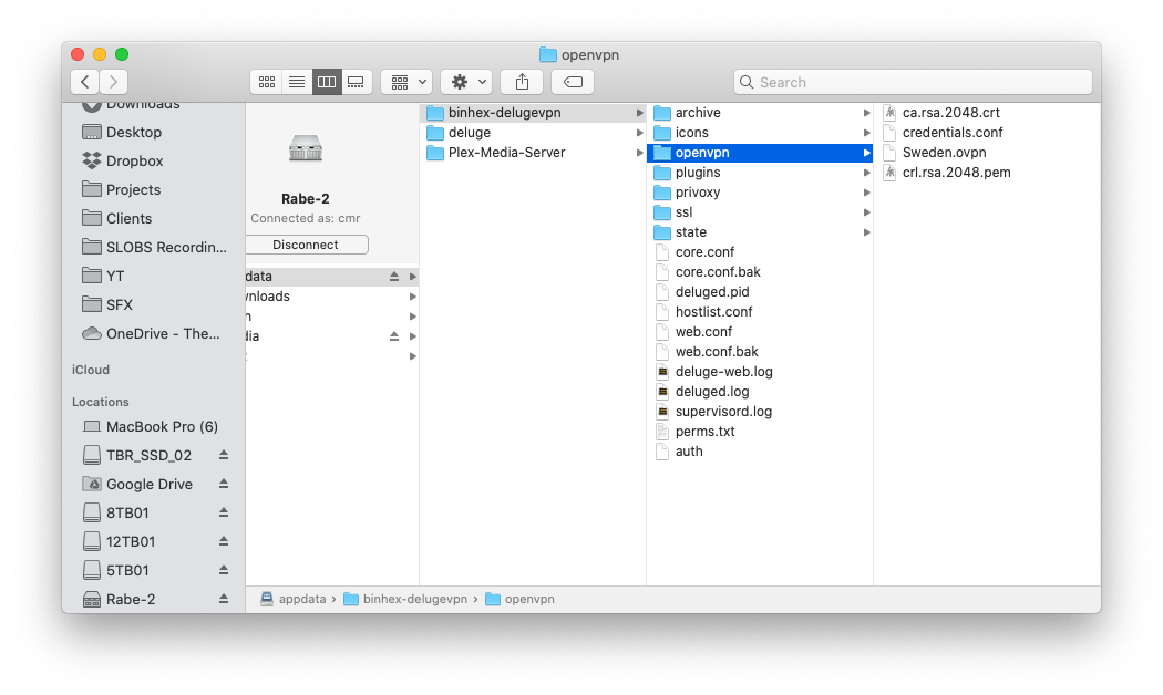

I went to PIAs site and downloaded the most recent openVPN files and tried multiple different ones that say they are supported and no luck, same error. just tried CA Vancouver, no luck.
