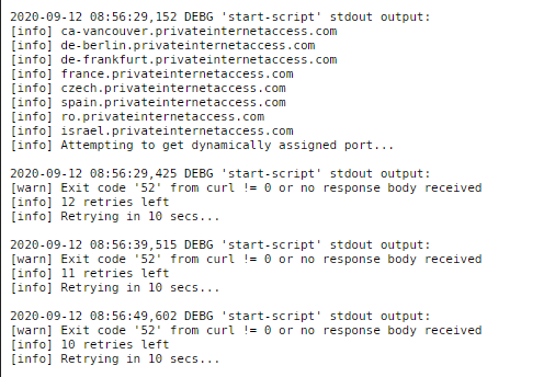

Hello,
recently I have been having trouble with delugevpn container from binhex, first I have been using this container for couple years now and it worked pretty good.  Some issues it with it being a resource hog and causing all my downloads to go into a paused state.  But  worked pretty good otherwise.  The other day I noticed I could not access the gui, so I decided to reinstall the docker container and then went into the appdata folder and noticed the only thing in the folder was a superviser log file and not the other folders and files that should be there.  Any help with this would be greatly appreciated.
Thank You

3 hours ago, slimshadey said:
Hello,
Thank You
David

I was having the same issue. Deluge for me wouldn't let me get into the webui unless it could connect properly to PIA. I think it has to establish the connection before it starts the deluge-web service. Basically, if you want to see if you're having the same issue a bunch of others are having take a look at the logs and see if you get "exit code 52" or "exit code 56." You can also just run deluge-web in the docker console and then you should be able to at least get to the webui. Also you can verify by turning off the vpn in the docker settings, and seeing if it automatically starts the deluge-web service.

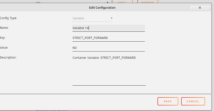

15 hours ago, NeoSys said:
Are you positive that you have
Container Variable: STRICT_PORT_FORWARD = no
I don't seem to have that variable anywhere in my config, as near as I can tell.
Assuming we're talking about on the container edit page. So I added this. Does it look correct? So far I'm not having any luck.
If I'm supposed to be setting this somewhere else, please point me in the right direction.

Mine is currently Key 6 in the config screen with a container variable: STRICT_PORT_FORWARD, but it is not a drop down selection. you have to actually type in the setting (yes or no). Don't know enough to know whether or not the Variable name needs to be the same, but mine is Variable name: Key 6.

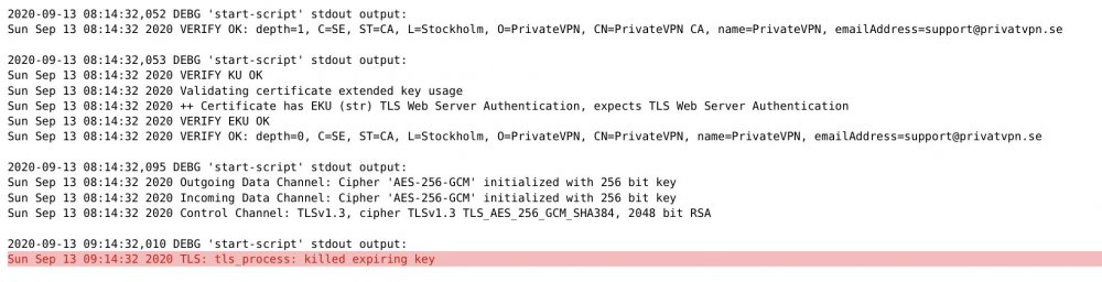

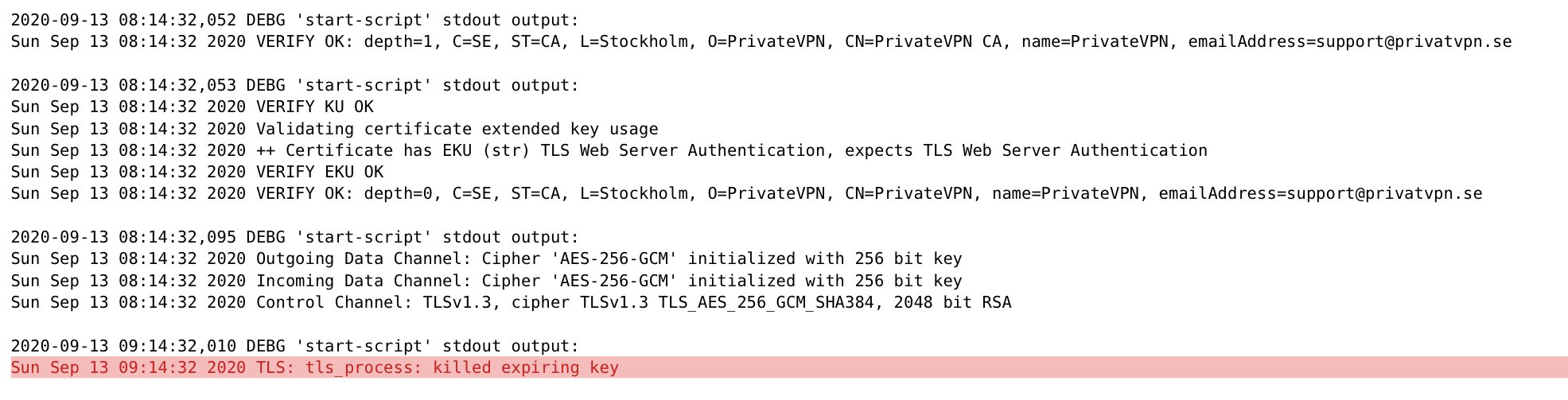

So, I’ve been having some issues with the docker suddenly going unreachable lately. Sonarr/Radarr will give me a warning that they can’t reach deluge, and at that point I can reach the WebUI, type my password and they I just get a blank UI(as if I had no torrents). If I restart the docker it works fine again. This is what I found in my logs this morning(it keeps repeating this once every hour):
