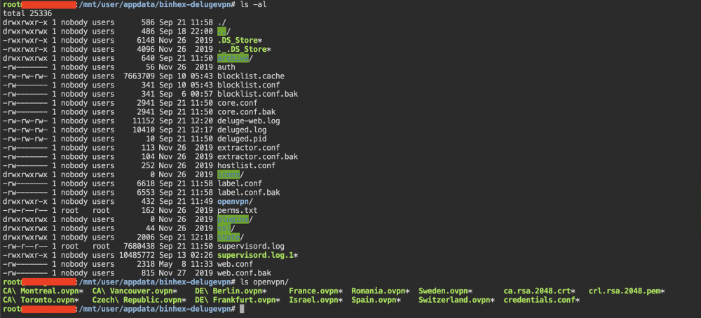

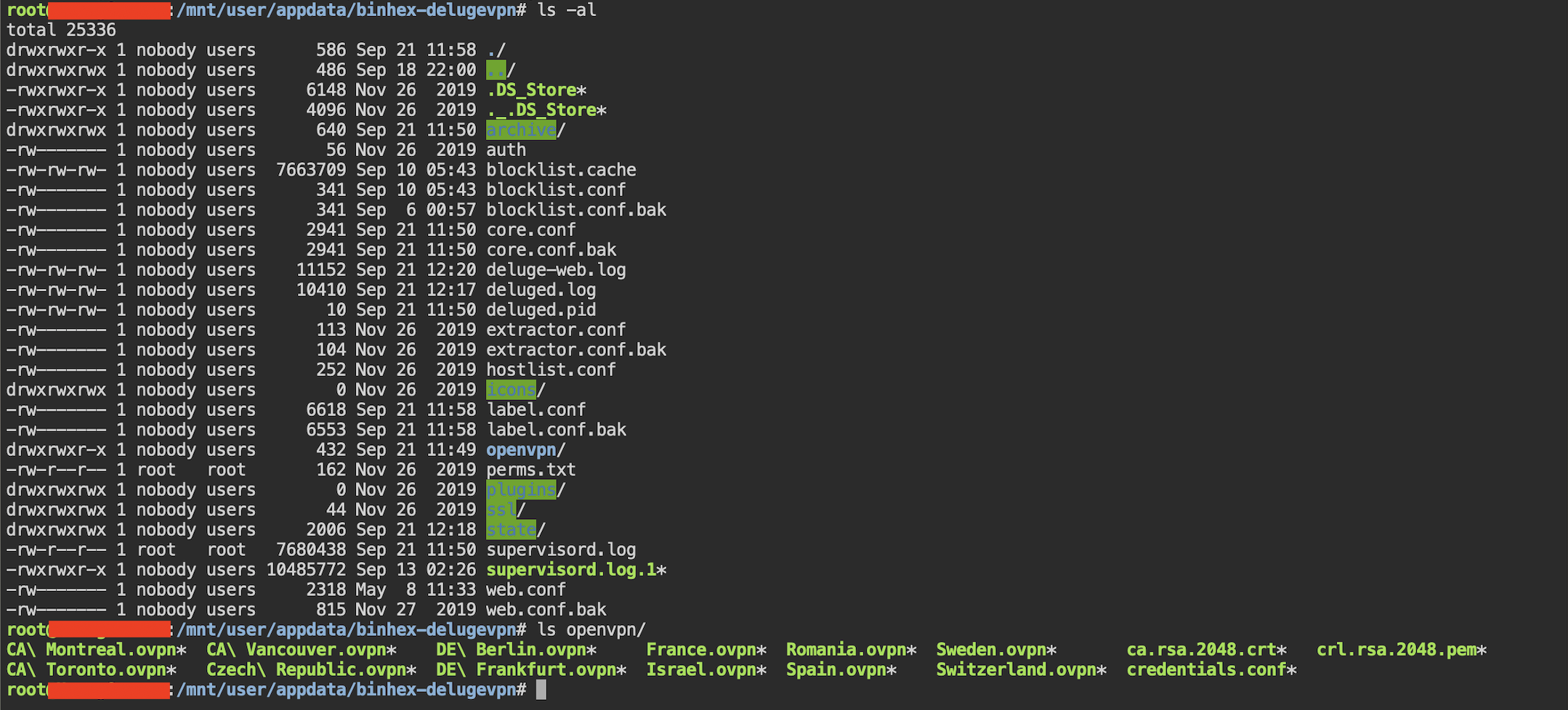

I've gotta be completely missing something... Where is the openvpn config file? Am I modifying for each location.ovpn?
Attaching an image of my dir for /config. This was setup per SpaceInvader's video.

31 minutes ago, Zervun said:
Done and attached - could it be something to do with the fact that I have remote as IP addresses and not names? I read that it does an nslookup on all remote
I tried with IP and same issue.
