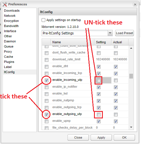

5 hours ago, wgstarks said:
Try manually moving the egg file to the plugins folder and restarting the docker.
Yeeessssssssssss thank you so much, this did the trick!
This is my go-to method for installing plugins. I don’t usually bother trying to install via the gui.

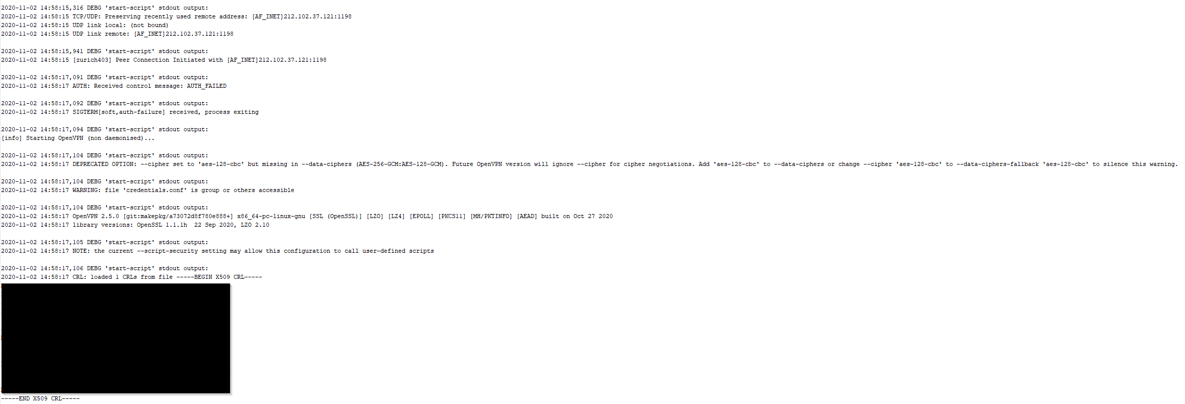

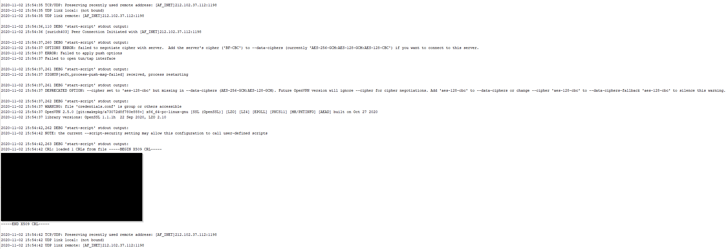

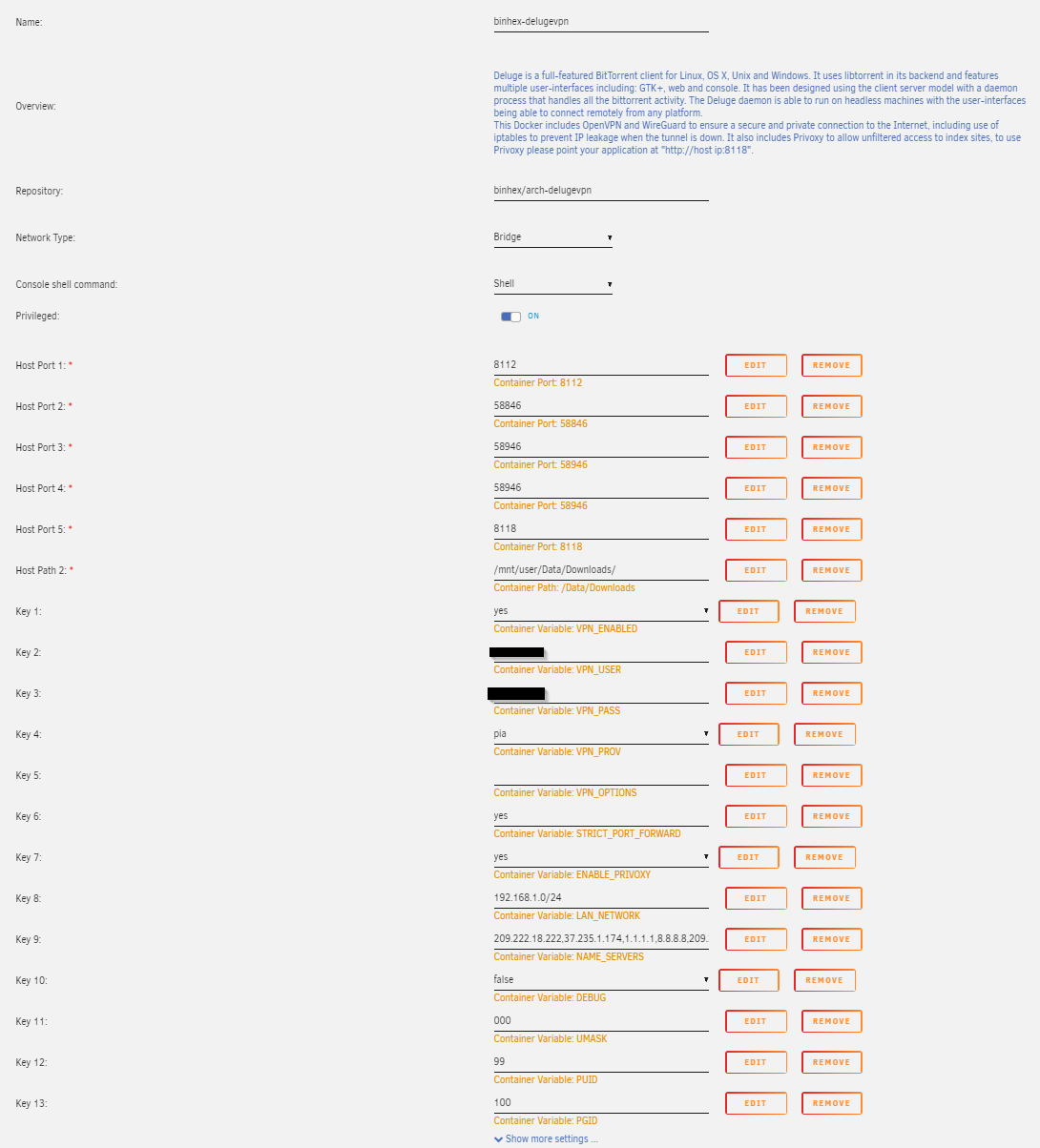

Hello.  As of last update I am no longer able to access WebGUI.  Been using this app for years with no issues.  Did anything change?

2020-11-01 23:18:17,493 DEBG 'start-script' stdout output:
Sun Nov 1 23:18:17 2020 [UNDEF] Inactivity timeout (--ping-restart), restarting
Sun Nov 1 23:18:17 2020 SIGHUP[soft,ping-restart] received, process restarting
Sun Nov 1 23:18:17 2020 WARNING: file 'credentials.conf' is group or others accessible
Sun Nov 1 23:18:17 2020 OpenVPN 2.4.9 [git:makepkg/9b0dafca6c50b8bb+] x86_64-pc-linux-gnu [SSL (OpenSSL)] [LZO] [LZ4] [EPOLL] [PKCS11] [MH/PKTINFO] [AEAD] built on Apr 20 2020
Sun Nov 1 23:18:17 2020 library versions: OpenSSL 1.1.1h 22 Sep 2020, LZO 2.10
2020-11-01 23:18:22,494 DEBG 'start-script' stdout output:
Sun Nov 1 23:18:22 2020 NOTE: the current --script-security setting may allow this configuration to call user-defined scripts
Sun Nov 1 23:18:22 2020 CRL: loaded 1 CRLs from file crl.rsa.2048.pem
Sun Nov 1 23:18:22 2020 TCP/UDP: Preserving recently used remote address: [AF_INET]212.102.39.1:1198
Sun Nov 1 23:18:22 2020 UDP link local: (not bound)
Sun Nov 1 23:18:22 2020 UDP link remote: [AF_INET]212.102.39.1:1198
2020-11-01 23:19:22,986 DEBG 'start-script' stdout output:
Sun Nov 1 23:19:22 2020 [UNDEF] Inactivity timeout (--ping-restart), restarting
Sun Nov 1 23:19:22 2020 SIGHUP[soft,ping-restart] received, process restarting
Sun Nov 1 23:19:22 2020 WARNING: file 'credentials.conf' is group or others accessible
Sun Nov 1 23:19:22 2020 OpenVPN 2.4.9 [git:makepkg/9b0dafca6c50b8bb+] x86_64-pc-linux-gnu [SSL (OpenSSL)] [LZO] [LZ4] [EPOLL] [PKCS11] [MH/PKTINFO] [AEAD] built on Apr 20 2020
Sun Nov 1 23:19:22 2020 library versions: OpenSSL 1.1.1h 22 Sep 2020, LZO 2.10
2020-11-01 23:19:27,987 DEBG 'start-script' stdout output:
Sun Nov 1 23:19:27 2020 NOTE: the current --script-security setting may allow this configuration to call user-defined scripts
Sun Nov 1 23:19:27 2020 CRL: loaded 1 CRLs from file crl.rsa.2048.pem
Sun Nov 1 23:19:27 2020 TCP/UDP: Preserving recently used remote address: [AF_INET]212.102.39.1:1198
Sun Nov 1 23:19:27 2020 UDP link local: (not bound)
Sun Nov 1 23:19:27 2020 UDP link remote: [AF_INET]212.102.39.1:1198

Hi there - so I just tried updating to the next gen servers (following the answer to Q19), but I seem to be having issues. This is what the log says when I try to start the docker container:
This is what the docker container settings look like:
And this is what the openvpn folder looks like (the certs and .opvn files where extracted from the nextgen zip link):
Any ideas on what I'm doing wrong?
another auth failure, see Q16:- https://github.com/binhex/documentation/blob/master/docker/faq/vpn.md

Huh, so I tried replacing the cipher line with the new one, but same error. "Failed to negotiate cipher."
And I tried making this edit in the Switzerland.ovpn and Spain.opvn files - both to no avail. (And I made sure only one .opvn file was in the openvpn folder at a time).
