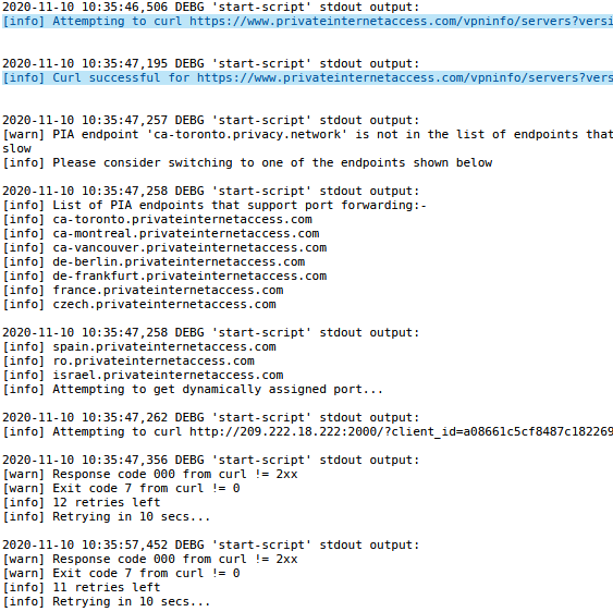

ive updated to the current delugevpn yet supervisord still showing the old addresses even when im using the nextgen zip.  whats going on here?  I even deleted the openvpn folder all together and copied over the openvpn folder from my binhex-rutorrentvpn set up that is confirmed working and confirmed shows the privacy.net servers when this screen is displayed as a tester.  do i need to just uninstall deluge and reinstall at this point to shake out the bugs?  is this somehow cached data?
EDIT:  Yes I had to remove the old client completely as simply updating the repository pull did not update the newer template.  Seems to be working now that I uninstalled and reinstalled.
Edited by DontWorryScro
18 minutes ago, strike said:
This is correct. But why can't you install to 2.0.4? Do you need 1.3.15 for a specific reason?
I'm on winblows, as far as I can tell 1.3.15 is the latest version available.
Try to do a force update
Are you sure you're on the latest version of Deluge? privacy.network servers only work w/ the latest
Edit: your repository tag should say: binhex/arch-delugevpn  Make sure that is set and then do a force update
