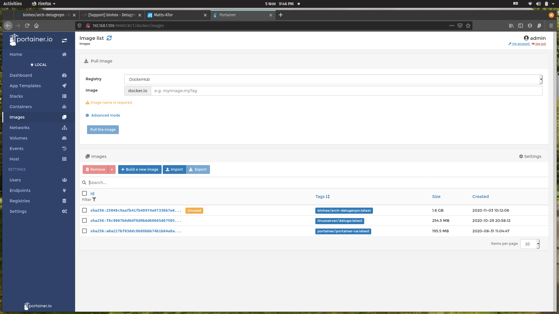

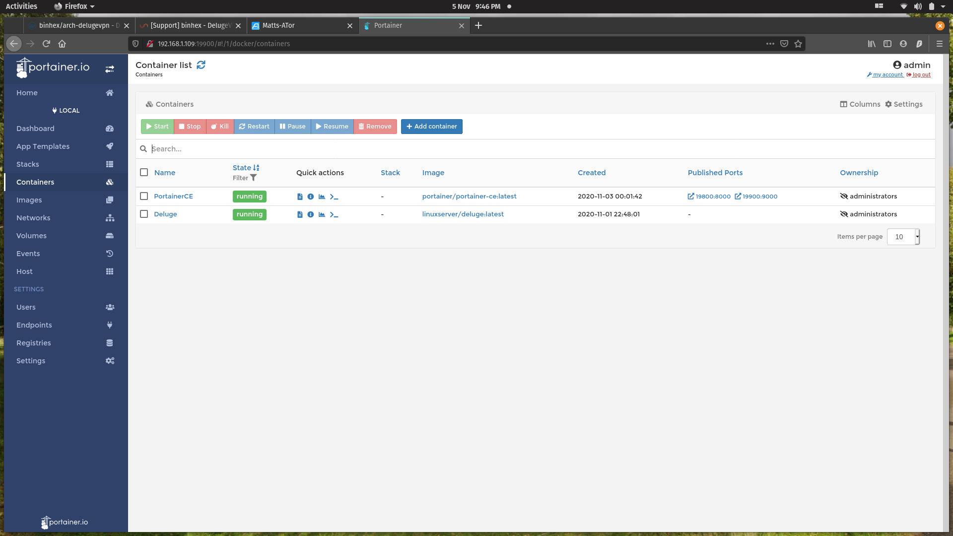

these are screenshots of portainers.io i made when ssh to my nas from my laptop on the same LAN.
looking back at the screenshots i can not find how you concluded it is on my cache drive though (understanding this would probably be very helpfull not?)
did you find it back in the "containers" or the " images" screenshot?
kind regards.

The screenshot shows that you have set /config to host path /mnt/cache/appdata/delugeVPN. This would mean that the docker has created a folder named delugeVPN at location cache/appdata/. The path to your OpenVPN folder would be /mnt/cache/appdata/delugeVPN/openvpn/ on an UnRAID system. Not sure how portainer accesses your drives.
@ Walter
ah that screenshot, no that is a screenshot posted as an example by Chesh on page 291, as that is where it is located on his system.
that is what i am tring to find on my system.
i did post 2 screen shots though.. a little bit further on, also on page 291 but i will post them here again. but i doubt this gives any information except a possible tab inside portainer the info should be.
sorry for the confusion, i should've been more clear.
That is the LSIO deluge container. Since I’m guessing you aren’t running it on an UnRAID server (and this is an UnRAID forum) you should seek support in the LSIO discord. This thread is for a different container.

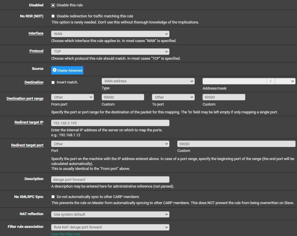

I installed binhex-delugevpn 5 months ago to help remedy my uTorrent difficulties. Deluge has been great, but I'm not sure the port forwarding was setup correctly.
grc.com is how I test my local machine for open ports, and it shows as OPEN! when testing the port I have set for uTorrent. The port for deluge daemon is open, when tested using grc.
I've followed a few different tutorials for setting up Port Forward rules in pfsense. None have worked for Deluge obviously. The rule for uTorrent is working just fine and the options for deluge are the same. WAN, TCP, Other, etc.
Redirect target IP is the IP of the server where deluge is running.
Can someone ask the correct questions to help me get this figured out?
