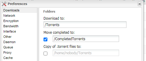

Hello,
Just about done installing my new UnRaid server and have several containers running well. The one that is tripping me up is Binhex Deluge VPN. I have everything configured correctly - NordVPN is working, files are downloading when triggered by Sonarr and Radarr but the issue is when the download finishes in Deluge.
As torrents are downloading they are going to an "incomplete folder" but once the torrent completes downloading it goes into a "queued 100%" state and the completed file stays in "incomplete" and does not move to "completed" or to the assigned folder I have for files tagged with Sonarr and Radar Labels. I can manually move the file from incomplete to the desired directory via Krusader and it is in fact complete, but something is not right that it is "queued 100%" in Deluge and just sits in "incomplete". I've searched exensively on this topic and see others have had this issue, but a solution did not emerge and I am stumped.
Some things I have tried:
-Reinstalling container and wiping app data
-Setting parameters not to seed/upload
-Ensuring folder paths are correct in the WebUI for complete files and for the Sonarr and Radarr labels
I figure it has to be something simple. Hopefully there are some ideas here. Thanks in advance.

8 minutes ago, SelfHoster said:
Hello,
it COULD be a mismatched downloads folder, see Q4:- https://github.com/binhex/documentation/blob/master/docker/faq/unraid.md
13 minutes ago, SelfHoster said:
Hello,
Do you have this option set to move completed?
Yes, I have this option selected, as well as in the label plugin for labeled torrents to move to certain folders based on label (i.e TV for Sonarr, Movies for Radarr)
I’ve never needed special TV/Movies folders but did need to also set the proper tags in Sonarr/Radarr settings. Without the tags it was hit and miss.
A mismatched downloads folder appears to have been the issue. The github article was extremely helpful in sorting this out and also understanding host and container settings. I had to align the host and container paths in Deluge, Sonarr and Radarr in the docker settings. I tested two torrents and once completed they changed to "100% - Seeding" status and moved to the Completed folder. I also setup a label in Deluge to move Sonarr to the TV folder and Radarr to the Movie folder which also occured. So the Deluge setup is finally working correctly!
The only issue that remains is that Sonarr and Radarr are not renaming and moving the files to the correct show and season folders after they are moved into the TV folder or Movie folder respectively. The folder as downloaded by Deluge remains as is. I'll have to check my settings there.
