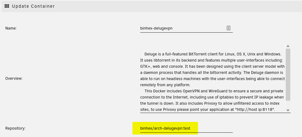

please can you try the 'test' tagged image, let me know if it fixes it.
40 minutes ago, DigitalDivide said:
HOw does one roll back to the last known working version?
Using tags.
After the repository name type a colon and then the tag for the version you want to install. You can get previous versions here.
are there any instructions on how to do this? I have no idea about tags. Do I do this on the command line?
You just edit the repository setting in the docker configuration. Type a colon and then the version number after the name.

imminent fix for protocol issue for non pia vpn providers, the image is just building, please pull down latest in approx 30 mins from now.
Works for me.  Thank you.
Ok, managed to get the "test" one installed and it resolved my issue.
