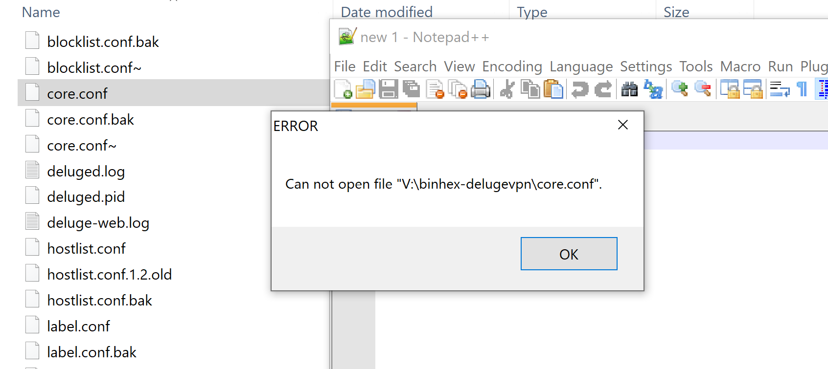

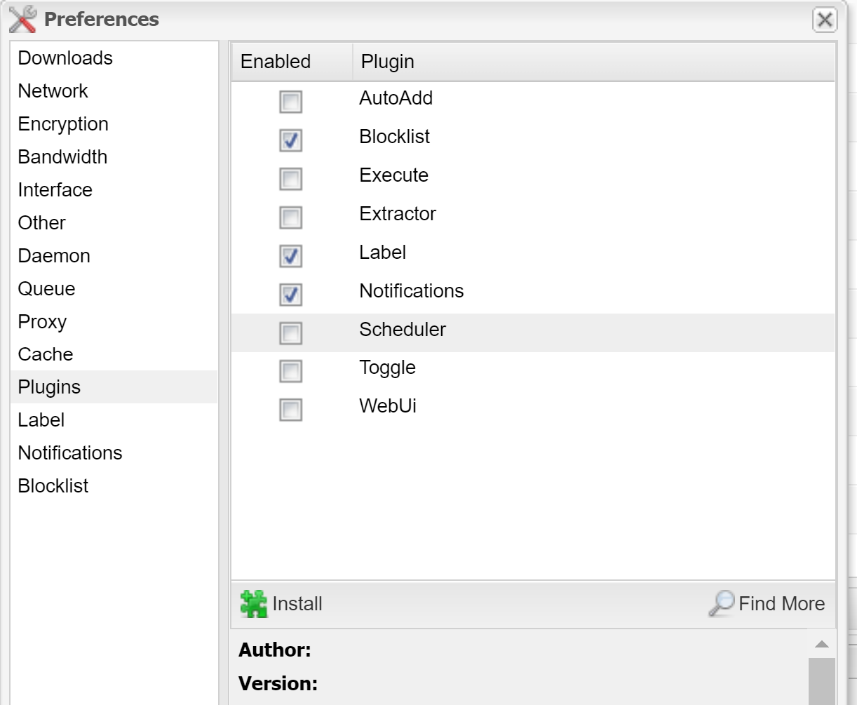

The Repository field was already set to that.  Did the check for updates and there was one available.  That did the trick, now I feel amazingly stupid for not checking that lol.  That for the help, now to try and figure out how to get auto remove installed again.  It disappeared and doesn't seem to want to install again
1 hour ago, binhex said:
The egg file is in the plugins folder, it was working before I updated deluge.  I downloaded a fresh copy and a previous version and tried both (not at the same time obviously), it's not showing in the plugins settings.  Tried both AutoRemovePlus-0.6.1-py2.7 and AutoRemovePlus-0.6.1-py2.6, should be the correct versions for Deluge 2.x+.  Concerning Q4, That file will not open with notepad++ even with the container stopped, however this is not the issue I' m having but I figured I would take a look.
The current updated version of the plugin is 0.6.6. Different branch.
https://github.com/springjools/deluge-autoremoveplus/releases/tag/0.6.6
I've also noticed that trying to open core.conf and some of the other appdata files results in permissions errors.
