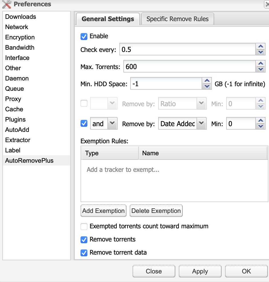

Any idea why AutoRemove is not removing the oldest torrents? I have no exemptions, but still my oldest torrents are still there.
