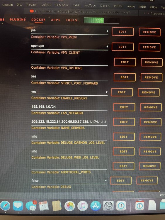

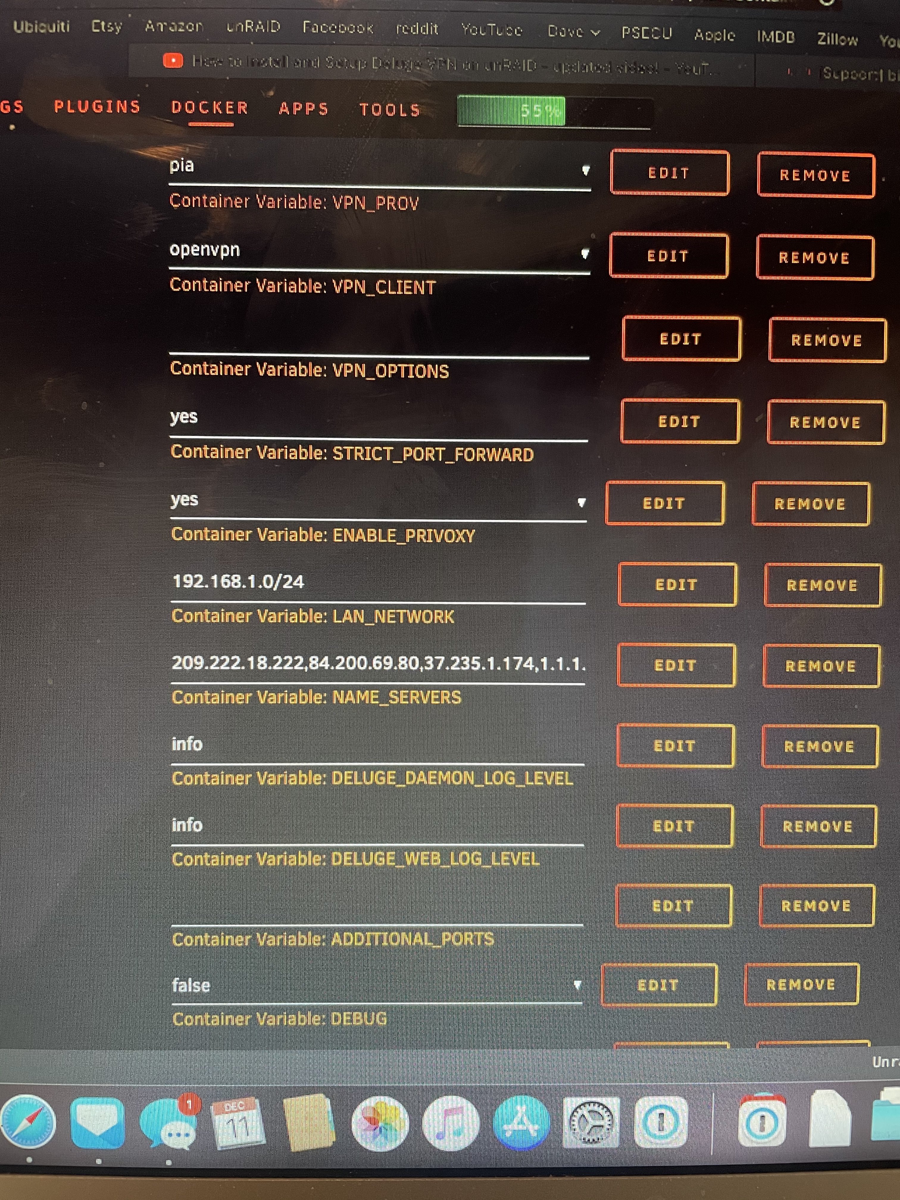

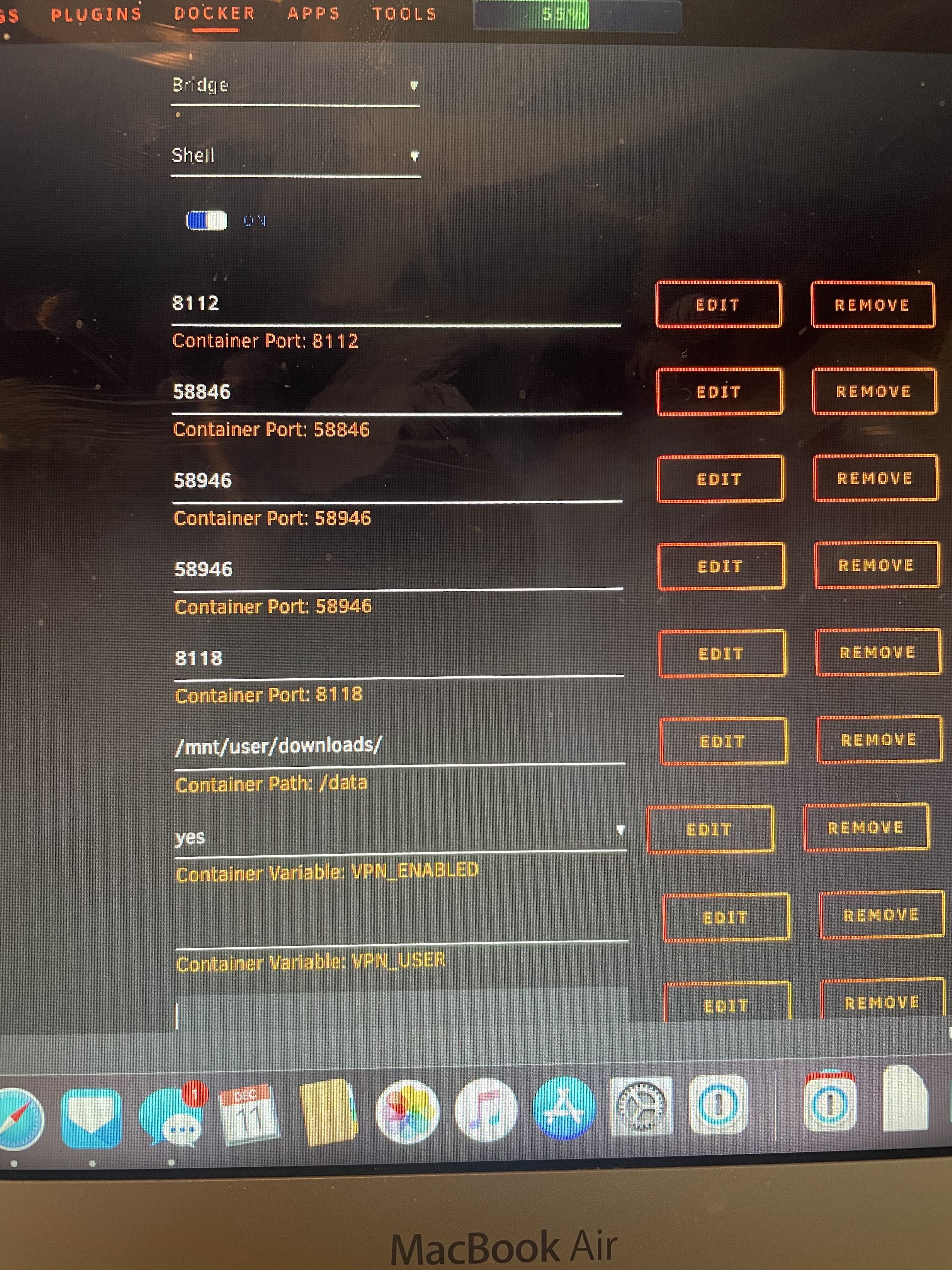

I got everything setup but I can't get into the webui.  Even tried it with PIA.  I followed SpaceInvaders Video. Settings attached.  I used my PIA user name and PW but deleted it for obvious reasons.  I copied the openvpn file and the crt and pem file to the folder also
Edited by squirrellydw
wrong pic
@binhex  attached is the log file
10 minutes ago, squirrellydw said:
If you’re using strict port forwarding you need to connect to an end point that supports port forwarding. See the list in the log. You should also change your user name and password. They are contained in the log.
turned that off and changed my info but still not working
new log please, same procedure.
