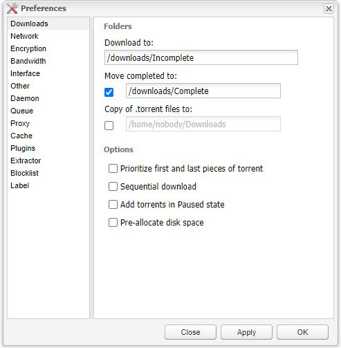

Does anyone else have any suggestions for my downloads not working? I've switched over to wireguard with no change in results. I haven't done qbittorrent because I don't quite understand what that does or how it might fix the issue. I see other people with this problem but can't seem to find a fix.
Post your docker run command (remove user/pw) and a screenshot of the download settings in deluge.

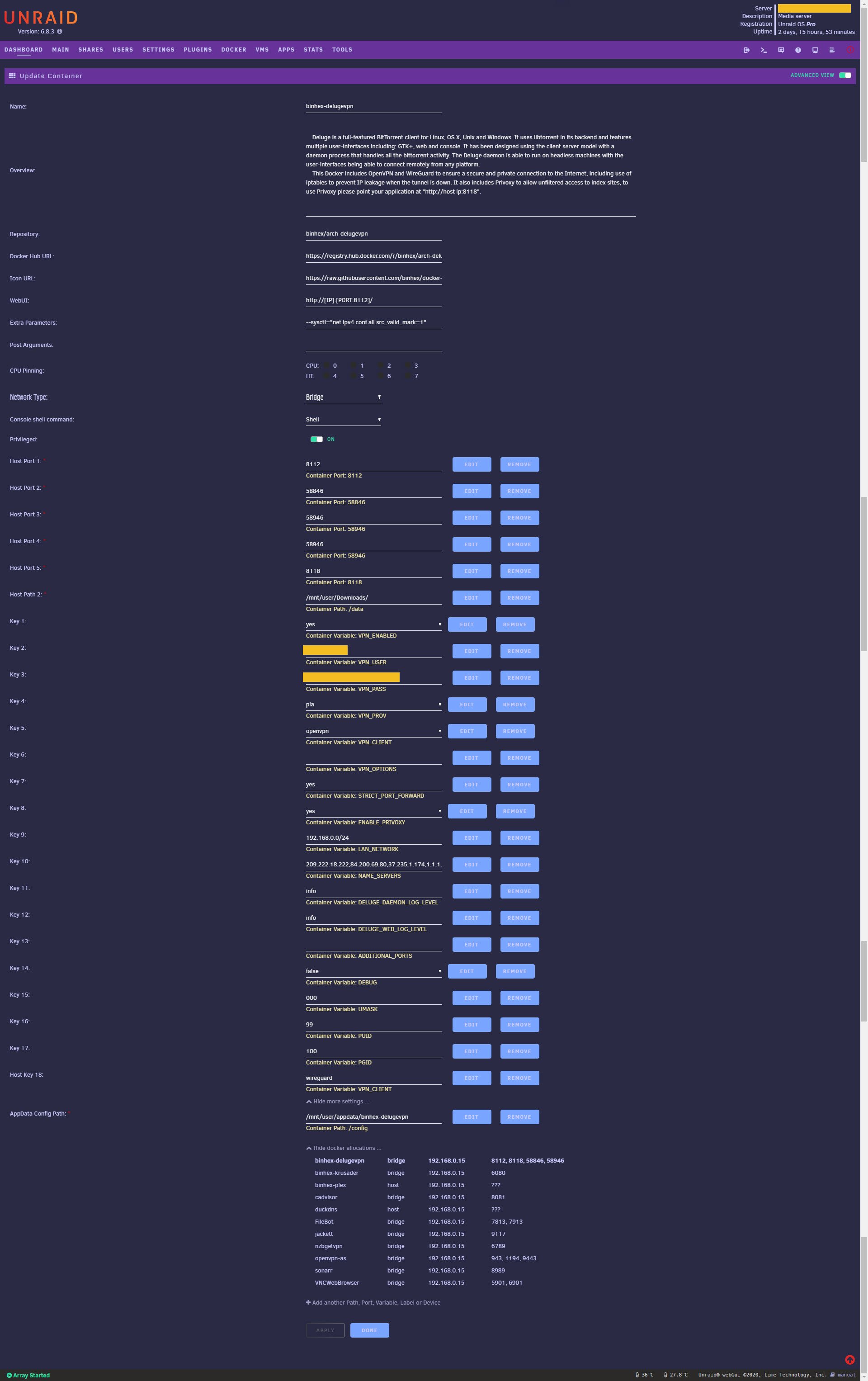

I use the gui interface, so I don't use a run command. Here's a the log and a screenshot of my advanced settings and redacted log.
535479764_Delugedocker2.thumb.jpg.01be3bc73556565165d17e2bcc4bf419.jpgsupervisord_redacted.log
You forgot to post a screenshot of your deluge download settings, I need to see that too please.

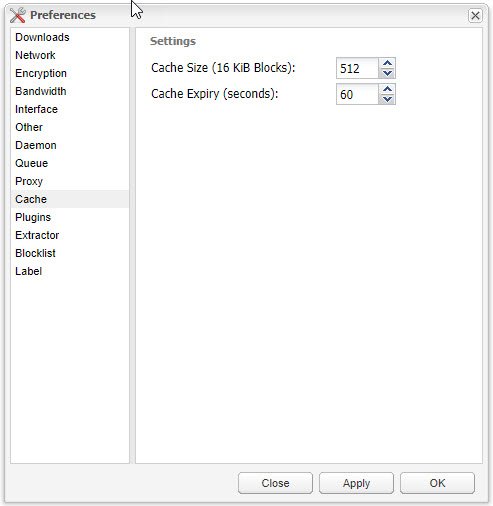

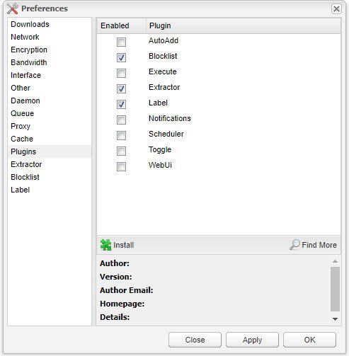

Oops! Sorry about that. Here are all the preferences from inside Deluge.
465052220_Delugepreferences13.jpg.b1f69384c16d3a938d59f6c610c2b9fd.jpg1145485229_Delugepreferences12.jpg.80c242f7fb33427a4008b31ec3ada704.jpg668361713_Delugepreferences11.jpg.4191cf77df56782ff1d0240e5e8bef17.jpg961960573_Delugepreferences10.jpg.92163341e9270981bf4a00744660ccf0.jpg586475558_Delugepreferences9.jpg.a1167cb6070cc7effc7ff10fcba47ac8.jpg1585281475_Delugepreferences8.jpg.1e1e3c02613772ddf6ebc0ea9d0c5dc7.jpg1070297557_Delugepreferences7.jpg.80645c6e8b04cc9ec5feb1916989aa4f.jpg370938415_Delugepreferences6.jpg.b922cc15086de1f55dd88e594fa4a6c7.jpg2044267217_Delugepreferences5.jpg.0cb4888db8e56a7fc60263f191ab1496.jpg2143837382_Delugepreferences4.jpg.b28c0737682cada9dc5d66aa510c709c.jpg1343398272_Delugepreferences3.jpg.5dd2e3b7b3f16d2ad5084f099efcc13d.jpg1227489773_Delugepreferences2.jpg.775b593c87c67317f5c3324f685ad560.jpg544440071_Delugepreferences1.jpg.39bf84c99f3af33ca292c401825b9992.jpg292674871_Delugepreferences14.jpg.bb11ff7321618d2729554776f4eea8c8.jpg
I only needed the downloads section, but yeah your Download to path is incorrect. Change it to /data/Downloads/Incomplete and you should be good. Change the "move completed" path too. Restart the container after. And linux is case sensetive so be sure to use Downloads and not downloads. Since you have mapped /data to /mnt/user/Downloads.
Sorry, it should be: /data/Incomplete and /data/Complete
Edited by strike
OMG! That's it!!! Thank you so much!!!
Glad I could help. :) And if you have created any labels make sure you set up the correct path there too in the label options.
