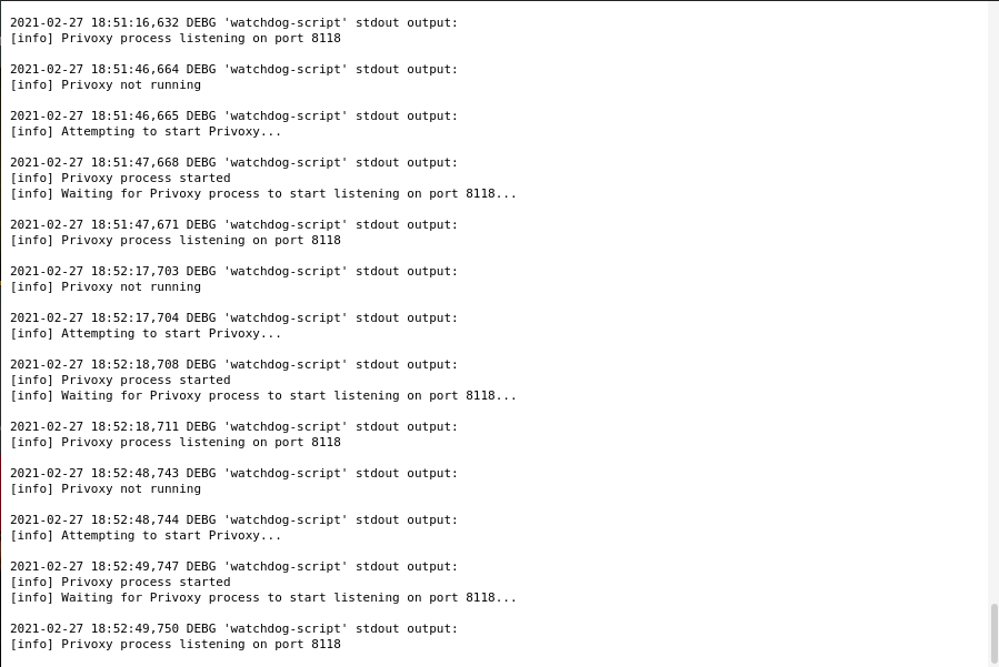

4 hours ago, storagehound said:
Looking at my logs I am seeing this as well.
2021-02-26 18:45:14,261 DEBG 'watchdog-script' stdout output:
[info] Attempting to start Privoxy...
2021-02-26 18:45:15,272 DEBG 'watchdog-script' stdout output:
[info] Privoxy process started
[info] Waiting for Privoxy process to start listening on port 8118...
2021-02-26 18:45:15,278 DEBG 'watchdog-script' stdout output:
[info] Privoxy process listening on port 8118
2021-02-26 18:45:45,335 DEBG 'watchdog-script' stdout output:
[info] Privoxy not running
I see the same in my logs and I am setup to use the privoxy in Deluge, with Radarr/Sonarr/Jackett all setup to use it.  I am assuming they are using it but I don't know of a way to test if they are actually using it.  I think Jackett is the only container that truely is going outside my network as Radarr and Sonarr I think just connect within my network.

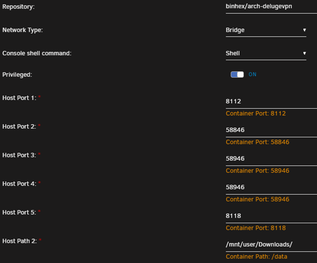

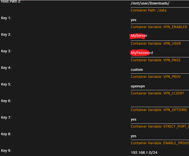

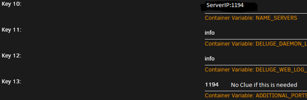

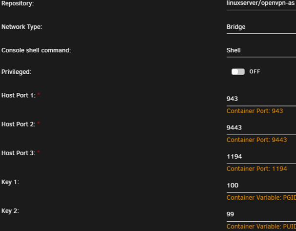

Hello,
I've been trolling this forum and googling my brains out (YT included) for 3 days now and i can't seem to find out how to get devulgevpn working with my VPN.
Disclaimer - 6 days into my unraid trial and same for Docker...I've managed to get rid of my Buffalo NAS, moved my plexserver and my PiVPN to Unraid.
I'm struggling to figure out how to point DevulgeVPN through my openVPN server (container on UnRaid now). I created the OpenVPN-as server then tested it with my laptop to make sure it works. (it does)
I then a setup my UnRaid IP:1194 in the DelugeVPN server name field. (NAME_SERVERS) Dropped the .ovpn file into the appdata ovpn folder.  Can someone point my in the right direction?
OpenVPN-as config:
DelugeCPN Config:
Running: UnRaid 6.8.3
Edited by Jayg37

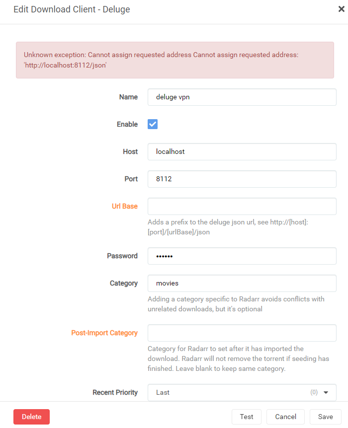

I am sorry to say that I am i am in the same boot and I am very confused.
like many other people I have the suite of of dockers form Binhex and where I have linked them together to for VPN access
I have my Sonnar, Radarr and Jackett all pointing to my DelugeVPN
I have read the instructors and I have added the following information into deluge.
Container running VPN
Left click icon and 'Edit' container and toggle advanced view (top right).
Click on 'Add another Path, Port, Variable, Label or Device' and add in a 'config type' of 'port'.
Enter in Web UI port for 'container port' and any non conflicting port number for 'Host Port' (host port must not be used by another container).
Edit 'ADDITIONAL_PORTS' env var and put Web UI port number in value, if multiple ports required then use a comma to separate.
Click on 'Apply'."   didn't need to do this as this ADDITIONAL_PORTS was all ready there and all I did was add the port's
as a test I then when into Jackett and change the IP address to Localhost and I got the following error
which happens on all of my indexers
and here is my settings for jackett
so I would like to know is where are we all going wrong ?
PS. I am also using Jdownloader and this is working fine, as this also points to delugeVPN
Edited by chris_netsmart
55 minutes ago, Jayg37 said:
Hello,
I think you misunderstand. This docker is for use with vpn providers such as Private Internet Access. You don’t need to run it through a self hosted vpn. You just need an account with a supported provider.

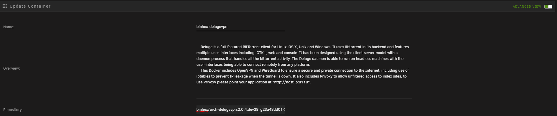

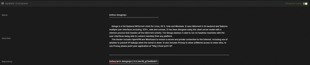

Is it possible to roll back the docker image install on my setup? I tried removing the current install and re-installing a different docker from another repo and the whitelist message is still happening but I'm betting they're in the same downstream
Yes. Just add a dash and the release number after the name in the repository field in the container settings. Releases can be found here- https://github.com/binhex/arch-delugevpn/releases
FYI- I don’t believe that there have been any changes to the app recently, just the container.
I tried putting -2.0.4.dev38+g23a48dd01-3-01 at the end of the "repository" field and the "docker" field but it wont pull at all if I do that.
It must be look like this picture

On 2/25/2021 at 9:38 PM, binhex said:
can you screenshot the config in sonarr for the 'download client'
edit - just checked this by routing sonarr through rtorrentvpn (should be the same as delugevpn) and after setting the sonarr download client settings correctly it tests fine, see screenshot below for my config, note the host should be localhost (on the same network) and port should be the container side port for the web ui or api:-
Im having problems with binhex-radarr connection to binhex-delugevpn for downloads.
binhex-sonarr with setup like this is working:
@binhex any clues where i should start checking?
Edited by orlando500
you screenshot shows you using 'localhost' for radarr, are you sure you are binding the radarr containers network to delugevpn?, or are you using privoxy?
Nah i dont have not done any special bindings. Just read that you had to put localhost there after the update. Before that i had the ip of the server 192.168.10.20 as i have in sonarr. But radarr didnt work so tried localhost. But same result.
