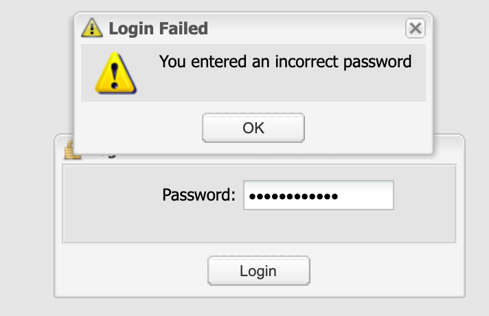

Hello since the last Unraid update.
I have an password error on webUI.
How is possible ?? My password is correct.
I use Bitwarden for this.
How change admin password without web UI?
(sorry for my english)
Have you tried the default password incase it reset in the update? deluge is the default
