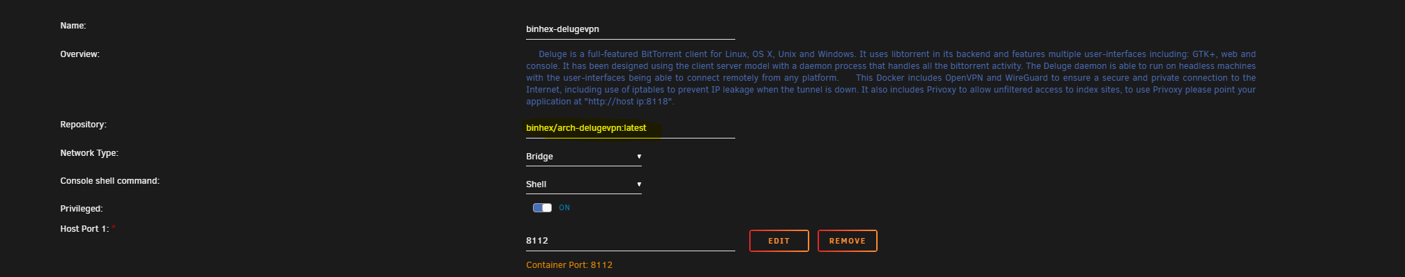

15 hours ago, TrueImpulse said:
For me it was simply adding " :latest " to the end of the repository line. I'm also using wireguard/pia connecting to Toronto.image.thumb.png.bba8006d24ad97d2d350d0436f681246.png

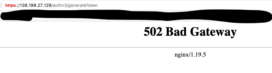

had more of a in depth look into this this morning and i can confirm if i switch to netherlands i am seeing 503 gateway failures on PIA side, but its intermittent, i restarted the container and it started fine, so i am happy that no changes to the API have happened, its just PIA being a bit shit, hopefully they will get it sorted, god PIA can really be a Pain In the Arse sometimes.

My Solution: I set the container to "Privileged Mode" and it started working.
20 minutes ago, nikizm said:
Hi Guys,
I just possibly found a fix for the:
"Unable to successfully download PIA json to generate token from URL 'https://10.0.0.1/authv3/generateToken"  Issue that multiple people reported above.
aka: "DEBG 'start-script' stderr output: parse error: Invalid numeric literal at line 7, column 0"
dont do this its a coincidence, pia is having intermittent issues on some of their endpoints, you just happened to catch pia endpoint working, nothing to do with privileged mode.

@binhex
According to the scripts included in PIAs documentation on manually getting a port, tokens should be generated by sending the POST request to https://privateinternetaccess.com/gtoken/generateToken, rather than 10.0.0.1. Would updating the arch-int-vpn layer to use that URL fix the issue people have been having today where certain PIA endpoints are not generating tokens?
Unfortunately I don't know enough about docker to figure out how to hijack & modify the vpn layer and test it myself.
Currently waiting on PIA to get their shit together....
