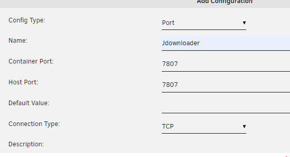

I have my Sonarr, Jacket, and Radarr all going through delugevpn with no issues, using the new method.
but I have been trying to get my JDownloader to go through the delugeVPN, but to no joy as I am using the same procedure I used for the other dockers.
by placing the ports within deluge and adding the Extra Parameters but when I fire up the docker I am getting the ' New page can be found '
Is there anything in the JDownloader log about not starting? Can you show the docker settings?
I have gotten to start again, but uninstalling it and reinstalling it  but I am still now able to webGUI onto it

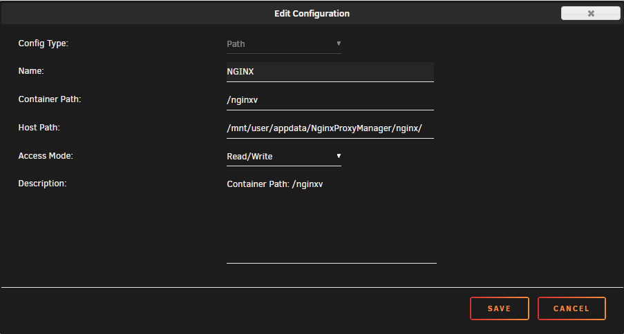

Having used a few NGINX based reverse proxies, NGINX Proxy Manager is the best by far.
Its clean GUI allows for easier management of hosts and is better if your new to the platform.
However, since its based on GUI and not nitty gritty config files it can make getting troublesome dockers to work.
I struggled to get Deluge working and had little issues with the 10+ other dockers.
Now that I have it working I would like to share the solution.
NGINX Proxy Manager:
If you use the default location settings for most apps its will work fine but for Deluge you will get.
Now you might be inclined to Google your way to the correct custom settings that you can input per location but it will be a long road to nowhere as your actually missing a needed configuration file.
This file is not included with NGINX PM and without it Deluge will not work.
To fix this follow the steps precisely:
1. Create a new location for Deluge. If you have one already, delete it and start new.
2. Set the following settings:
  • location: /deluge
  • scheme: http
  • forward hostname / IP: IP address to your docker + trailing slash i.e. 172.16.0.2/
  • forward port: 8112 (unless you have changed the default port)
You must have the trailing slash or it will not work.
You should avoid manually adjusting the .conf file in app folder because NGINX will replace that file if you modify locations via GUI.
3. Now we add the needed config file, I have attached this to the post. proxy-control.conf
Using UNRAID console with root access, copy the file to the app directory.
i.e. cp /location/proxy-control.conf <to the destination> /mnt/user/appdata/NginxProxyManager/nginx
Use ls /app/location to confirm its there.
4. Create a custom path to your location within docket template.
i.e.
Or use the built in app location from template /config
5. Now we add the advance settings needed which includes injecting that config file.
In the deluge location click the cog icon to get to the advance settings.
This is the example settings provided by Deluge wiki:
proxy_pass http://localhost:8112/;
proxy_set_header X-Deluge-Base "/deluge/";
include proxy-control.conf;
add_header X-Frame-Options SAMEORIGIN;
However that's assumed for configuration based NGIX instances and PM is GUI based, we need to tweak it to:
include /docker/variable/path/proxy-control.conf;
Remember to change the "include /docker/variable/path/proxy-control.conf;" to your docker variable path
i.e. /config/nginx/proxy-control.conf;
Or using your custom set variable path
6. Click the save and we should be done.
NGINX does not inject config files until reboot so reboot the container.
Follow the logs and confirm there are no errors, if you encounter one it would will be an issue loading the config file and you will need to check the following to resolve:
  • Check your steps for something missed
  • Confirm your variable is working using the dockers console to list the file
  • Ensure the permissions are such the docker has access. i.e. 775
7. Now if you go to https://domain.com/deluge you should get to your docker.
Hope this helps 🙂
proxy-control.conf
Edited by ados
Errors
