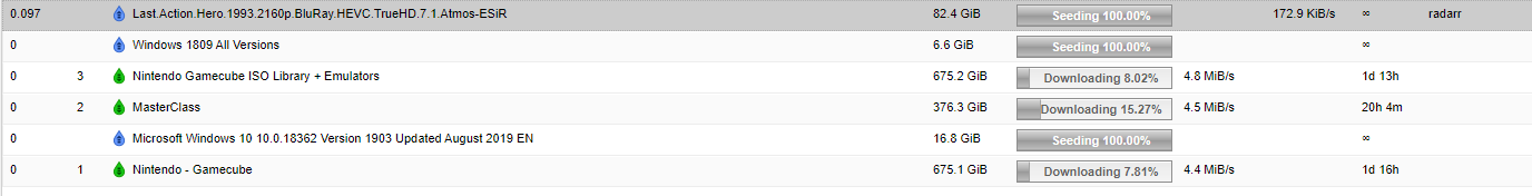

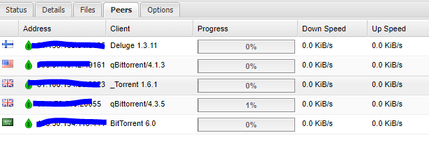

On 5/17/2021 at 12:45 PM, Remamian said:
To add, the torrents DO show peers connecting, just no bandwidth being used.
Reloaded all the PIA credentials, same thing. I did notice a behavior i had not witnessed before. That top torrent is seeding just fine right now, no issues, but the rest of them do not. I deleted all of those other ones and i am re-downloading but still wont seed
The below info is for Windows 1809 All Versions. As you can see lots of connections but 0 upload, this is the same with all the 0 torrents. These are the top leecher torrents on IPTor so should be constantly being downloaded.
So i grabbed a new top seeded thing that i have not downloaded in the past and its also seeding properly. Maybe there is a cached thing with these old ones thats keeping them from seeding properly. Is there some way to i dunno 'clear cache' of deluge?
EDIT: I completely uninstalled deluge, deleted app data and reinstalled from scratch. Redownloaded the above torrents and they are doing the same thing. Peers will connect but uploading is not happening...
Edited by Remamian

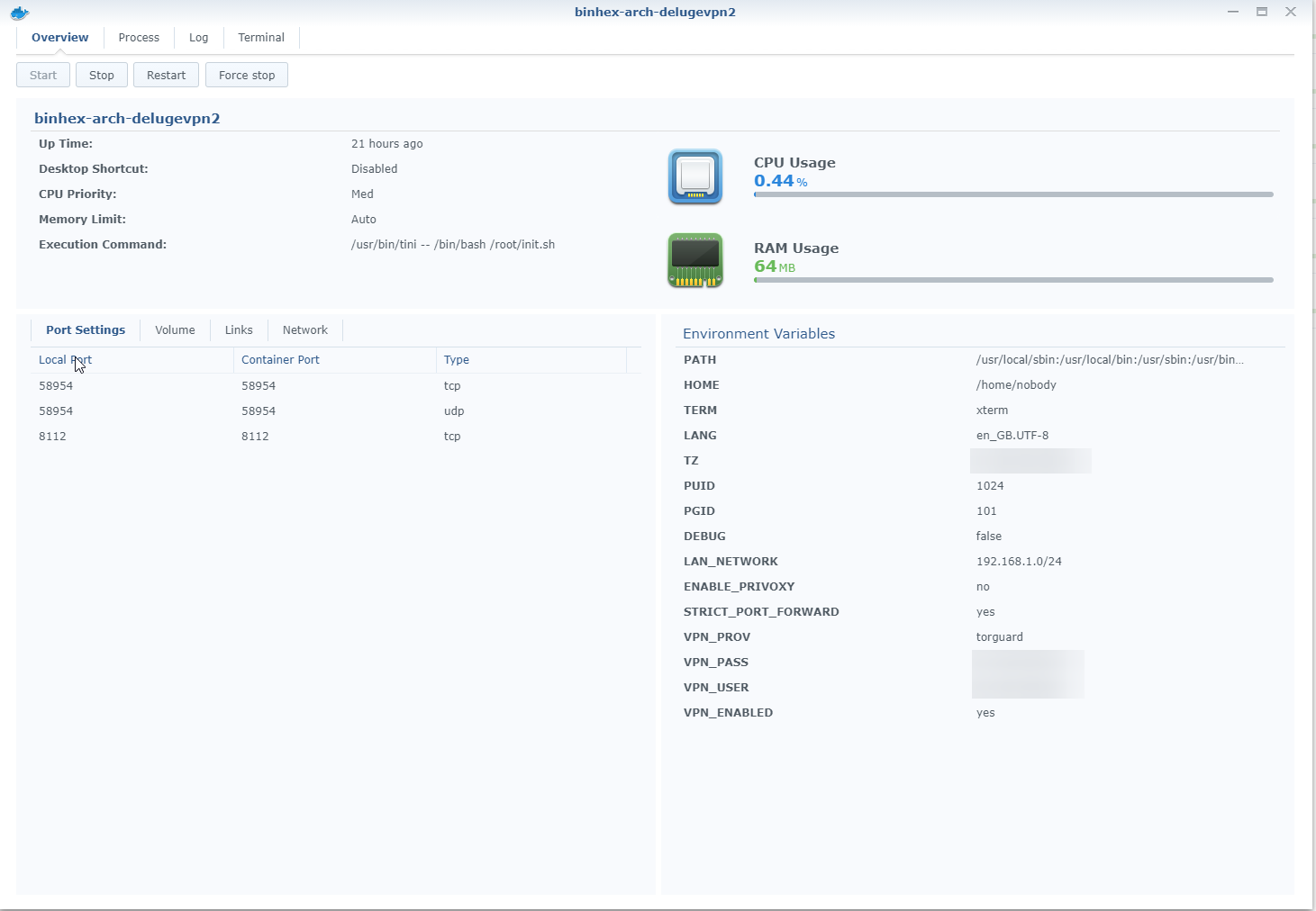

Hey! So recently I just started having issues with my Deluge container running on a Synology DS918+, it just keeps restarting and I cant' access the web gui.
I'm using Torguard as VPN-provider.
My Enviroment settings look like this.
Could be that it started when I updated my Synology, perhaps it changed something?
I've tried deleting the container and recreated it, didn't help.
Edited by e2zippo
See Q17: https://github.com/binhex/documentation/blob/master/docker/faq/vpn.md

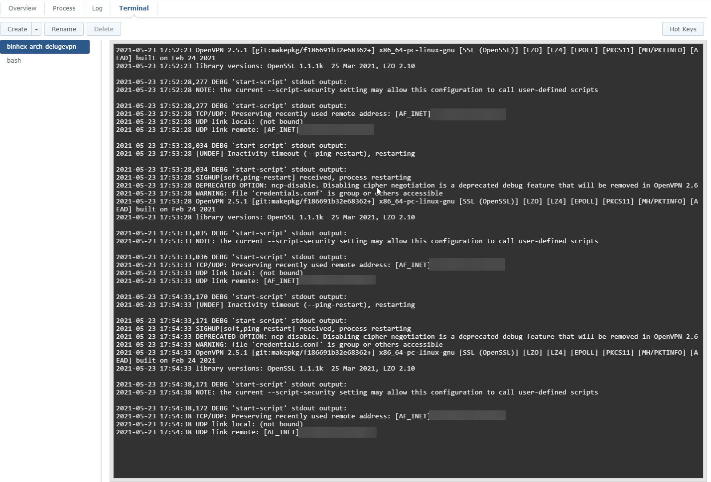

So I am not able to get torguard working via wireguard.
I have generated a known good config that works on my phone via lte and on my desktop.
It does not work with this docker however.
Watching the log in debug mode it reads "Having issues resolving name 'www.google.com'"
Keeps trying for x times then just fails.
Connecting to the console of this docker, I cannot ping the dns and thus cant get any name resolution.
At this point it attempts to get the vpn public IP but fails as it can resolve any address.
Thus far I've completely removed docker and reinstalled it, completely removed deluge and reinstalled it...
Any ideas of what I can try?

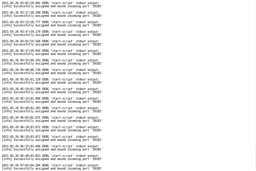

11 hours ago, Philby1975 said:
Port Forwarding Question.
Below photos show logs and 'open ports' according to the console. Does this confirm that PIA VPN is port forwarding the correct port ? If not what do I need to do to a) forward the correct port; and b) confirm it is forwarding correctly. All my research so far indicates that this docker should do it all.
Thanks in advance for any help.
Q9. https://github.com/binhex/documentation/blob/master/docker/faq/vpn.md
