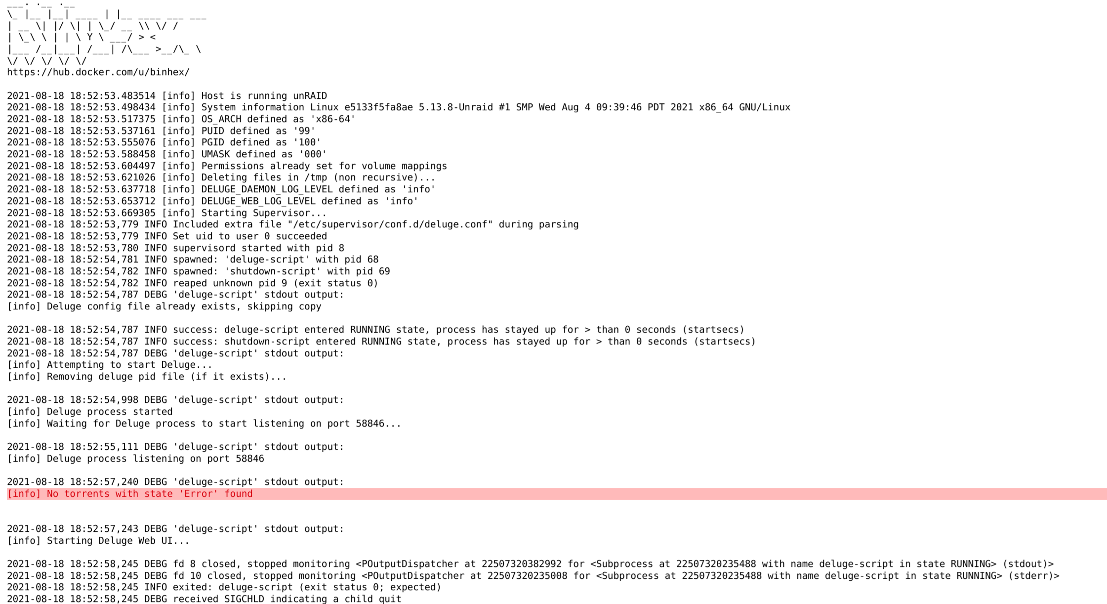

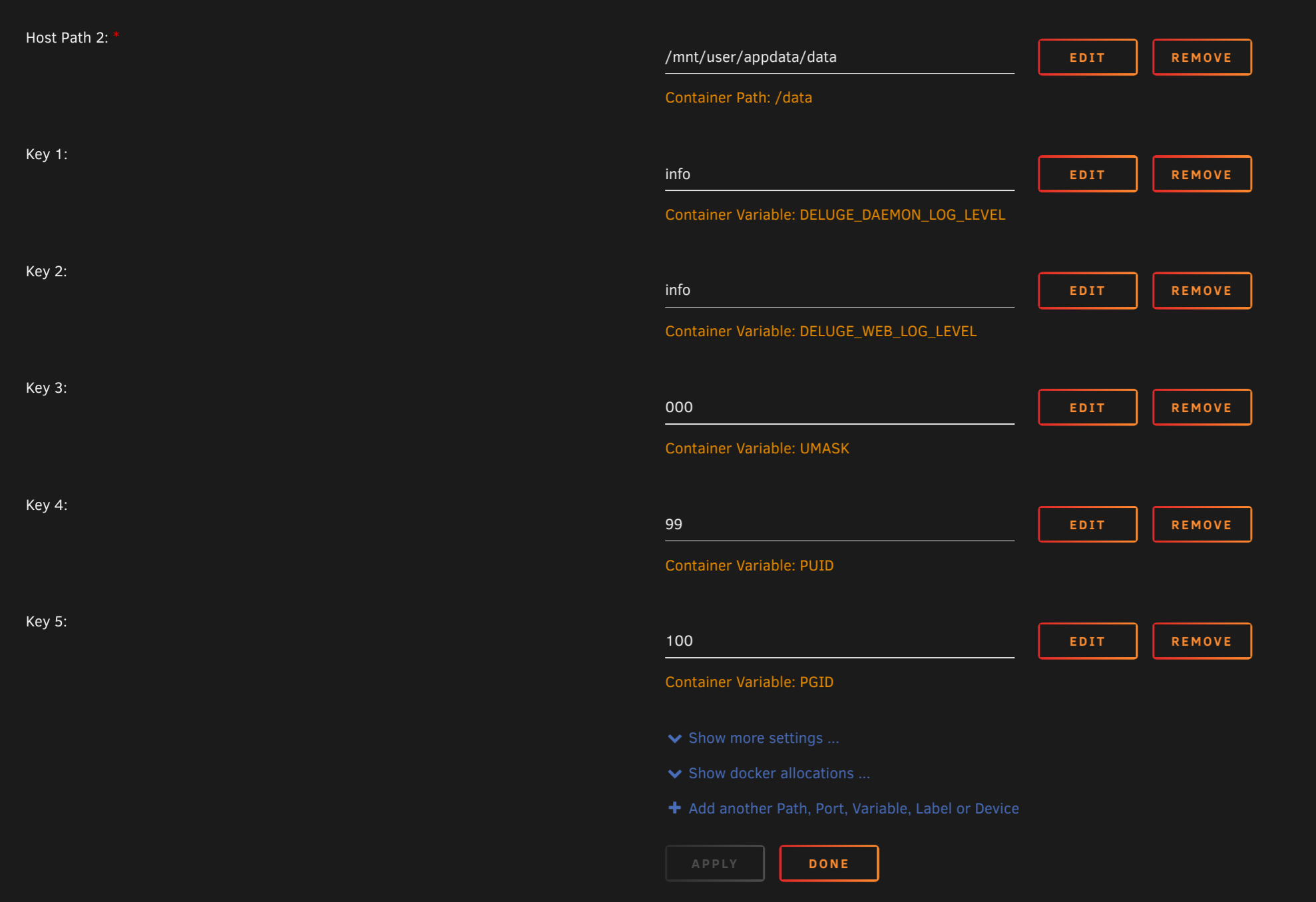

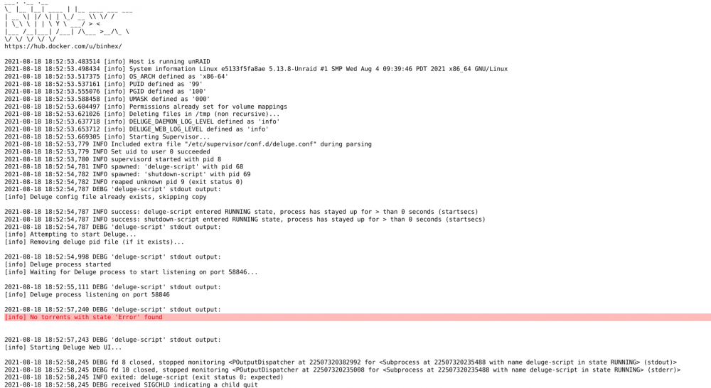

So I've had power blips the past two days that seem to always knock out ONLY Deluge from working again on reboot (I finally hooked up the server to a UPS so hopefully that won't happen again). For some reason the WebUI won't load for me.
I was able to get it to load if I disabled the VPN portion the docker settings, but need VPN enabled for obvious reasons. I checked through the log real quick (I'm very much in the dark for command line and such) and the only error I found was This "2021-08-16 19:20:08,424 DEBG 'watchdog-script' stdout output:
[info] No torrents with state 'Error' found"
There are also 2 warnings in the logs:
"2021-08-16 19:19:52,012 DEBG 'start-script' stdout output:
2021-08-16 19:19:52 DEPRECATED OPTION: --cipher set to 'aes-128-cbc' but missing in --data-ciphers (AES-256-GCM:AES-128-GCM). Future OpenVPN version will ignore --cipher for cipher negotiations. Add 'aes-128-cbc' to --data-ciphers or change --cipher 'aes-128-cbc' to --data-ciphers-fallback 'aes-128-cbc' to silence this warning.
2021-08-16 19:19:52,013 DEBG 'start-script' stdout output:
2021-08-16 19:19:52 WARNING: file 'credentials.conf' is group or others accessible"
I was able to get it to work after yesterday's blip, but I really don't know what did it. I've tried updating the OpenVPN files several times, including trying a few different servers. The only thing is I'm not sure if I'm supposed to use the "openvpn" or the "openvpn-nextgen" folders that I have (I believe I got it working using the nextgen yesterday).
Help and ideas much appreciated.
EDIT-
So not sure what did it, but I tried switching to Wireguard, which didn't work. But when I removed the additional clause for Wireguard, the WebUI started working again.
Edited by shadowkid017
Issue solved?

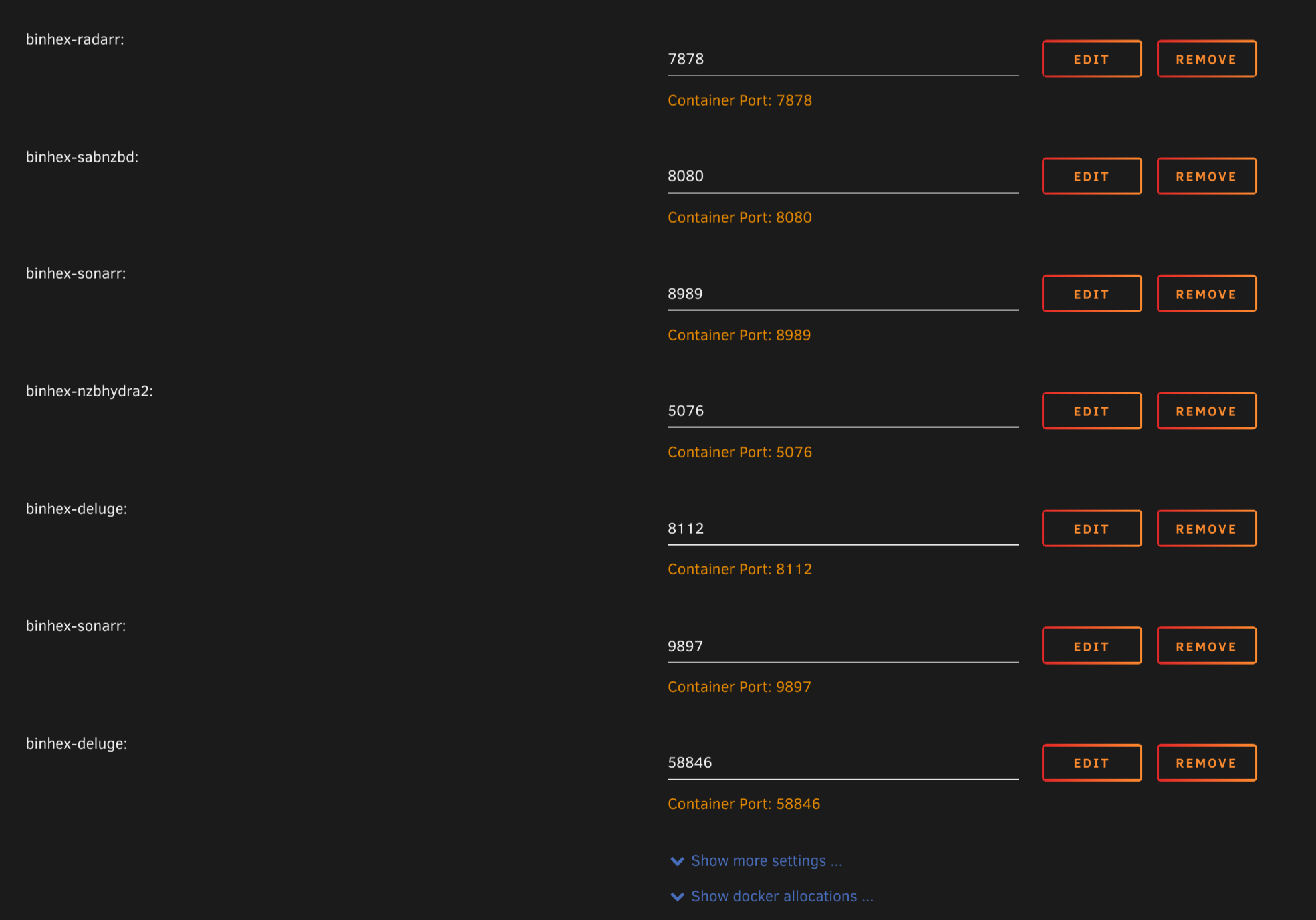

I hope someone can help me out please.
I have now routed all my containers through Binhex-privoxyvpn and its all working great, EXCEPT for Binhex-deluge.
I have ensured that the exact same settings on both Deluge and Privoxy have been used however when I start up the privoxy GUI it just seems to hang with no message. The logs seem to show everything as fine. For reference I'm using Mullvad Wireguard.
Any suggestions would be greatly appreciated, thanks.
***Just to add, I can "curl ifconfig.io" inside the Deluge container and it returns the same IP as Privoand all the other routed containers.***

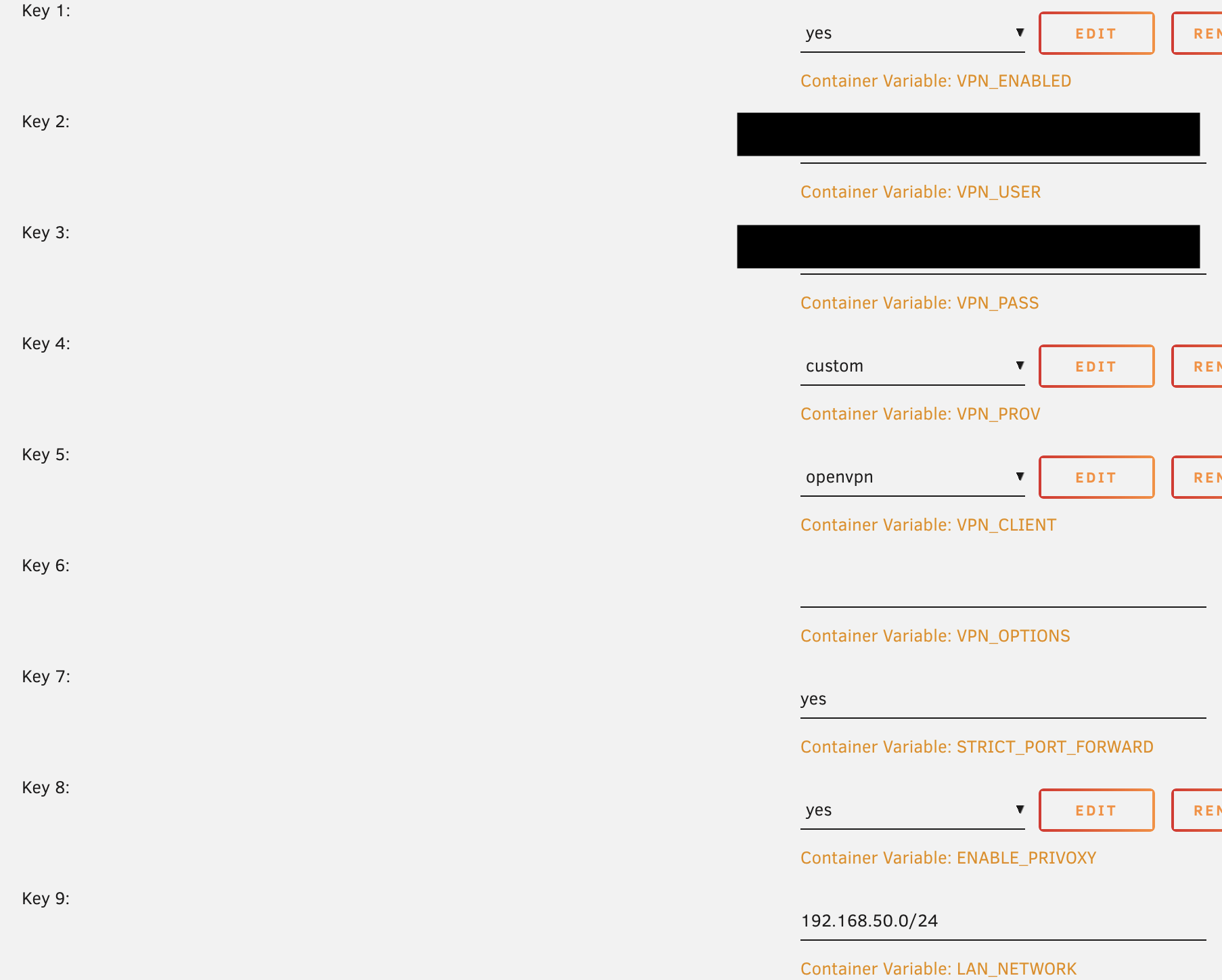

On 4/21/2021 at 6:02 PM, wobblewoo said:
Hello. Im trying to setup Deluge Docker with my VPNSecure details and i cant get it to work. It works fine is i turn the VPN off.
Ive used these details:
Key1: yes
Key2: <my username>
Key3: <my password>
Key 4: custom
Key 5: openvpn
Key 6: i've left this blank, i don't know what it is
Key 7: yes
Ive downloaded the .ovpn file i need from VPNSecure and placed it it /appdata/binhex-delugevpn/openvpn
I also placed a few other files supplied by them in there, the folder contains:
myusernam.key
ca.crt
credentials.conf (generated by the Docker)
dh2048.pem
nl1-TCP-myusernam.ovpn
myusernam.crt
When i try to go to the webUi on port 8112, nothing happens.
Im fairly new to this - short of getting a PIA account, can anyone help?
Many thanks.
anyone know if this issue with Vpnsecure and DelugeVPN got resolved? Got the exact same problem as wobblewoo had.

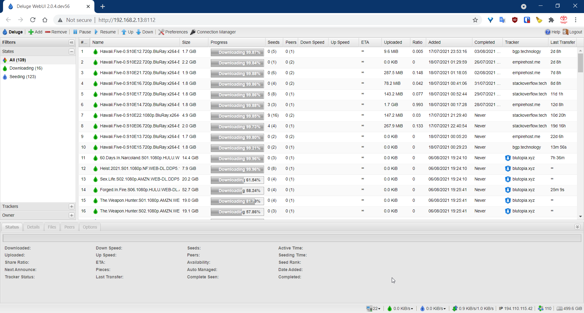

Guys I cannot get my torrents complete from a specific private tracker.
What can I do to get them complete, because before I haven't had no problems with this tracker at all...

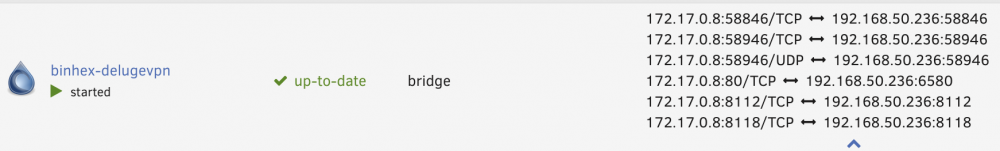

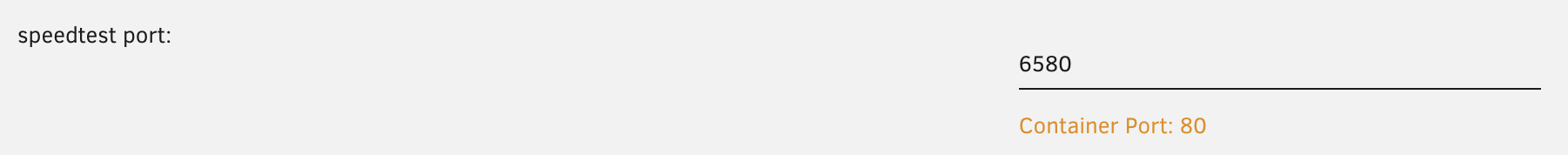

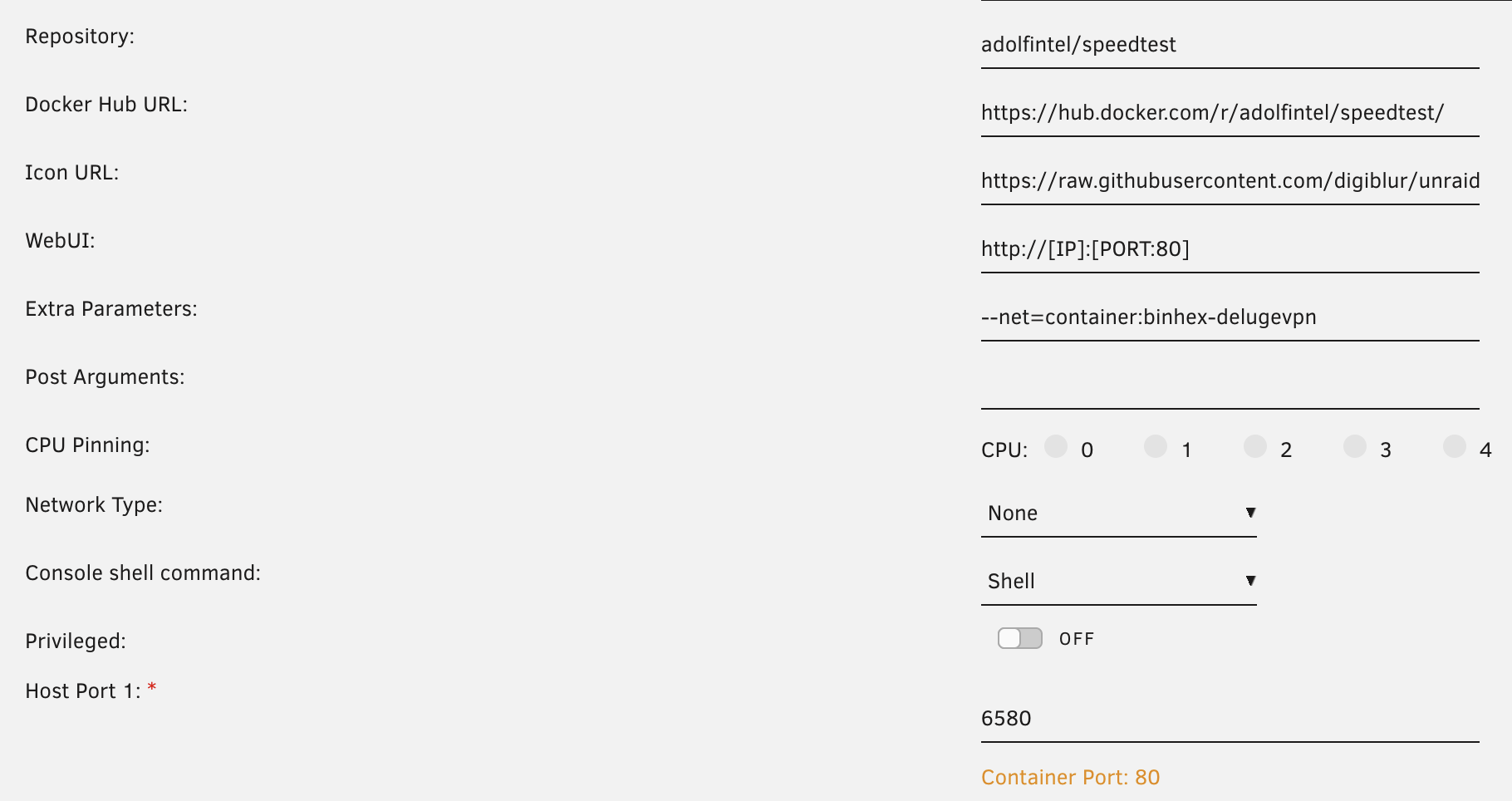

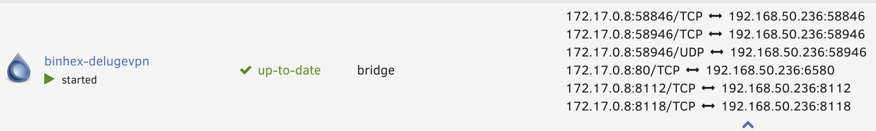

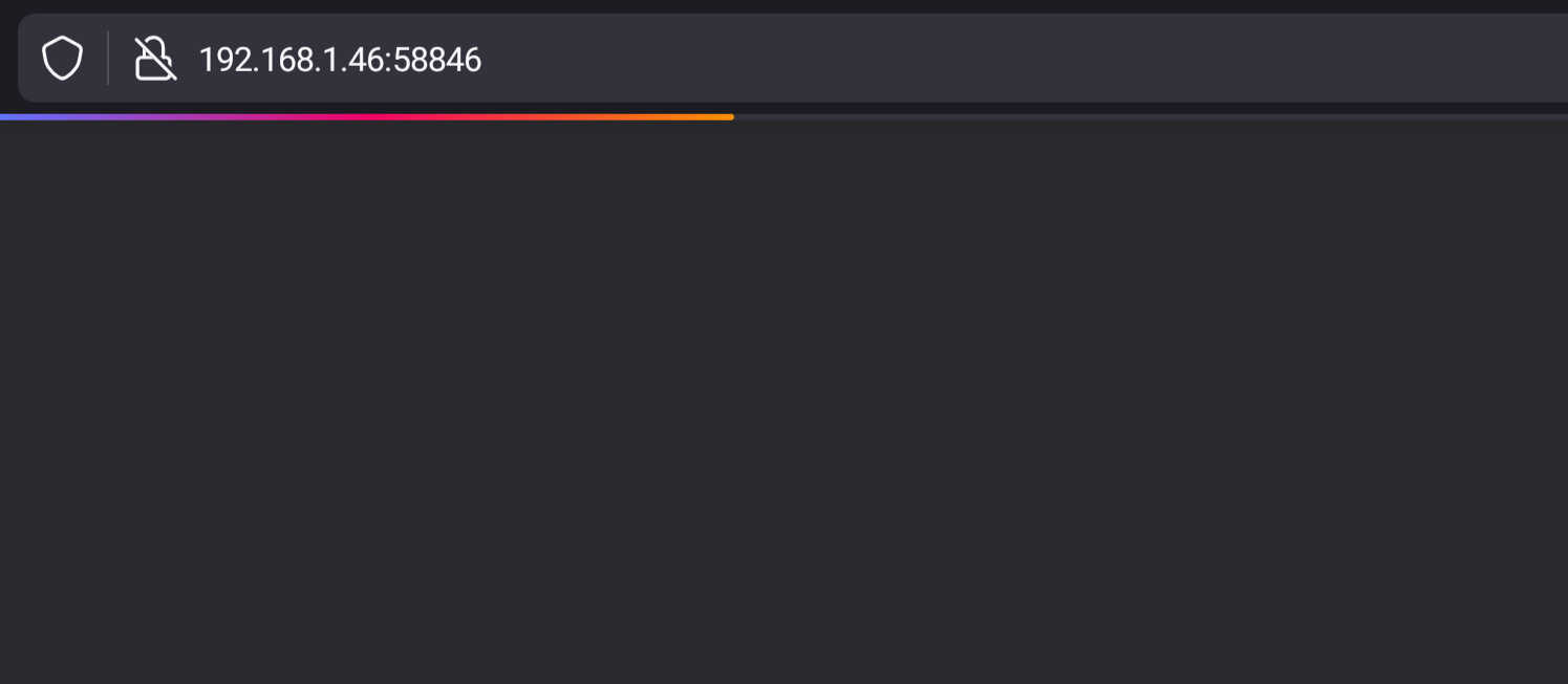

I have just set up delugevpn and am attempting to test the speed and make sure everything is in working order, and I can't get the web UI for speedtest working through deluge to save my life. I'm trying to put adolfintel's speedtest docker through delugevpn. I followed the following steps:
  1. Set network type in speedtest to none
  2. Set extra parameters in speedtest to --net=container:binhex-delugevpn
  3. Add port variable in delugevpn docker that matches the port variable of speedtest
Both start up. curl ifconfig.io shows the correct ip address in the country of my VPN config file. However, when I attempt to get to the speedtest webui by typing in my server IP and port, the connection times out. Attached are images of the relevant settings. Am I doing anything wrong?
Edit: this is happening with all dockers I've tested.
Speedtest settings:
delugevpn settings:
port mappings:
Edited by kwatz

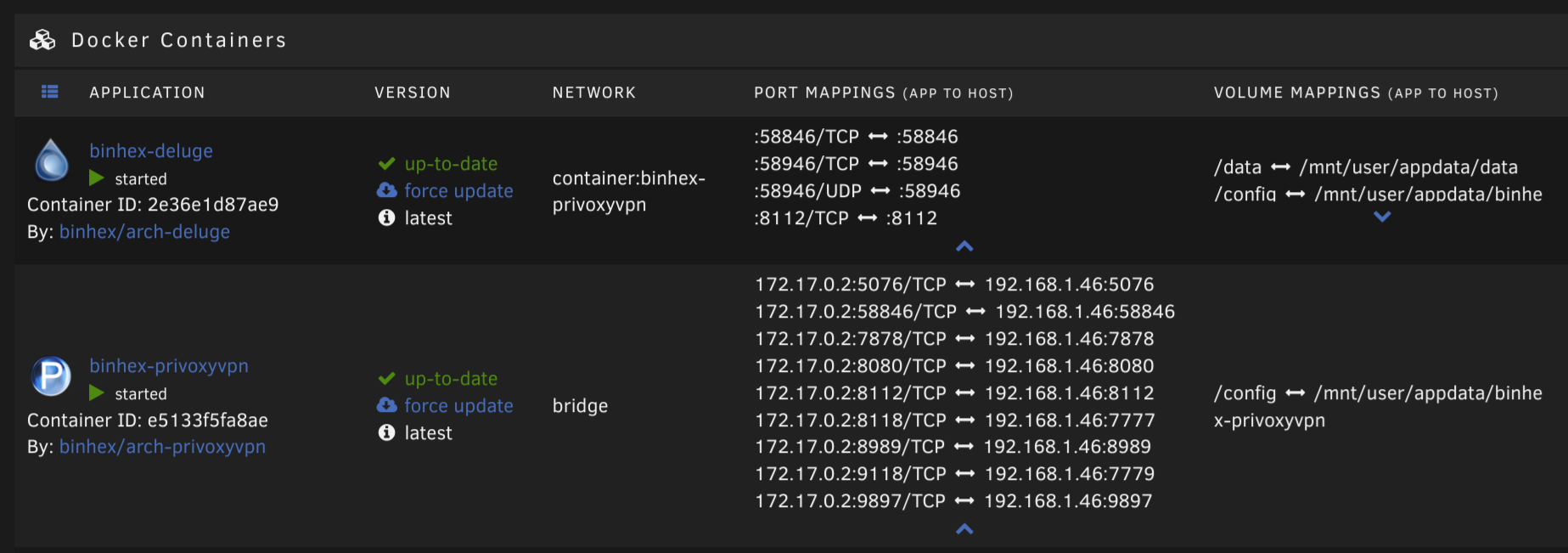

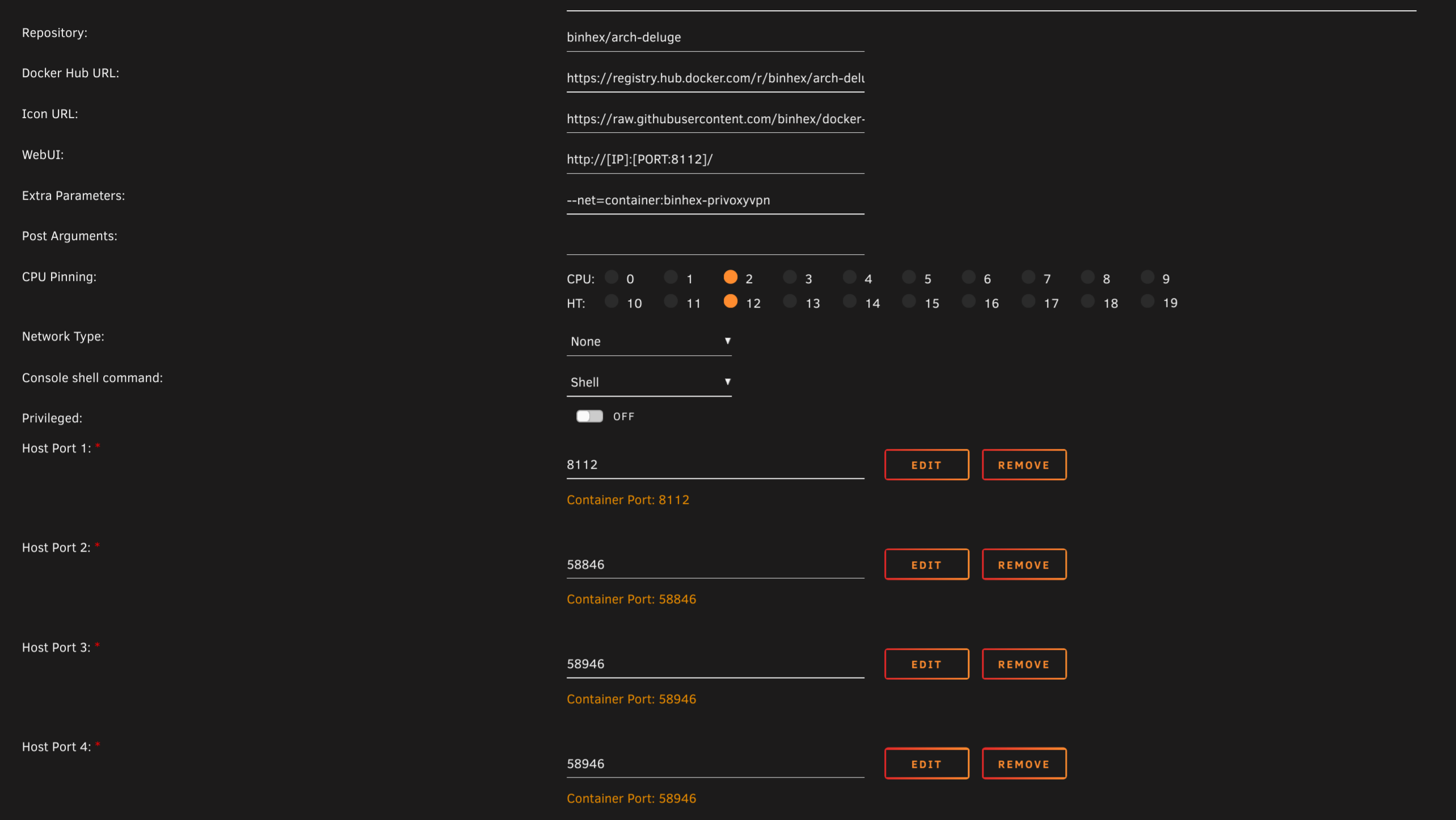

Speedtest settings:
delugevpn settings:
port mappings:
I am having the exact same issue, I'm running all of my dockers through Binhex-privoxyvpn and everything is great. However, whenever I try to run ANY torrent docker (Binhex's Deluge or anything else) through Binhex-privoxyvpn, I run into the exact same issue as yourself.
I look forward to seeing if you are able to fix this issue. Please let me know if you resolve it away from this post. 👍🏻
***EDIT***
The solution is here (Q24 & Q25);
https://github.com/binhex/documentation/blob/master/docker/faq/vpn.md
You need to update you VPN_INPUT_PORTS variable in Privoxyvpn with the port of the container you wish to access. This was implemented as part of Binhex tightening security.
Edited by BeardedNoir
