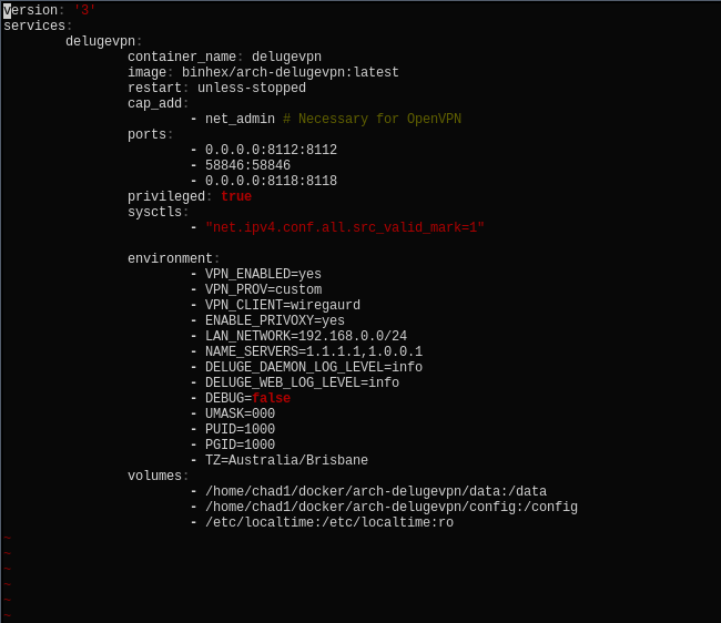

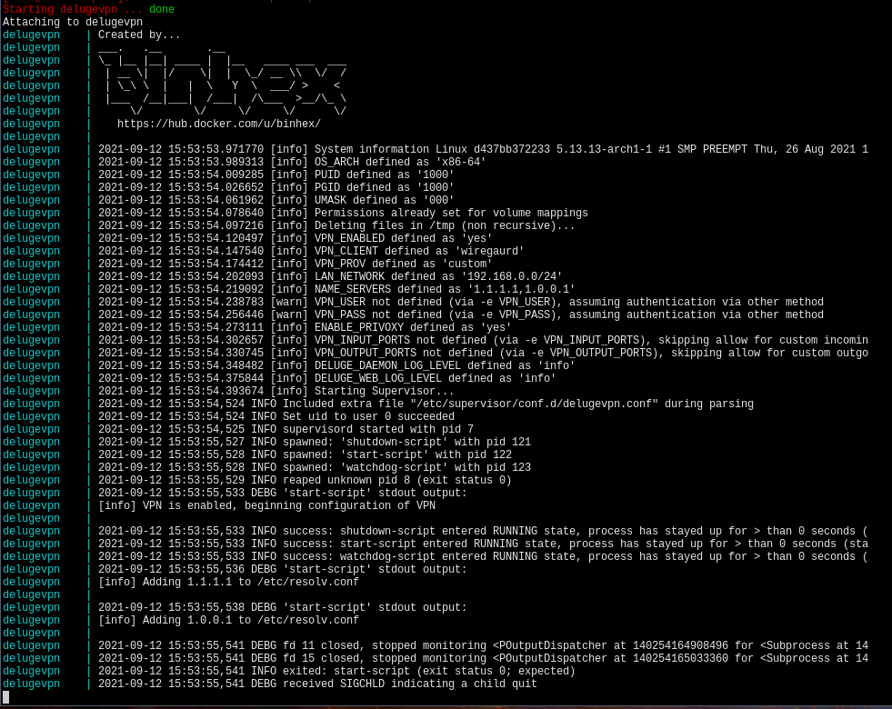

Hi I recently installed Delugevpn but I've been having trouble setting it up. To my knowledge it should say "privoxy process listening to port 8118" at the bottom but it doesn't and I can't access the webui. I'm pretty new to docker and vpns in general so I apologize if the fix is really obvious. I've looked around and I can't work out what the issue is so any help would be appreciated. I'm on arch-linux by the way.
Here's the logs when I start it
and here's the compose file
Edited by jodirt
to add some extra context
I have the same issue. I have confirmed that VPN tunnel is UP (see below). I can ping the container, but nothing on port 8112. My VPN provider is Windscribe and I am using OpenVPN.
I am able to connect when I turn off VPN.

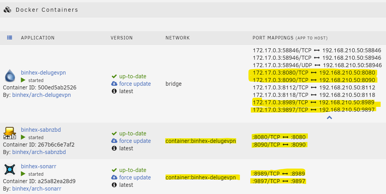

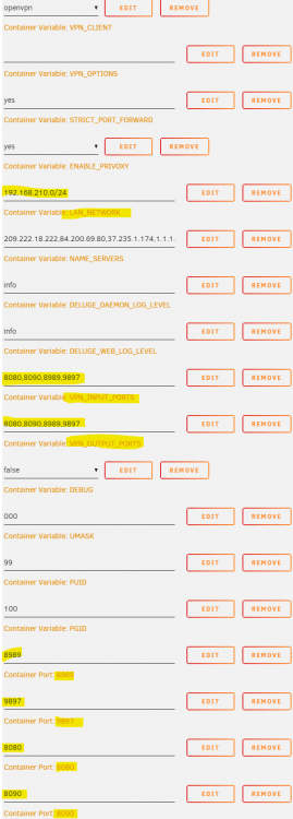

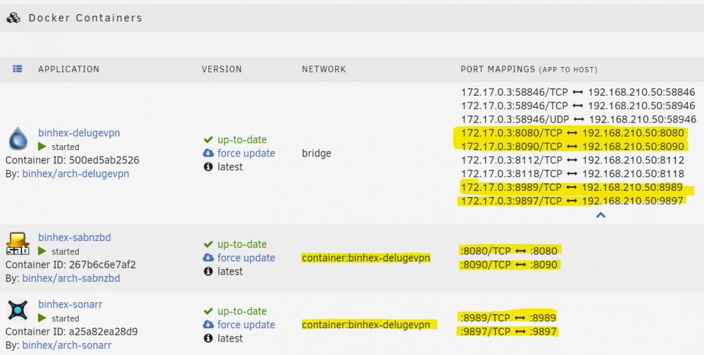

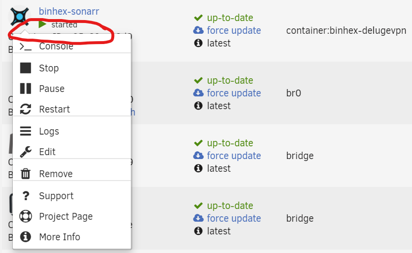

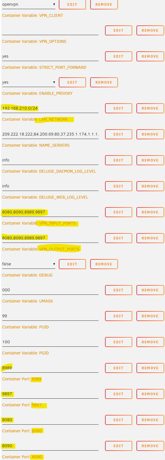

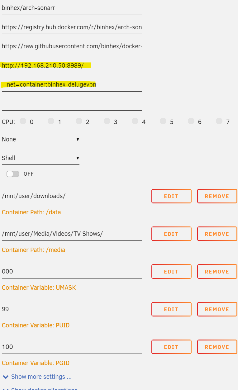

Hi.
I believe I have finally deciphered how to make this work.  However, I cannot access the web gui directly from Unraid's docker menu.
Once I remove the network from, say, Sonarr and add it to the binhex-delugevpn network, the "WebUI" option on the Docker screen in UnRAID disappears for Sonarr.   If I visit the IP:Port directly in a web browser, it works
However, the containers seem to communicate fine.  Sonarr tests fine when I run the "Test" button for the download clients.  I'm still working through getting the Indexers working as well as they don't respond at all from Sonarr, but that's another issue I suspect.  I just wanted to ask about the missing WebUI link in UnRAID itself for now.
Is it intended behavior for the "WebUI" option to disappear from UnRAID's docker menu for any containers directly passed to the binhex-delugevpn network?  If so, may I make a suggestion for the official documentation to add this caveat to Q25/A25?
Overview:
binhex-delugevpn configuration:
binhex-sonarr configuration:
UnRAID Docker WebUI Missing:
Edited by Jason Harris
in a word, yes, you can add it back in if you really want i think, or simply bookmark the ip:port and be happy 🙂
Ok no problem.  I was just pulling my hair out this past week trying to see why it wasn't working.  Totally fine with the bookmark method, that's what I was thinking I had to do.  Cheers :)

I downloaded a new conf file from PIA, no change. Before I start the Self signed certificate process, is there another way to fix this?
Most happy for any help.
Im experiencing a similar problem with sonarr and radarr.  We’re you able to find a solution.
No, I'm sorry. I have to start all over again with binhex-delugevpn as Wireguard. binhex-delugevpn is working, but how do I see that Wireguard setup is working?
