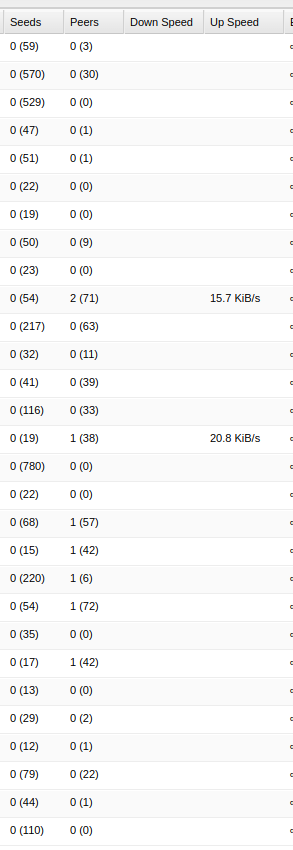

Did PIA change it's port forwarded servers again? I'm getting all KB speeds this morning. My supervisord.log only shows;

None of which I currently have configured.
just restarted my container and i dont see the same, ive got the normal listing:-

Hey Guys,
I am wondering if I can help. I am suffering servere slow upload on torrents using Deluge w/AirVPN (20KiBs-60KiBs). I am using an unlimited traffic server with Hetzner as the provider, I get 900Mbs up/down using ookla speed test cli, only 300Mbs up/down inside the container with AirVPN (I can live with this). I have set up a remote port on AirVPN using UDP and have set that port as the incoming port on deluge. I have installed the ltConfig plugin and set it to high performance. I have 30 seeding torrents and yet right now there is only 3 active with 20KiBs-60KiBs upload. Any idea what I might be missing?
As you can see the ratio on some of those torrents like 15 seeders to 42 peers, surely I should be seeding? It even shows a bunch of active peers e.g. 1 (38) but I provide no upload.
If I click a torrent with no upload and an active peer and look at peers sometimes it will show one with downloading 0%.
Should the port on the peers address match my incoming port? Right now it doesn't, I don't know if that is an issue.
