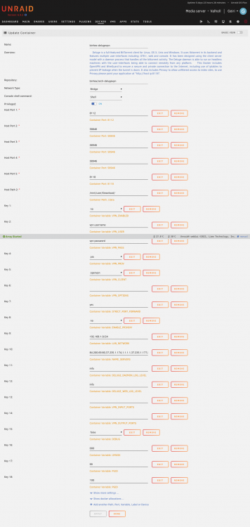

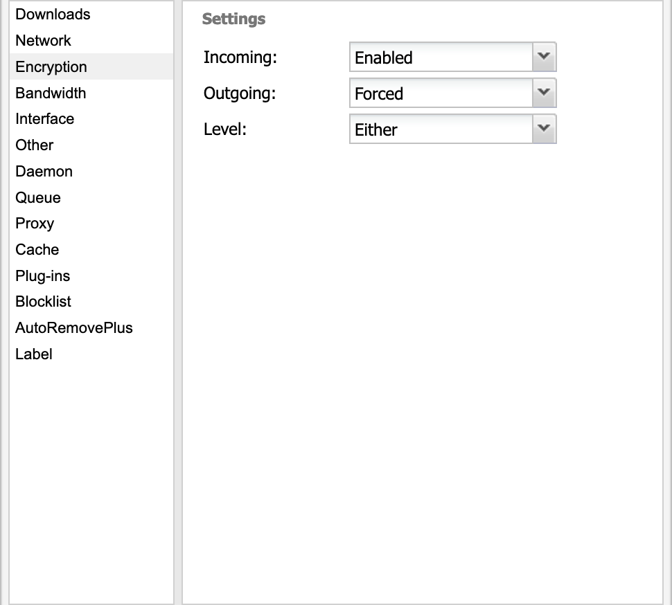

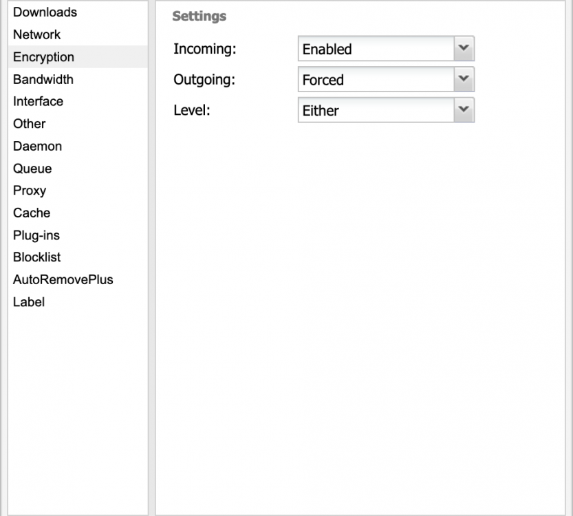

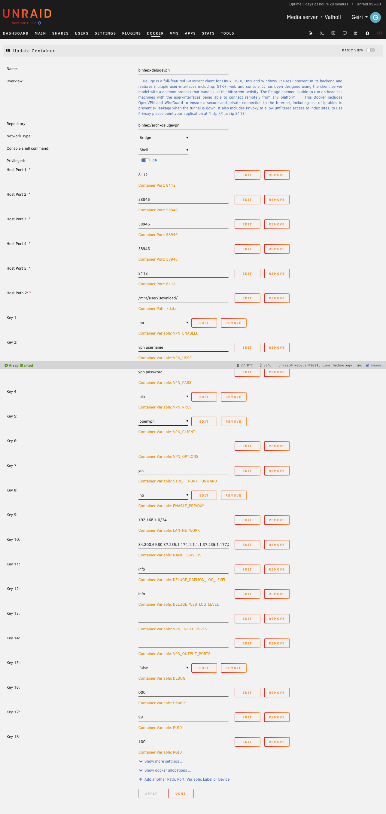

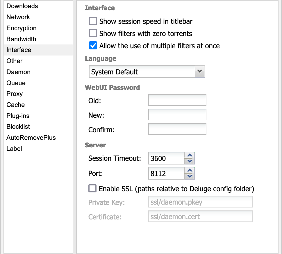

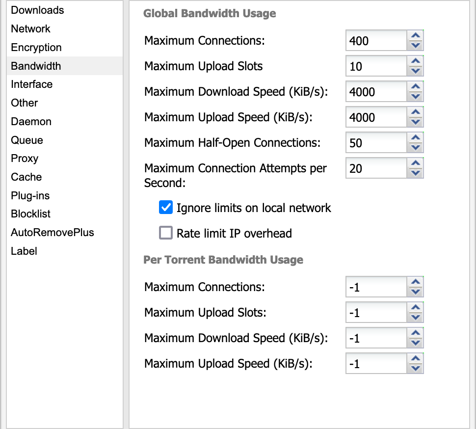

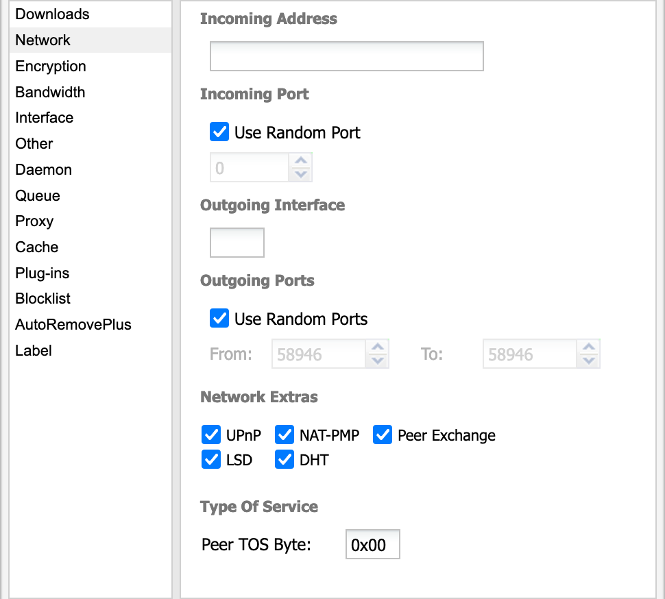

Hi every body and happy new year. One of my new years resolution last year was to have my media server fully functional as I want it to work. Long story short that didn't happen so nows the plan to finish that.
Regarding Delauge it DL files at full speed, but UL is really slow, and moste of the time there is no UL going on.
My router is Ubiquiti USG and I have enabled UPnP on it.
I am not running any VPN at the moment  while I am figuring this out.
I have been trying a lot of things, but nothing seems to be in the right direction
If any one can assist it would be much apprichiated.
classic signs of no incoming port, which from your scrrenshot is confirmed, you basically need to do the following:-
router - set up port forward from 58846 tcp and udp to the ip of your unraid server
deluge - untick random incoming port and specify the port as 58846.
note - this is ONLY required when NOT using a vpn connection, when using a VPN no port forward is required on your router.
Thanx binhex for all your contribution to the Unraid community,
I tried your advise, but as soon as I change the port to 58846 and restart deluge I am not able to open it any more. I have tried 3 times from scratch and always same result. After some playing around I noticed that port 58846 is by default the demon port.
Why opening an incoming port when I am having trouble with outgoing traffic?
I also did try VPN with PIA out (but with another router) and I got simulare result that good DL speed but almost no upload.

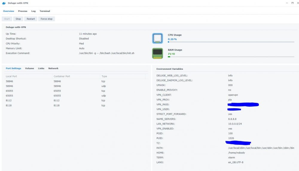

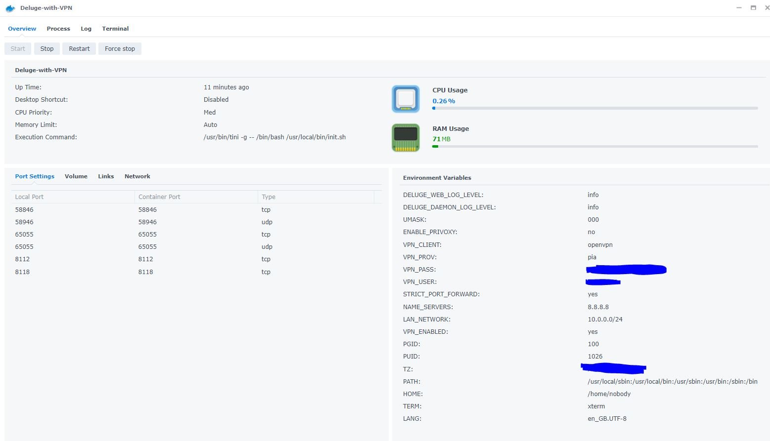

Hi Binhex and forum
I've just setup delugeVPN running in docker on synology NAS DSM7..
If I set VPN_ENABLED = no then I can access webUI at NASip:8112.
If I set VPN_ENABLED = yes then I can see the Deluge UI at NASip:8112 but connection says my daemon is "offline".
BUT I also access deluge via an android app called Deluge. I can use this app to access deluge with VPN_ENABLED yes or no and it work fine. I can add torrents, download, deluge move completed files. I can even confirm that the VPN is enabled using checkmyiptorrent.
Any idea why I can't access the daemon via webUI with the VPN enabled despite it definitely working?
sorry i am telling you duff info there!, that's what you get for not using this image for a while :-), ok the RIGHT port to port forward is 58946 as you are right that port 58846 is used by the daemon.
On 1/2/2022 at 11:07 PM, binhex said:
simpler for me to include it, which im happy to do as its a small package, look for it in the next image release.
Awesome! Thank you :D
I've attached my log below (sorry it's upside down with latest first).
I feel like my issue is something simple as
-Deluge is working,
-I can send torrents using a Android Deluge app and they work normally,
-I can call up the web UI at mylanIP:8112
but I can't log in as the connection manager says the daemon is offline (which it isn't according to the android app).
Any help appreciated!
