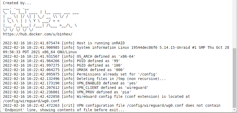

I have some problems with the DelugeVPN container. I used to run it with VPN enabled for a long time but recently turned it off to test something and now it won't turn back on again. I get this message in the logfile:
The Wg0.conf is empty. I have tried removing the container and image, and then installing it again, but that did not solve it. Does anyone know why this happens and how I can fix it?
