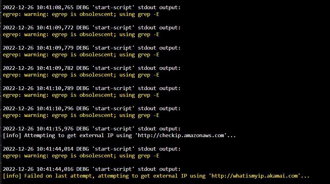

Hey guys - I updated to 6.11.5 and now DelugeVPN is not working properly. I keep getting the following errors. Any ideas? Thanks!
I am having the same issue. Switching locations works temporarily for a few minutes then stops again.

DelugeVPN can't get the external IP then errors when trying to download the JSON to generate token. I will upload my log files later.

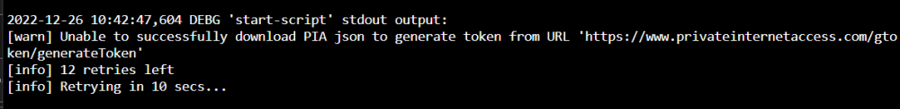

Changed to Wireguard, still getting:
2022-12-28 21:05:38,291 DEBG 'start-script' stdout output:
[warn] Unable to successfully download PIA json to generate token for wireguard from URL 'https://www.privateinternetaccess.com/gtoken/generateToken'
[info] 12 retries left
[info] Retrying in 10 secs...
