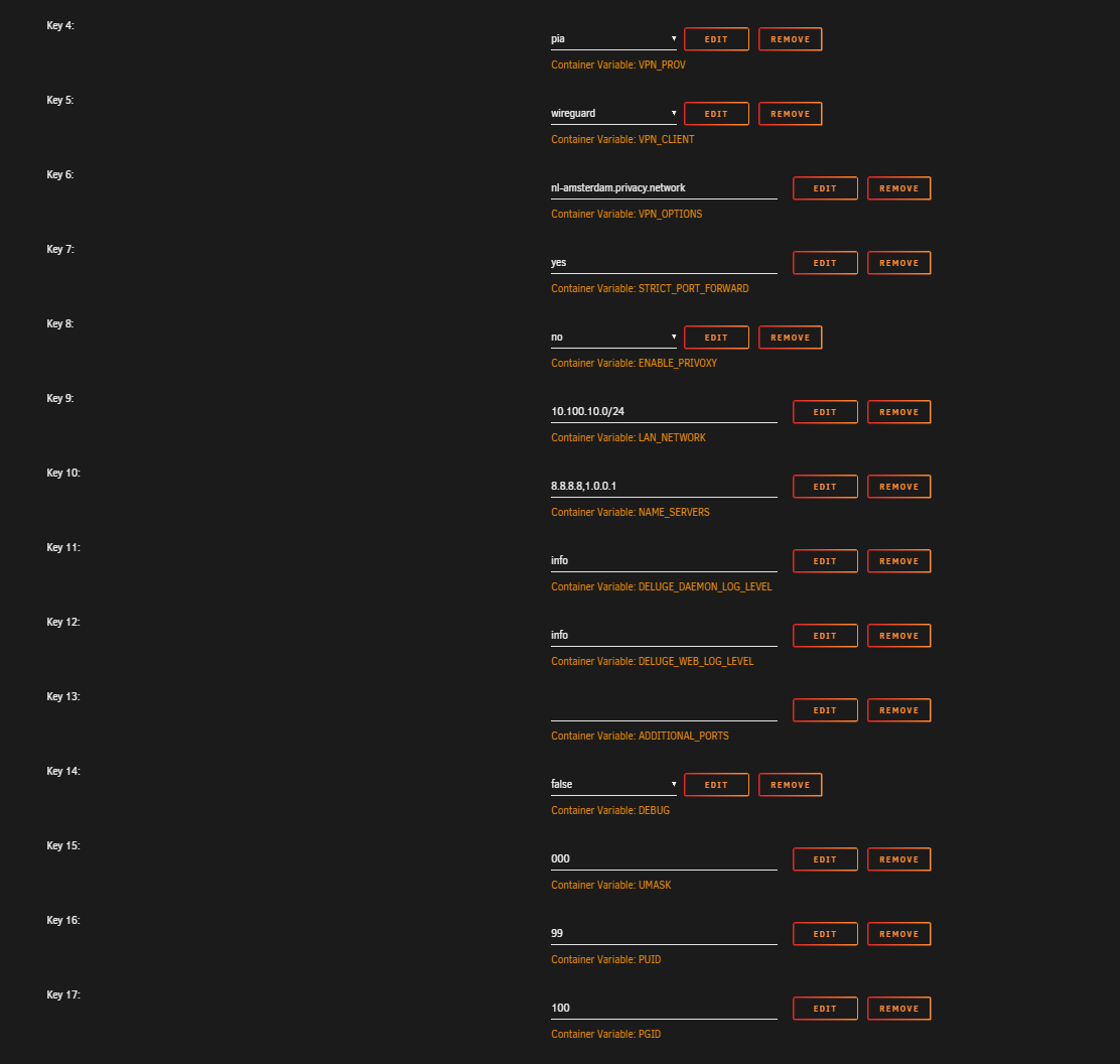

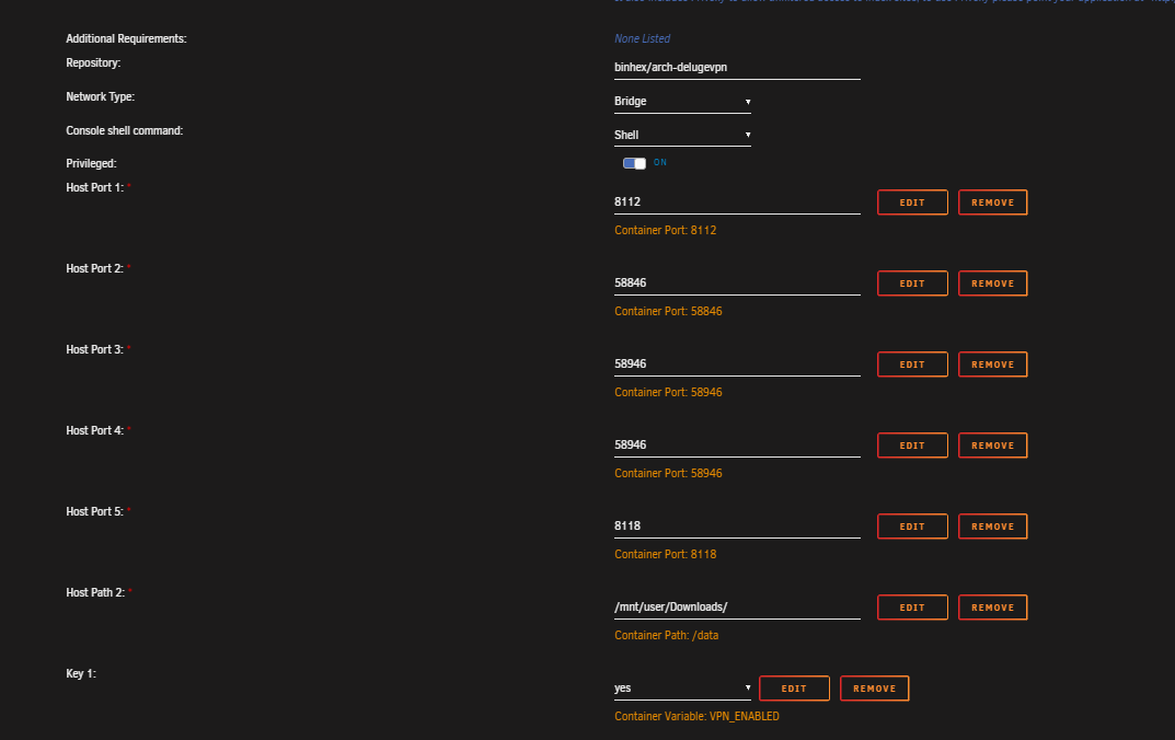

I have an issue with DelugeVPN, it seems that the application has some issues after I restarted my server - no changes happened to my setup prior to this.
WebUI doesn't work
Attached Unraid setup settings
Debug log info (FYI I cleaned the token for obvious reasons)
2023-01-08 16:39:23,663 DEBG 'start-script' stdout output:
[debug] Valid gateway IP address from tunnel acquired '10.11.112.1'
2023-01-08 16:39:24,648 DEBG 'start-script' stdout output:
[warn] Unable to successfully download PIA json payload from URL 'https://10.11.112.1:19999/getSignature' using token 'CLEANED'
[info] 12 retries left
[info] Retrying in 10 secs...
2023-01-08 16:39:34,824 DEBG 'start-script' stdout output:
[info] 11 retries left
What should I do to correct this?
Let me know if you need more logs or data to assist my issues.
Appreciate your time - thanks!
