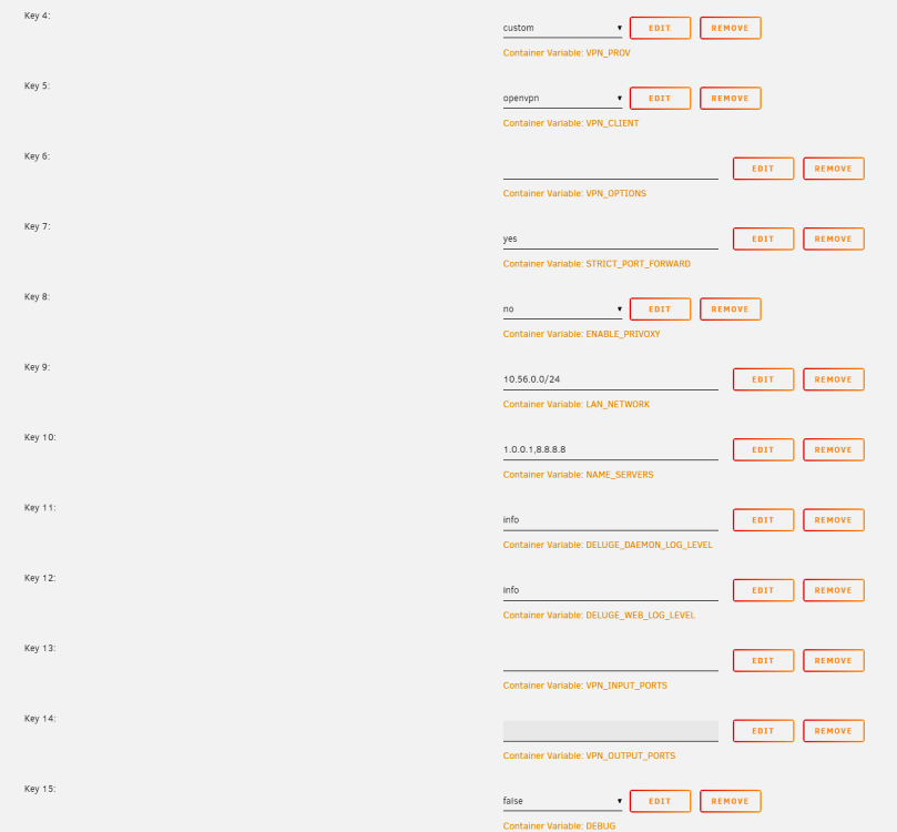

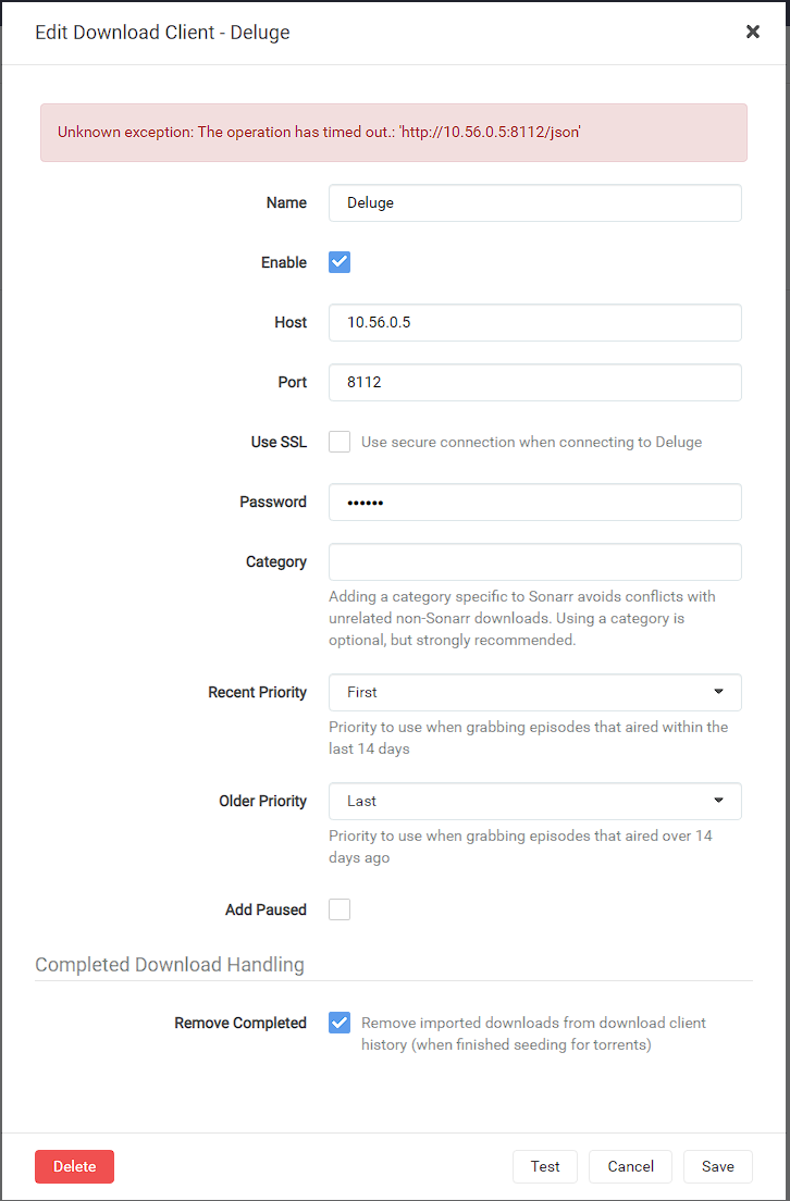

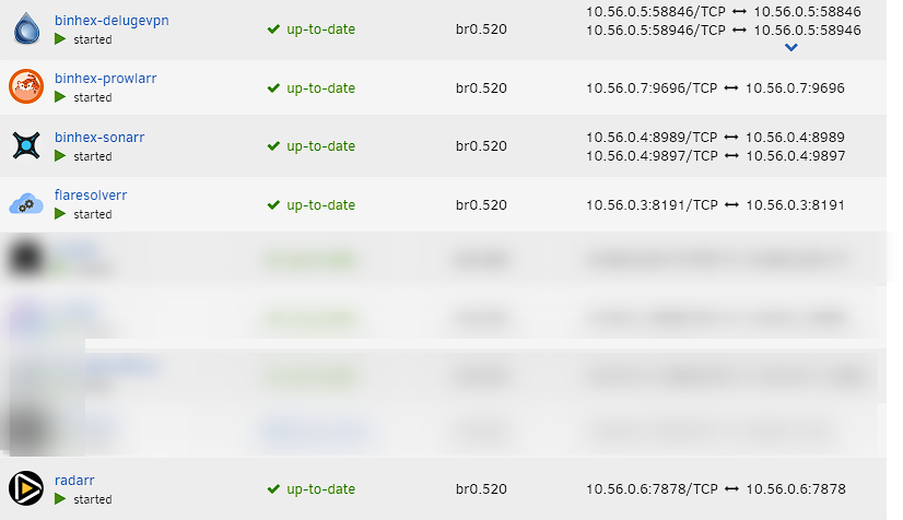

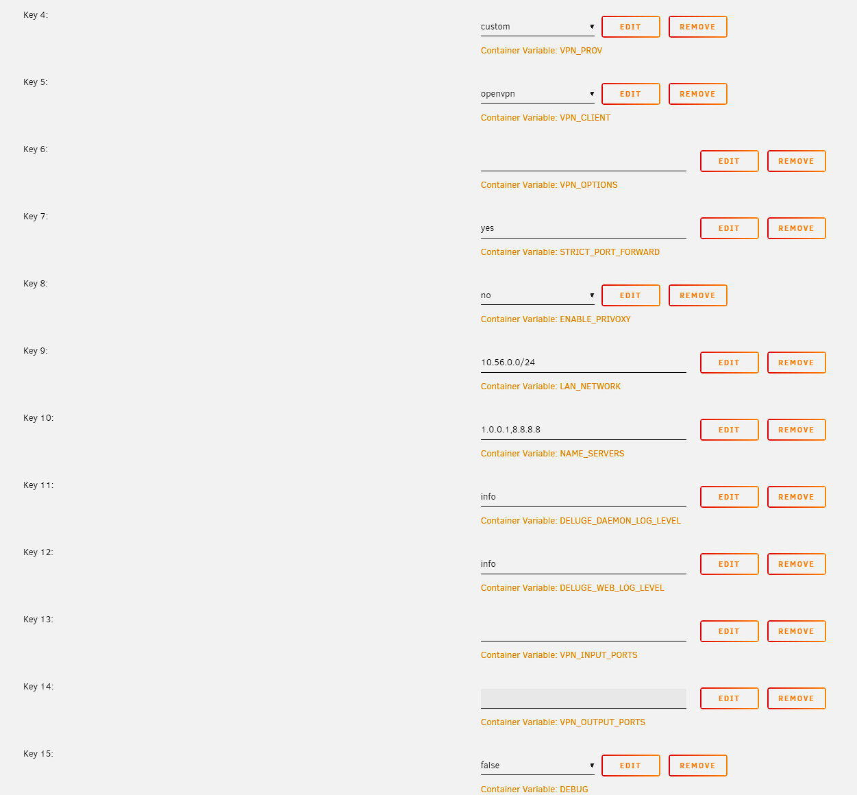

On 1/1/2023 at 1:20 PM, ategan said:
Hello, I have some problems with the configuration.
I use ProtonVPN with DelugeVPN. The VPN tunnel goes up well, I recover an ip well.
However, I cannot connect Sonarr or Radarr to DelugeVPN.
I tried to tweak the VPN_INPUT_PORTS and VPN_OUTPUT_PORTS but nothing worked...
All docker images are on the same Vlan (520).
I can access DelugeVPN's web interface.
I specify: Only DelugeVPN is mounted on the VPN, Sonarr and Raddar are on my local network (Vlan 520) and therefore not affected by the VPN.
I think I'm close to succeeding, but I'm missing a piece of configuration that I haven't found yet (Unraid Forum, Github, Reddit..).
I don't know if I should use Privoxy? I don't see the use of it in my case.
Here are some screenshots of my current conf.
Thank you in advance for your help.
Thank you Binhex for your work!
sorry for my English

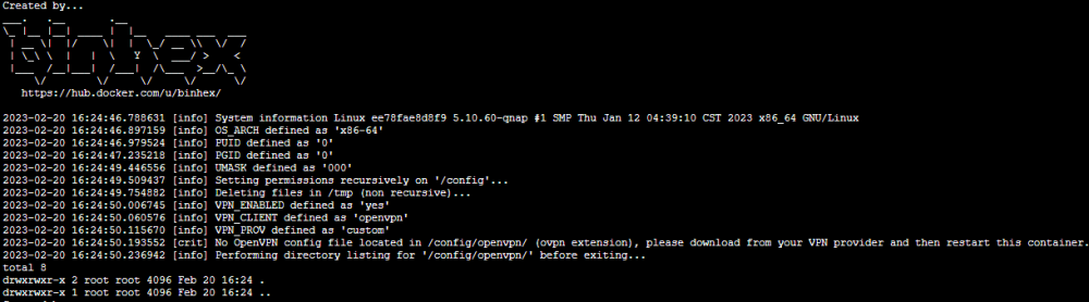

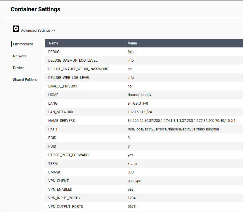

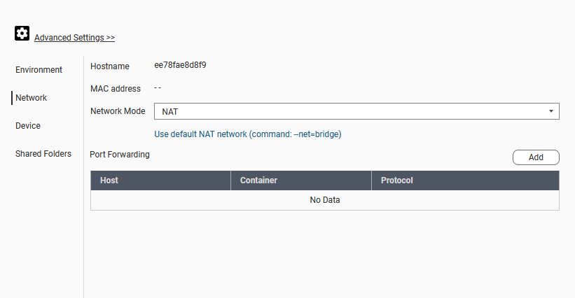

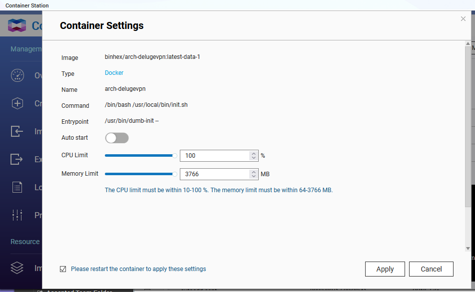

(Apols if this posts twice but I just submitted and it didn't appear - same thing happened last time I posed - strange)
Sorry for being late, have been away.
Just re-installed with the latest image and all seems fine, thanks.
However, I went into Settings in Container Station (as said previously I'm running this on a QNAP TS-253D), selected Auto Start, the Container restarted and failed to come back up as it says it's missing the OpenVPN config file.  I think it must've come back up (or re-installed?) somewhere else as the file is definately there and also the Supervisord.log file stops when the container shut down.
I've included the initial Supervisord.log, the cut n paste of the log from the screen of the new instance and some screenshots of the Container Station Settings.
Any ideas what might be wrong - as I said before - I've had this running fine for ages before my NAS crashed and I had to re-initialise it!
whats the ip address of the machine running the web browser you are attempting to connect to the deluge web ui?.
I'm accessing from my pc which is 192.168.1.126.  I'm logging onto the NAS hosting the container and that is 192.168.1.1.  The deluge webUI isn't up though cos it won't start (because of the missing OpenVPN config file.
you attached log said otherwise, you need to get your openvpn config file from your vpn provider in that case.
Sorry, I think there's a mis-understanding. I installed and it worked (as the config file is in the/config/openvpn folder that was created) but then when I restarted the container it couldn't find the config file - I think it's re-started somewhere else (which is missing the config file) but don't know where.
