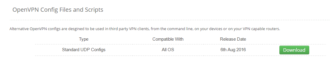

so ive just been on the website and downloaded the openvpn zip and extracted it, you should have the following files and folders shown in the screenshot attached in your /config/openvpn/ folder, if you dont then you need to re-download the openvpn zip, see second screenshot.
That was it, I must have borked something up somewhere. I put those 3 files in there again and it seems to work now. Thanks for the help. I did grab the UDP server download zip from another part of the site, maybe that one is not quite right somehow.
Excellent, thanks for reporting back
