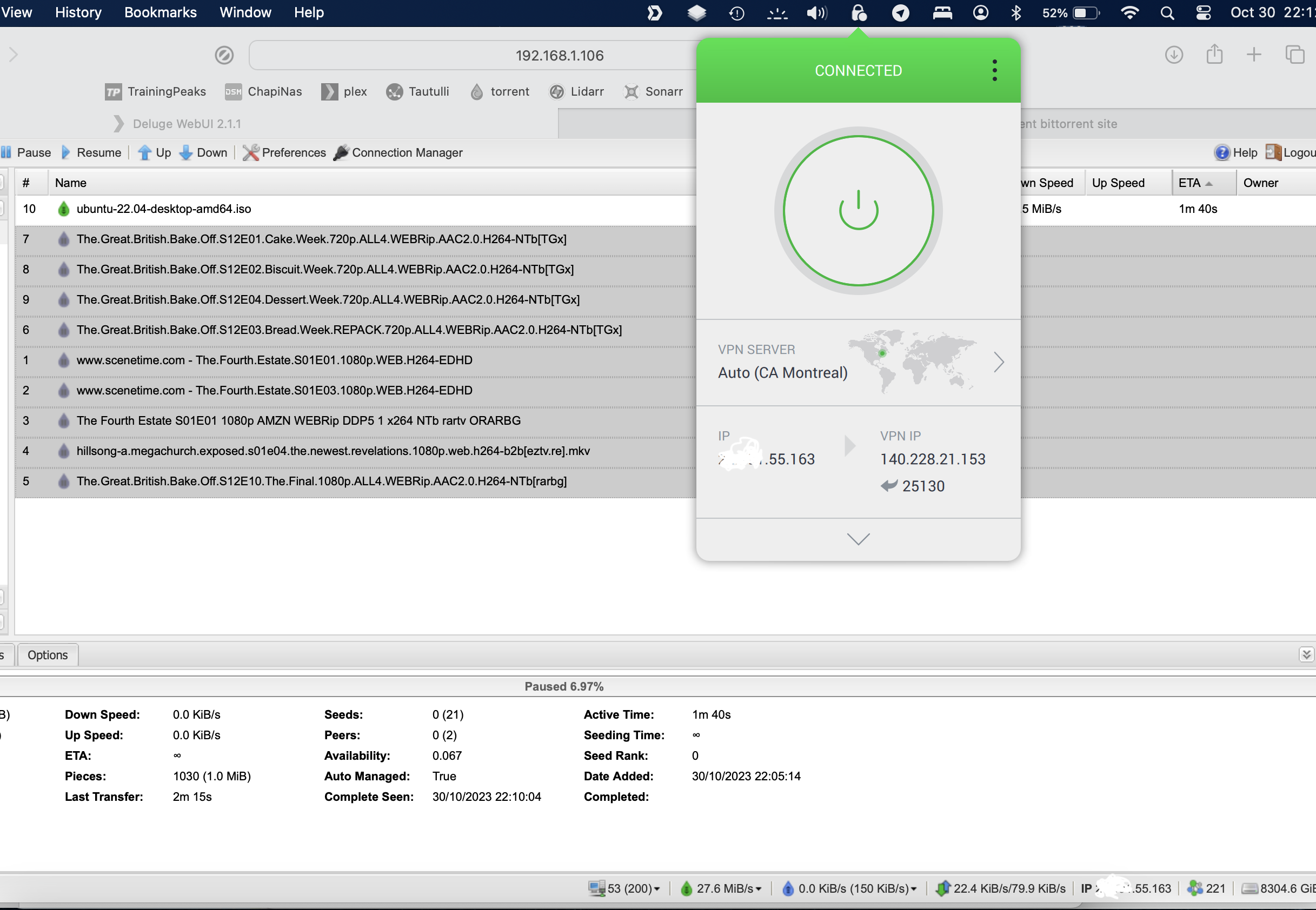

Hello @binhex. Today I noticed that my delugevpn dashboard is empty. Yesterday I set shares (smb) on my folder: `/media/videos` and `/media/torrents`.
I don;t change any permissions.
I noticed also that movies in emby don't work. I change ownership of folders to nobody and movies on emby works but delugevpn still empty. My other Deluge shows torrents and work OK.
When I download torrent file and force recheck it don't see it and try to download again.
How can i fix that?
10 hours ago, binhex said:
I added the debug in the config and created the log and now it shows the vpn ip and see attached the log.
I also attached the older log and the screenshots from yesterday that you can see how it's showing my real ip but at the same time the torrent ip checker shows the vpn ip.
both vpn connections are using the same server Montreal but computer and Synology show different vpn ip.
supervisord-backup.log supervisord.log
Edited by humble-relocation2501
so I added a torrent and started downloading and then I could see how right away the ip changed to my ip.
but in whatsmyip it show the vpn ip.
do you need I add other logs?
where do you see this?, in deluge web ui?

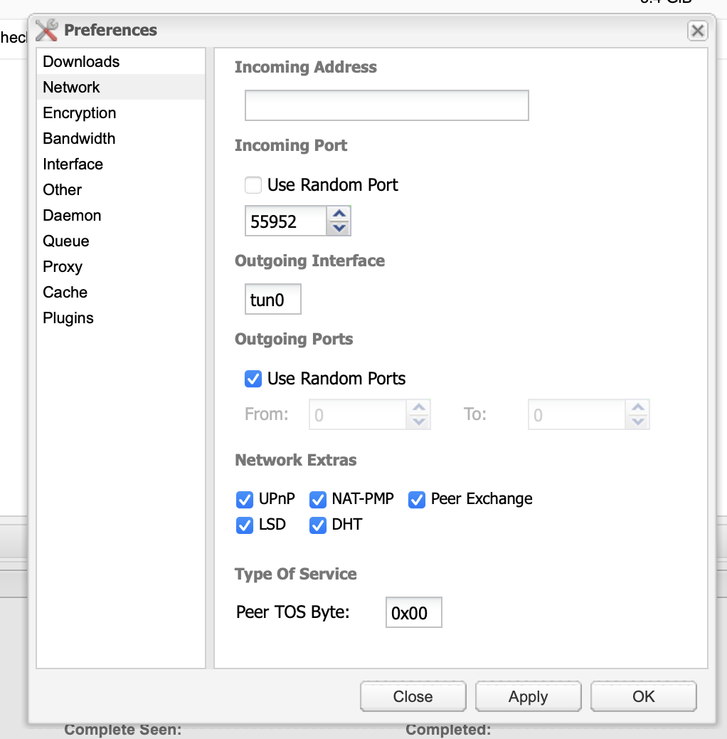

can you also post a screenshot of deluge web ui preferences/network
here it is
yes web ui ip at the bottom changes to my real ip, like you see in the other screenshots.
But ip in whatismyip.net is the vpn ip.
This must be a bug with how deluge detects your external ip address, it is clearly bound to the vpn adapter (as shown in your last screenshot - wg0) and it is advertising your vpn ip, as shown by whatismyip.net, on top of this there are strict ip table rules in place to prevent ip laakage, so there is no way for deluge to connect to peers via your isp connection.
FYI i cannot replicate the bug on my system, are you running the latest image?.
Yes, I'm using the latest image
If this is repeatable (which by the sound of the above it is), then restart the container, wait for the issue to occur and then docker exec inside the container and issue the following command which will reveal your external ip, it should be your vpn provider assigned ip:-
curl http://ifconfig.co
if it is your vpn provider ip then raise a bug with deluge, detail that you have the vpn provider adapter bound in deluge for 'outgoing interface' and the ip address of the vpn adapter defined for 'incoming address' yet the external ip address shown is your isp ip address and see what they say.

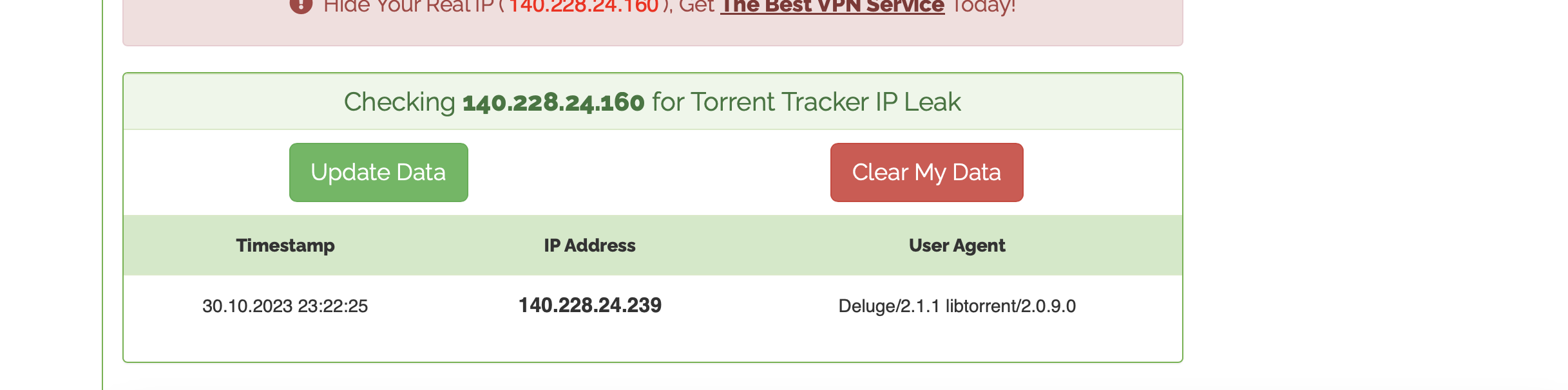

still showing the private ip on the web ui, but run the command that you suggested inside the container and it shows the vpn ip.
Also checked https://iknowwhatyoudownload.com with vpn ip shows stuff I downloaded and it doesn't show anything with my ip.
So I'm 100% confident that there has not been an ip leak.
Thanks for your help!
I will post in deluge forum and will let you know about what they say.

from my previous post:-
i see you included this in your post, ok he does go on about setting the incoming adapter but there is no way to do that, you can only set the incoming address, and if you try and force this by editing the core.conf it simply errors, so i dont know how to achieve this, it must be some hackery of libtorrent probably via itconfig i assume.
