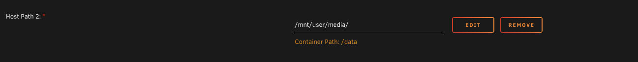

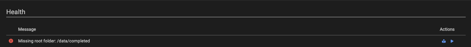

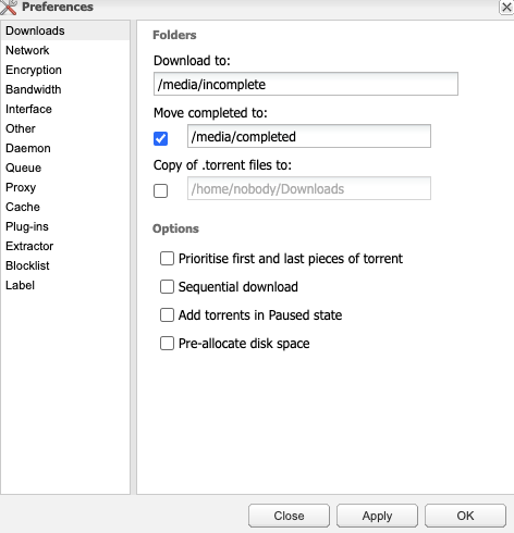

I recently changed the host path of my docker container and also changed in the deluge settings where the files that get downloaded go to, and now Deluge won't work for any new files. i have heard that changing the folders will do that.
History - i have been using Deluge alongside Radarr, and was getting a lot of alerts about it being an issue that my download client was sending to a root folder, so I switched it to a non root folder. Now it won't download. Also seeing in Radarr now that the I am missing a root folder.
What is the best set up to have?
