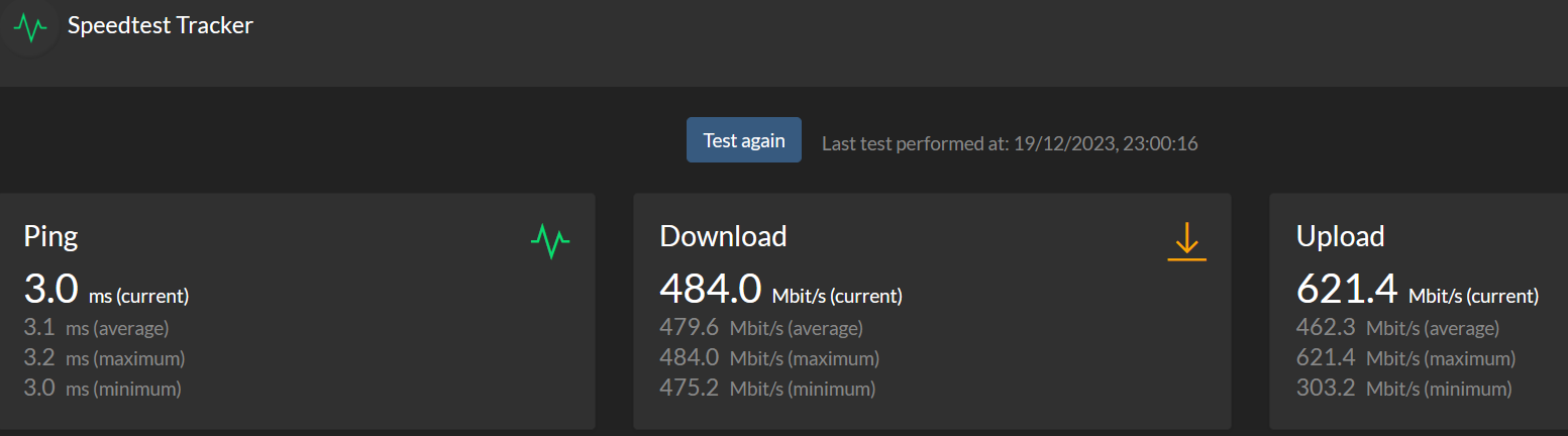

Hi All... I have just migrated my setup from a remote seedbox to using a local UnRAID server in a UK data centre.
I am not convinced I am getting the correct speed using the great Binhex - DelugeVPN docker.
My connection is around 500Mb/s up and down (confirmed using SpeedTest Tracker)...
My DelugeVPN download speed seems to be 10Mb/s-30Mb/s which is not as good as I would expect to see but my real issue is the upload speed seems very slow. I have seen it get to about 18-20Mb/s - but this was only for a few seconds and then it drops to a few kb/s...
I am using PIA VPN and have tried to find a list of endpoints which support port forwarding, but this doesnt seem to exist anymore and on their website it says using the desktop client settings to request end points which support port forwarding and if you try to connect to one which doesnt support port-forwarding it will warn you. So, as far as I know, Netherlands and France both support port-forwarding. So when I installed DelugeVPN, I copied the corresponding OVPN file, PEM file and Security Certificate for Netherlands to /appdata/binhex-delugevpn/openvpn folder. I tested the public IP from the container using
curl ifconfig.io
This proved the public IP corresponded to an IP address in The Netherlands.
When I realised that the speed was so slow, I carried out the same tests using the openvpn files for France and get the same results.
So, next step I tried was setting Container Variable VPN_ENABLED to 'no'. I checked that the docker's public IP was my actual IP and the DelugeVPN speeds remain really slow.
Am I missing something, or can someone offer some help in working out why the slow speeds?
I am sure that this should perform better than this so appreciate any help.
Thanks
its visible in the /config/supervisord.log file, check there for a long list of endpoints.
also check Q6 for suggestions on how to improve speed:- https://github.com/binhex/documentation/blob/master/docker/faq/vpn.md
10 minutes ago, SliMat said:
Thanks @binhex I will take a look, but as I get a similarly low speed when the VPN is turned off, I was wondering whether its a more generic configuration error rather than a VPN issue.
some of the possible causes in that faq are not vpn related, check them out.
Thanks - I am just working my way through the list and wanted to check my calculations... and the terminology in the FAQ you linked to. It says...
Upload rate set too high/unlimited - failure to correctly define your upload speed will mean your connection will be choked, resulting in low download speeds, the solution to this is to define your upload rate as about 3/4 of your theoretical maximum upload rate (keeping in mind this is defined in Bytes (big B) NOT bits (small b).
So, working on 1 Mbit/s = 125 KiB/s, so 500 Mbit/s connection speed = 62500 KiB/s - so would I be right in setting the "Maximum Download Speed (KiB/s)" and "Maximum Upload Speed (KiB/s)" in the Deluge preferences to 46875 (75% maximum). I'm just checking I havent got bits & bytes muddled up anywhere ;-)
LGTM

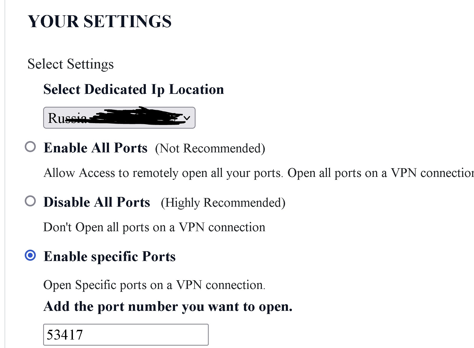

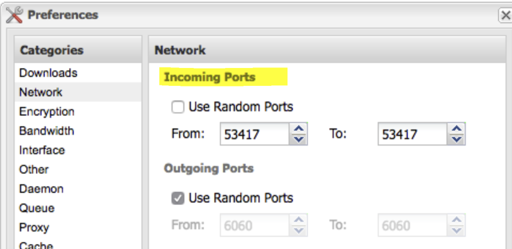

Hi Binhex,
can you please tell me if those settings are correct for port forwarding? Currently deluge runs fine without port forwarding (just not that fast).
But I would like to ask prior before I enable it.
1. Deluge internal settings:
2. VPN open port settings (not PIA):
