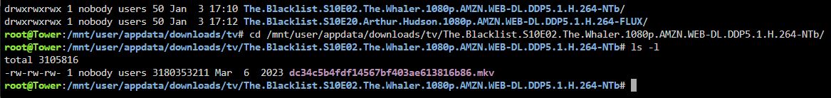

So i've been using this docker for years along with Sonarr. Recently, I noticed downloads from Deluge were not being picked up by Sonarr in my tv categories folder. I think I've narrowed down the issue to permissions on the actual files inside the download folders. I'm using a UMASK setting of 100 in the config so I'm expecting to see a rwxrwxrwx file permission but instead see rw-rw-rw-. When I checked NZBget or SABnzbd downloaded files with the same UMASK setting they show rwxrwxrwx and are imported correctly. Is this the correct diagnosis and if so, how do I fix it? Thanks in advance.
umask 001 = 776 which equates to rwxrwxrw- actually but in any case umask does not set the executable bit, so umask 000 = rw-rw-rw- you have to manually set the executable bit.
can i ask why you want to set your videos to executable? ;-)
I don’t know that I want too! I’m just trying to figure out why all of the sudden Deluge downloads aren’t being picked up by Sonarr? When I check Sonarr the downloads are gone from the queue and I (personally) can’t see anything in the logs indicating what happened? The only difference I could find between Deluge and the other download clients is the file permissions.
Edited by betaman
you may have a mismatched downloads folder, see Q4 for my attempt at explaining this:- https://github.com/binhex/documentation/blob/master/docker/faq/unraid.md
