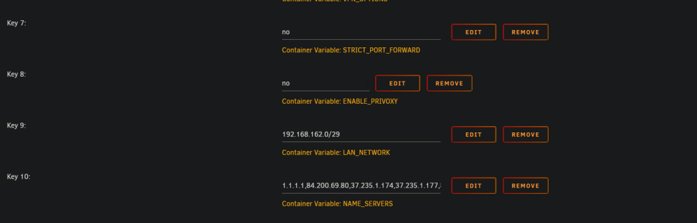

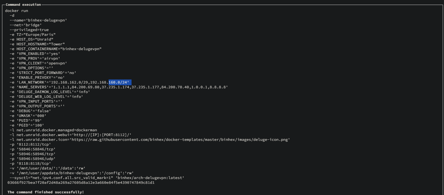

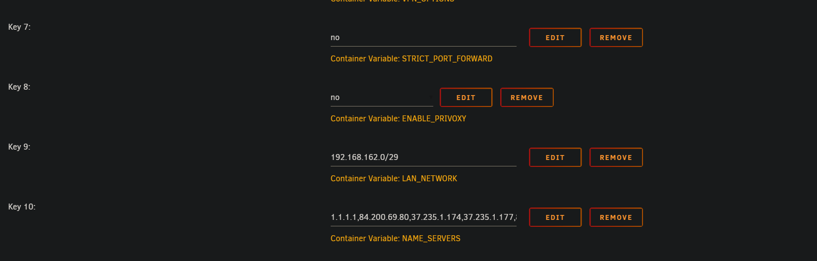

The problem i have now, is that when i add the ip scope, when it is succusfully changed in the docker container, it removes it from the list after i click done.
When i edit the docker, it is gone, why??
sorry i dont know what you mean, can you post some screenshots?

so you left clicked the deluge icon in unraid docker web ui and selected edit and then edited the Key 9 (LAN_NETWORK) right?, if not thats what you have to do, then click 'apply' at the bottom.
that is what i do, and when i press apply, it changes back to only that 1 ip address and does not show the one i added?
that is not normal, are you sue your usb key is ok?, keep in mind docker template config is stored on the usb key, so if the key is corrupt then you may start seeing weird issues such as this.
try temporarily saving another change for another container, does this stick or does this also revert back?.
funny thing, my usb is saying it failed read/write, already ordered new usb.. it is buggy, maybe it was that thing that caused all my other small issues i have...
ha there a go!, def the cause.
