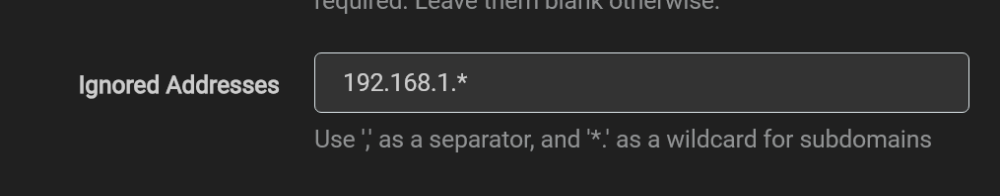

The last thing to also check is that you are bypassing proxy for local addresses for the other containers (sonarr etc), screenshot:-
this is from my server, change the ip to 192.168.0.* for your setup.
13 minutes ago, binhex said:
Are the other containers (sonarr etc) set with ip's in the defined LAN_NETWORK? as in 192.168.0.xxx?
The other question is have you changed the ip you are using in the other containers (sonarr etc) to use <ip of your unraid server>:8118?
Containers all on same network (192.168.0.x)
Did change the IP of other containers to use the Unraid_IP:8118 when I had set it to bridge. Didn't work as I said. Also tested with my Desktop where I just configured proxy settings in a browser. When on bridge mode, it doesn't work - firefox just times out. When its set to the static IP ( the 111 ) then it works without issue.
Just checked for bypassed addresses and no, its blank at the moment, but I do have the "Bypass Proxy for Local Addresses" checkbox enabled which I assumed did the same thing. Just tested by adding my range and it still doesn't work.
