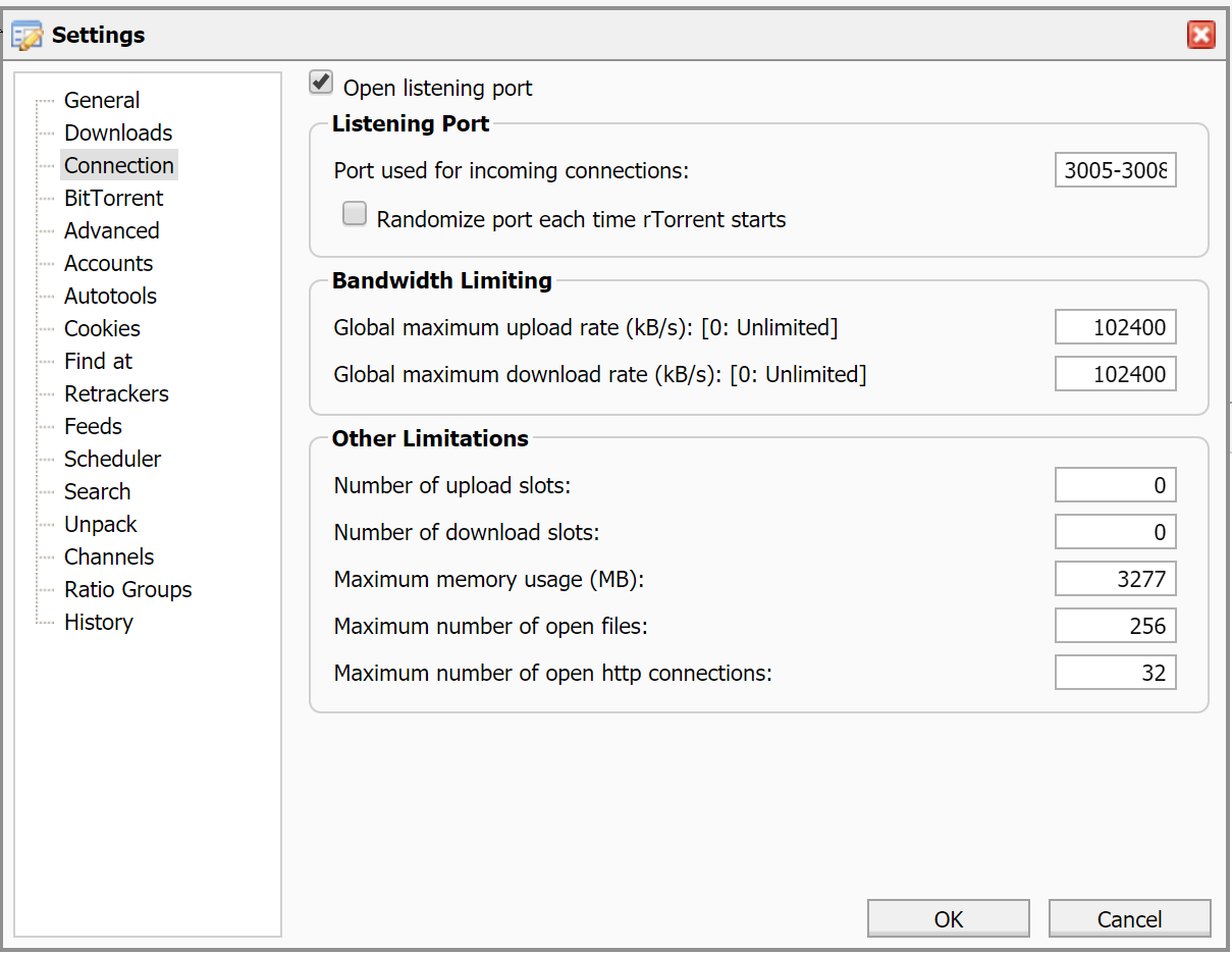

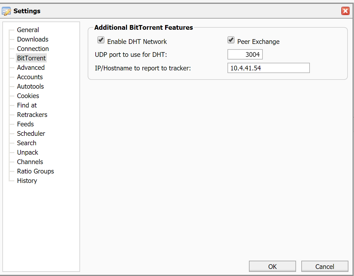

I already set in the rtorrent UI the Incoming Ports of 3004-3008.  But, it is still reported as "not connectable".  With PIA, you do a search and set the port.
It seems that ports I set are resetted at each start of the docker (they don't stick).  Is there a trick to make them stick ?
Here is my settings, but if I restart the docker, they go back to default.
contrary to popular belief, rutorrent does NOT set any settings for rtorrent, at least not permanently, the only settings that will "stick" are settings for rutorrent (as in the web ui), if you want to modify rtorrent settings and have them be persistent you will need to crack open your favorite text editor (for the love of god dont use notepad) and set it manually and save, the config file should be in the folder /config/rtorrent/.
