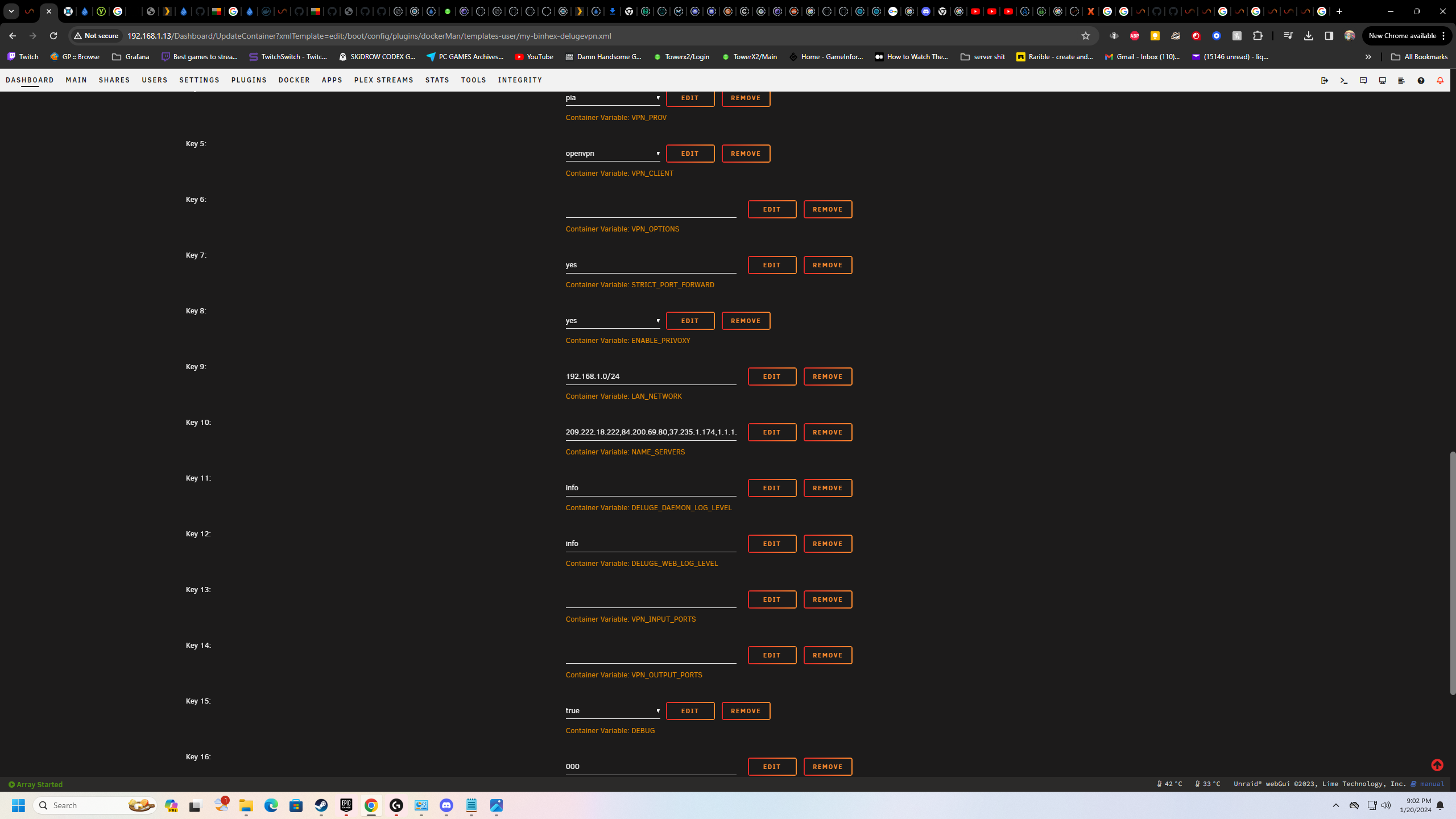

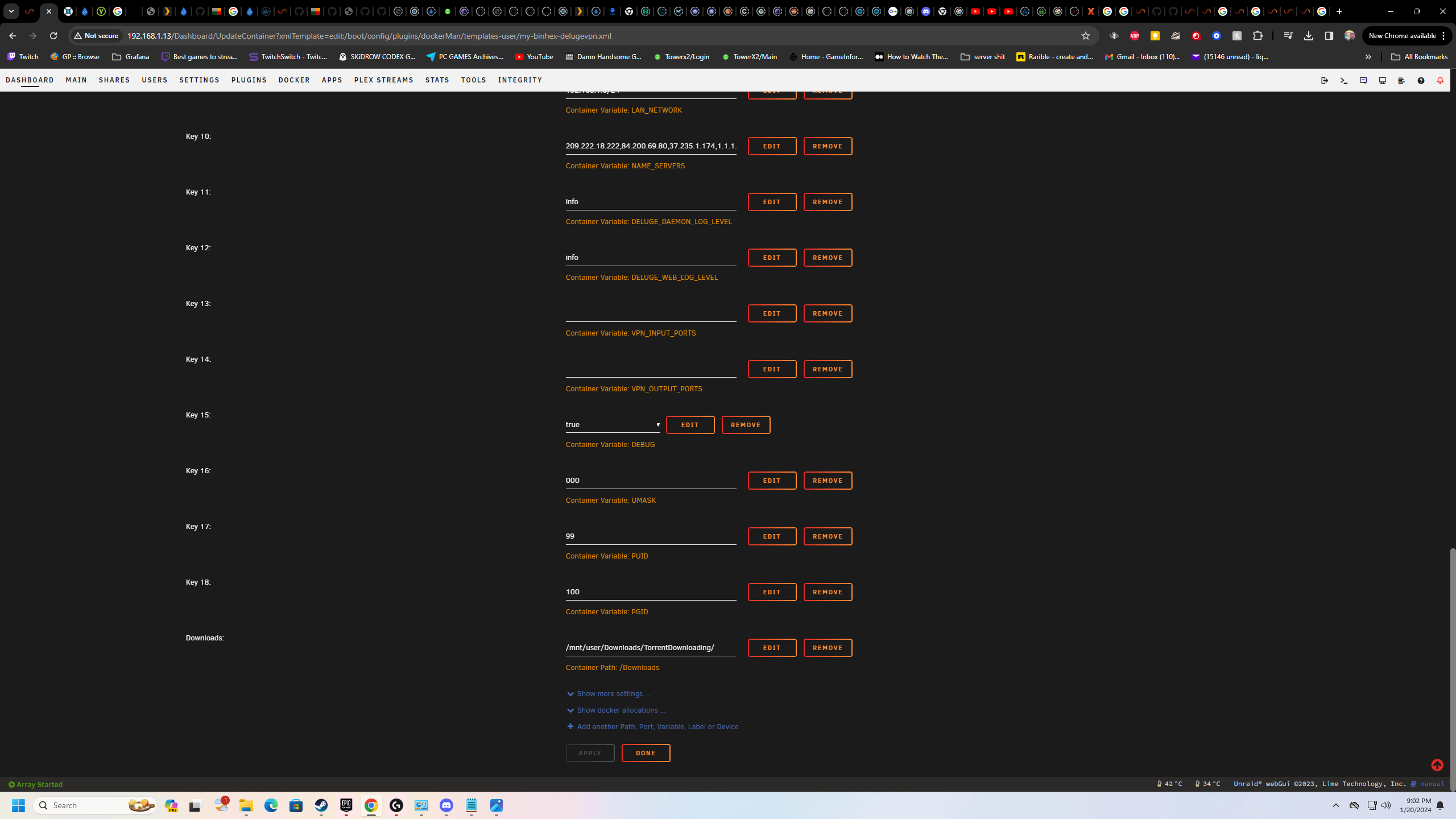

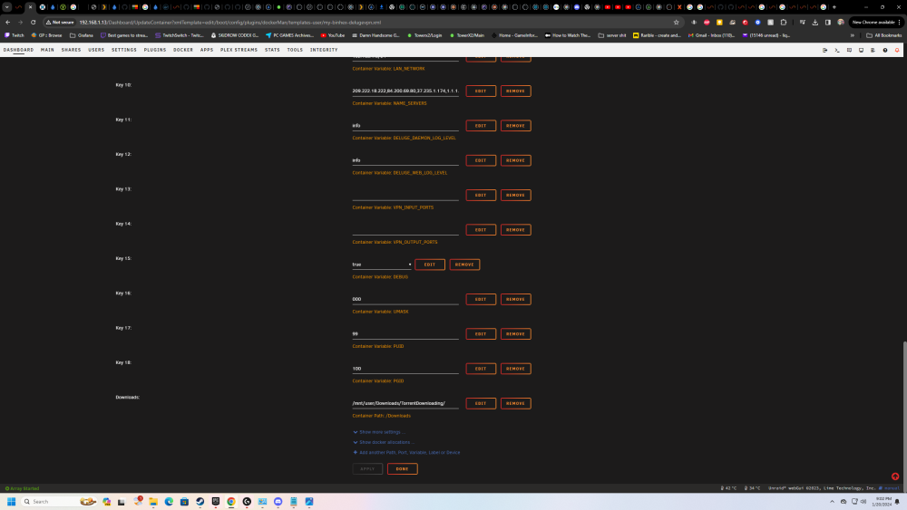

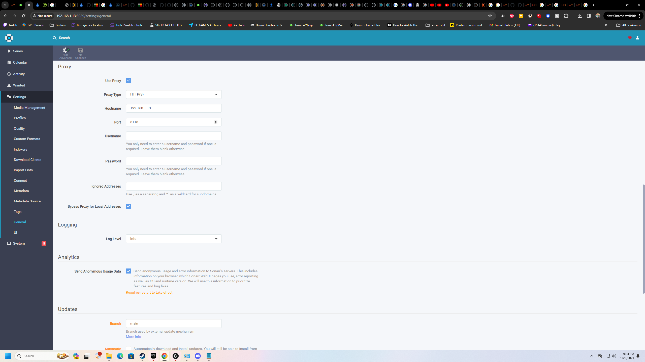

Been having a heck of a time. I had all of this running smoothly until I lost my cache pool during a power outage. So in the process I upgraded the sytem at the same time and have been trying to get everything back to the way it was.  First I was losing User share when attempting to run plex on ram with it setup on the old config. Then it turned out a few of my appdata folders had made it onto the array at one point and needed deleting. Now I cant get any of the containers arr containers to use the vpn any longer.
I can get deulge running on the vpn no problem. When I try and run any of the arr containers through it they seem to work as far as being able to use the gui, but can no longer talk with any of the other containers?
I went though the logs as best I could and corrected a few of the errors and changing settings including:
iptable_mangle was missing ran some commands and no longer get this error.
tried changing port to 8119
a couple other things I cannot remember as its been a wild few days of tracking down errors from the move etc.
here is my log, I've gone through and exhausted everything I can think of.
Thank you kindly for any help anyone can provide.
supervisord.log
Edited by Liquidbings

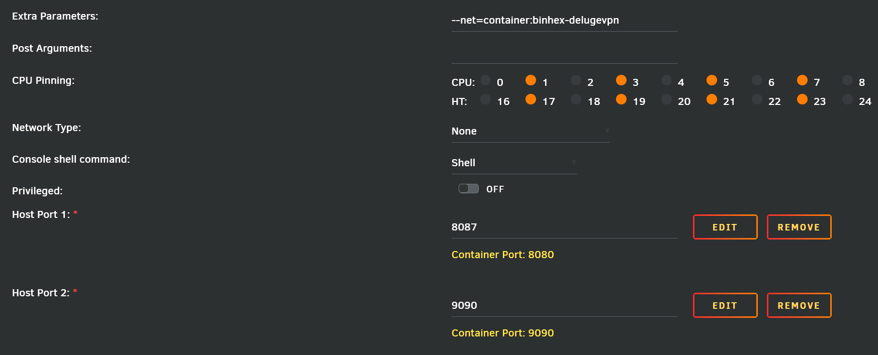

I'm sure this has been covered in these 400 pages, but for the life of me I cannot get my exact situation to work.  I followed SpaceInvaderOne's guide and setup the -arr's to all run through the delugevpn container which works great.  I am now trying to setup Sabnzbd but not have it run though the vpn.  I cannot get any of the -arrs to add it as a downloader.
I have added both 8080 and the mapped ports from Sabnzbd in the VPN OUTPUT PORTS in the Deluge-vpn container
I have tried using localhost, my server ip, and the container ip for Sabnzbd with all 3 of the ports (8080 and the 2 mapped inside of Sabnzbd) and nothing will allow Sonarr, Radarr, or Prowlarr to connect to it and add it as a downloader.
Thoughts?
Thanks all!

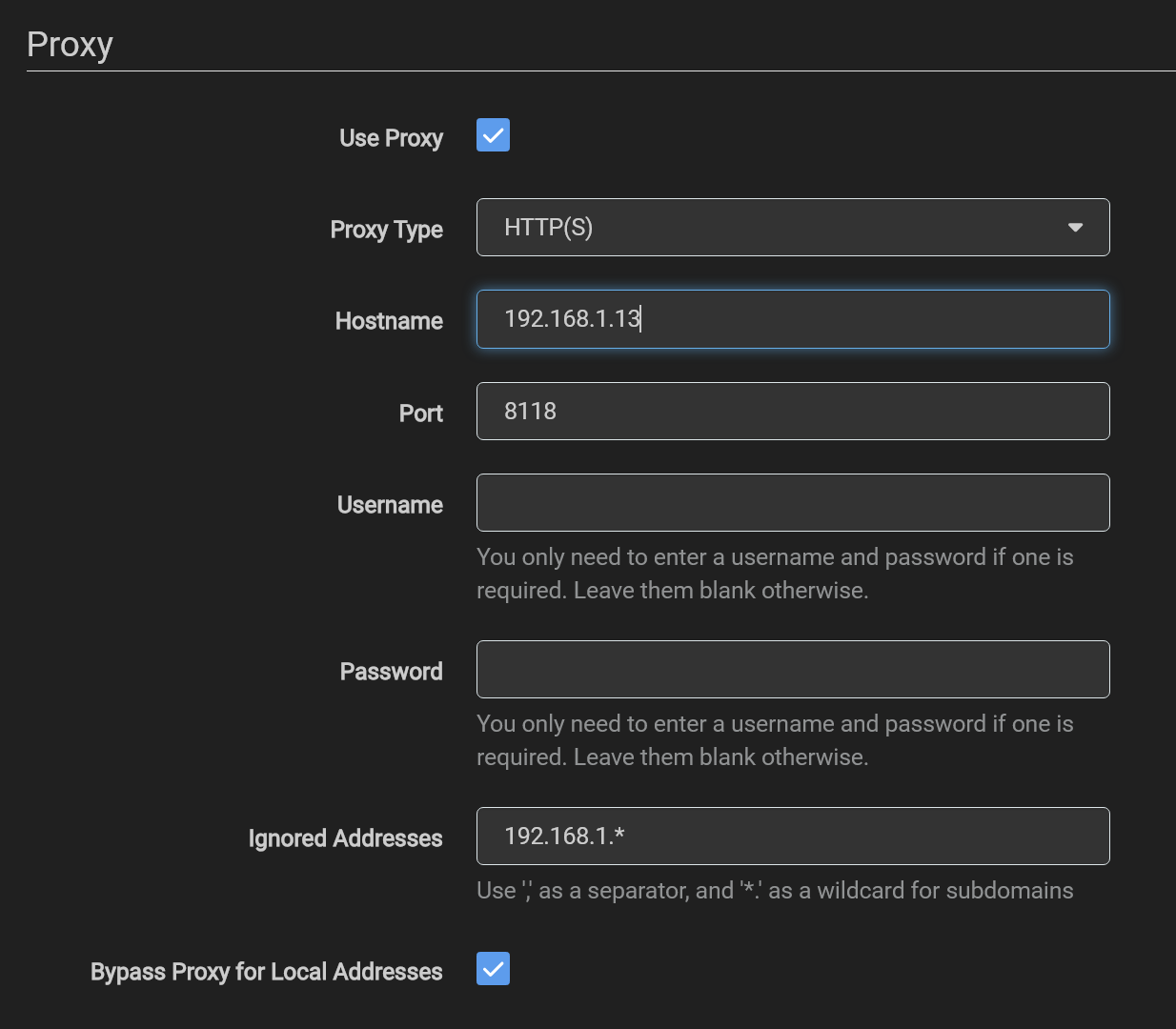

the missing part is you need to bypass the proxy for local addresses and also define 'Ignored Addresses', example:-

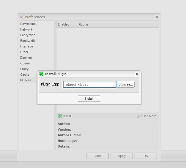

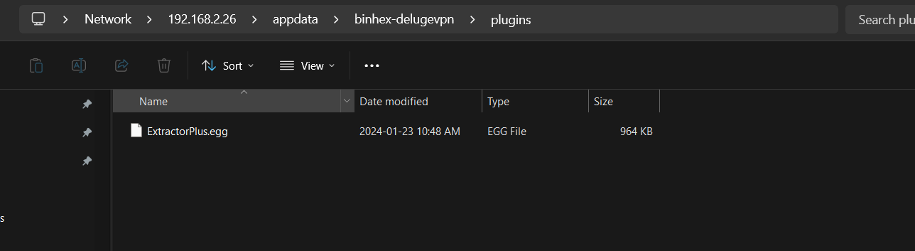

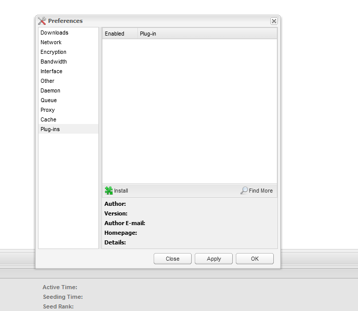

Hi, This is probably covered in these 400 pages but how can I install plugin from the UI?
Python version 3.11.5 (downloaded the egg based on this version)
config is mapped to `/config/mnt/user/appdata/binhex-delugevpn` in docker template
Things I tried already.
1) Placing the egg in the plugins folder of appdata/binhex-delugevpn/plugins. Then restarting the docker.
Still Empty
2) Click on Browse and Install in the UI - but it just do this
Any suggestions?
Edited by shivam183

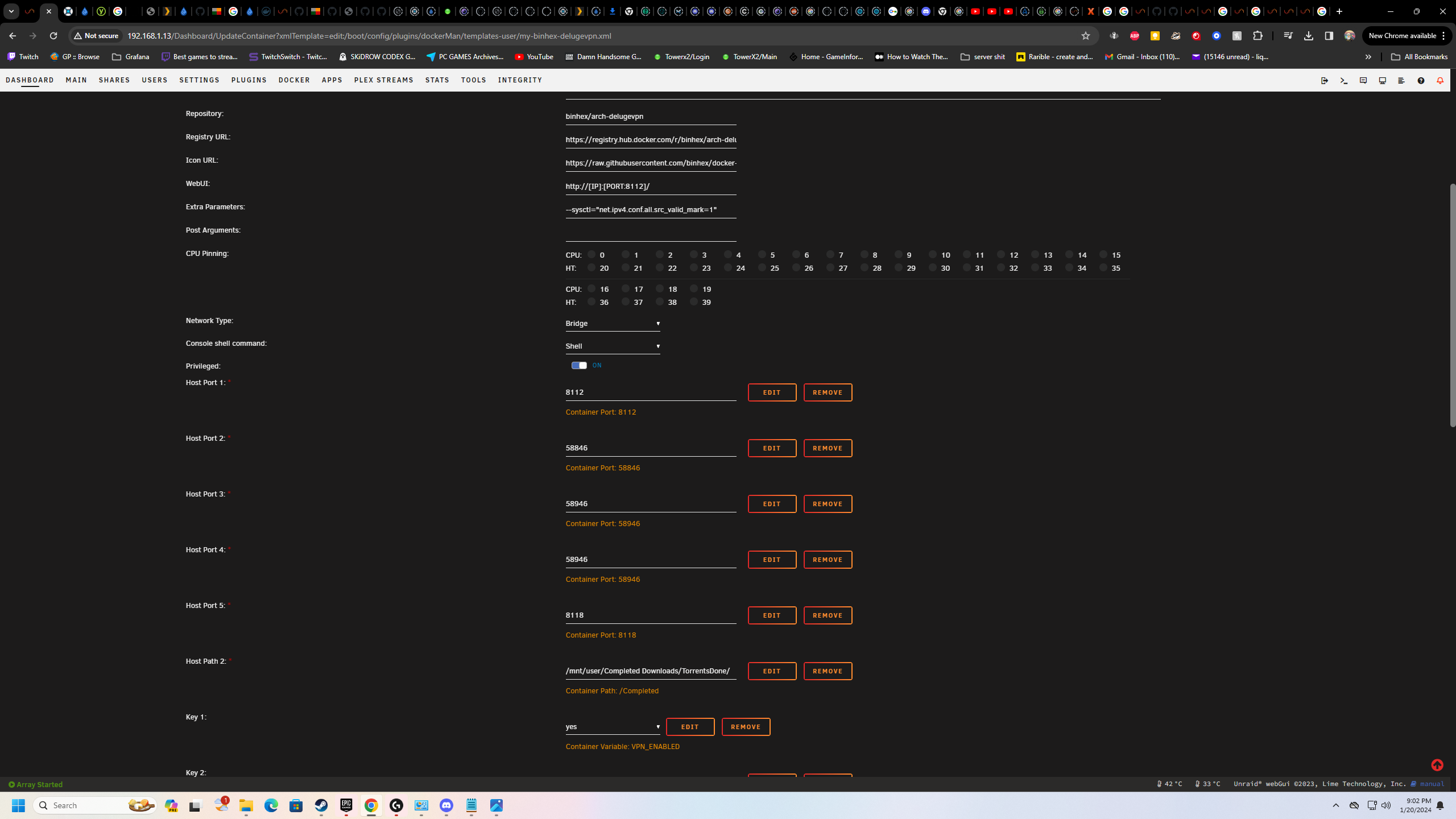

Just noticed my container wasn't running.  When starting it throws an error "Execution Error - Server Error".  Using PIA and fireguard.  was working fine.  Last log was from Jan 23rd.
UnRaid Logs show the following
Jan 30 12:00:04 HomeServer kernel: docker0: port 7(veth07cd363) entered blocking state
Jan 30 12:00:04 HomeServer kernel: docker0: port 7(veth07cd363) entered disabled state
Jan 30 12:00:04 HomeServer kernel: device veth07cd363 entered promiscuous mode
Jan 30 12:00:04 HomeServer kernel: docker0: port 7(veth07cd363) entered forwarding state
Jan 30 12:00:04 HomeServer kernel: device veth07cd363 left promiscuous mode
Results from changing the config and saving
docker run
  -d
  --name='binhex-delugevpn'
  --net='bridge'
  --cpuset-cpus='2,3'
  --privileged=true
  -e TZ="America/New_York"
  -e HOST_OS="Unraid"
  -e HOST_HOSTNAME="HomeServer"
  -e HOST_CONTAINERNAME="binhex-delugevpn"
  -e 'VPN_ENABLED'='yes'
  -e 'VPN_USER'='pxxxxxxxx '
  -e 'VPN_PASS'='xxxxxxxxxxxxxxxxxxxxxxxxx'
  -e 'VPN_PROV'='pia'
  -e 'VPN_CLIENT'='wireguard'
  -e 'VPN_OPTIONS'=''
  -e 'STRICT_PORT_FORWARD'='yes'
  -e 'ENABLE_PRIVOXY'='no'
  -e 'LAN_NETWORK'='10.0.1.0/24'
  -e 'NAME_SERVERS'='1.1.1.1,1.0.0.1,10.0.1.1'
  -e 'DELUGE_DAEMON_LOG_LEVEL'='info'
  -e 'DELUGE_WEB_LOG_LEVEL'='info'
  -e 'VPN_INPUT_PORTS'=''
  -e 'VPN_OUTPUT_PORTS'=''
  -e 'DEBUG'='false'
  -e 'UMASK'='000'
  -e 'PUID'='99'
  -e 'PGID'='100'
  -l net.unraid.docker.webui='http://[IP]:[PORT:8112]/'
  -l net.unraid.docker.icon='https://raw.githubusercontent.com/binhex/docker-templates/master/binhex/images/deluge-icon.png'
  -p '8112:8112/tcp'
  -p '58846:58846/tcp'
  -p '58946:58946/tcp'
  -p '58946:58946/udp'
  -p '8118:8118/tcp'
  -v '/mnt/user/media/download/':'/data':'rw'
  -v '/mnt/user/appdata/binhex-delugevpn':'/config':'rw'
  --sysctl="net.ipv4.conf.all.src_valid_mark=1" 'binhex/arch-delugevpn'
b77739803819047075ee5aaf25756fab10fe619a6f776ff54d5c8cb8c5ad627e
docker: Error response from daemon: driver failed programming external connectivity on endpoint binhex-delugevpn (2cc0c7c031cb9b1bb7e5a5747b9b4eee2b39e25be783702ab6896bb14d6c209c): Error starting userland proxy: listen tcp4 0.0.0.0:58846: bind: address already in use.
Edited by Flyinace2000
docker thinks the port is already in use, so either you have another container running with that port (if so stop it), or docker is having a senior moment (it happens), try a reboot of your server.
That's what I thought as well.  I manually checked and nothing else is using those ports.  I'll try a reboot.  Thanks!
Reboot fixed it.  Very strange.

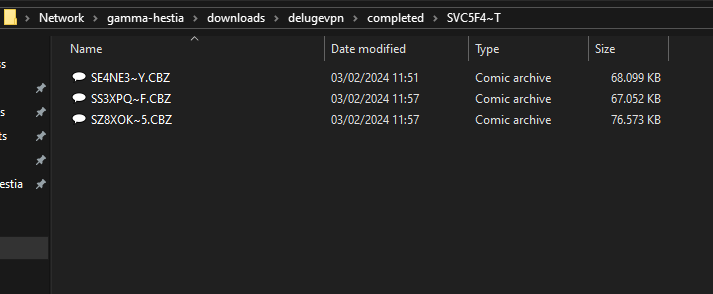

Anything with illegal Windows characters shows up like this in Windows, anything I can do to have illegal Windows characters omitted automatically?
