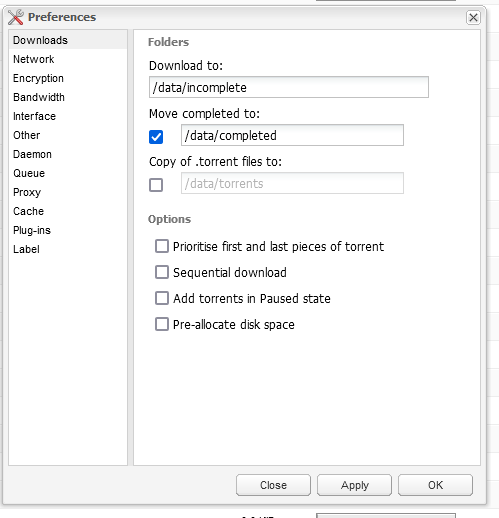

I'm going insane trying to figure out why downloads get stuck in 'Queued 100%' forever.  Any ideas?
My plex is hosted on a separate server, so the plex share is a SMB mounted share. I've confirmed no user/password on the share, and added every user under the sun to the permissions to be safe. I can confirm I can see the plex folders from the container cli.
check deluge settings, downloads.  the path is the container path not the actual path.           /data/incomplete

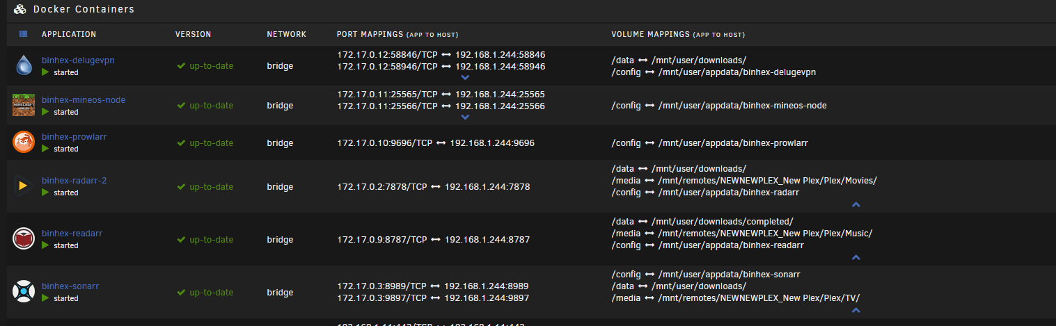

Is what I have in deluge; files move fine to the incomplete/completed folders but then just sit there. Stuck at Queued 100% forever.
