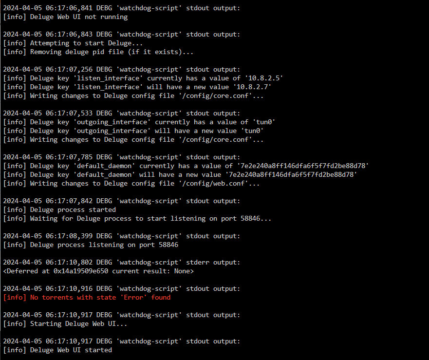

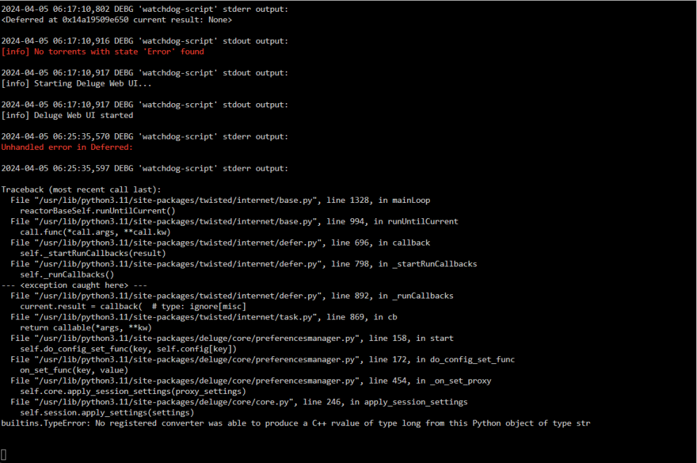

I seem to have the same issue as Dazedv3 a fest posts above, but it's also the deluge webui that is inaccessible (and also after container restart...)

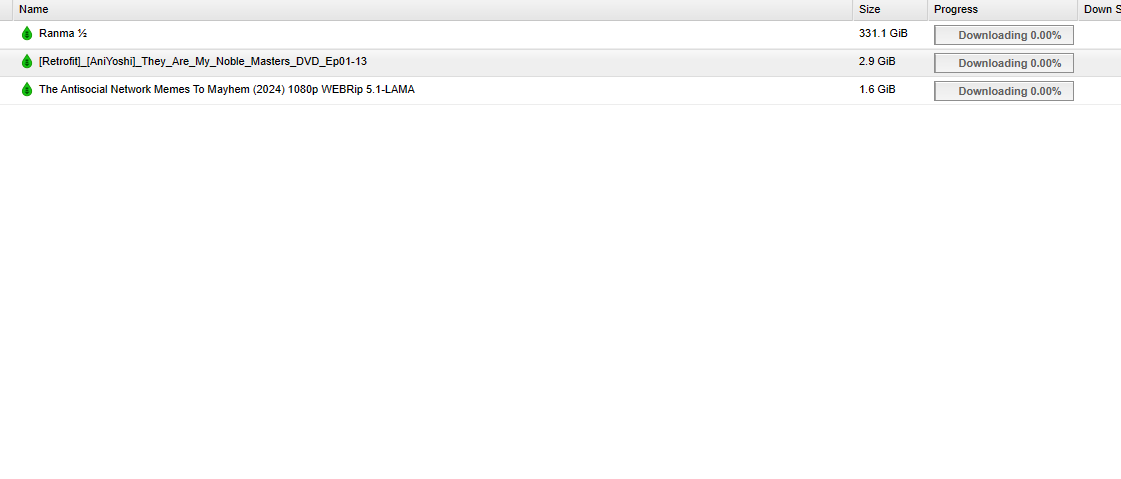

I recently started using the delugevpn and my torrents wont start downloading at all. When I look at my logs i view this. did i miss something? image.thumb.png.d64e2b585a9c378ae396025d24ec8ea1.pngimage.thumb.png.e71d02d0132fc68ea4498c42c0ac6f5f.pngimage.png.98d96b0a2b99d5420ba261f8b1182be6.png
Edited by animeking1987
