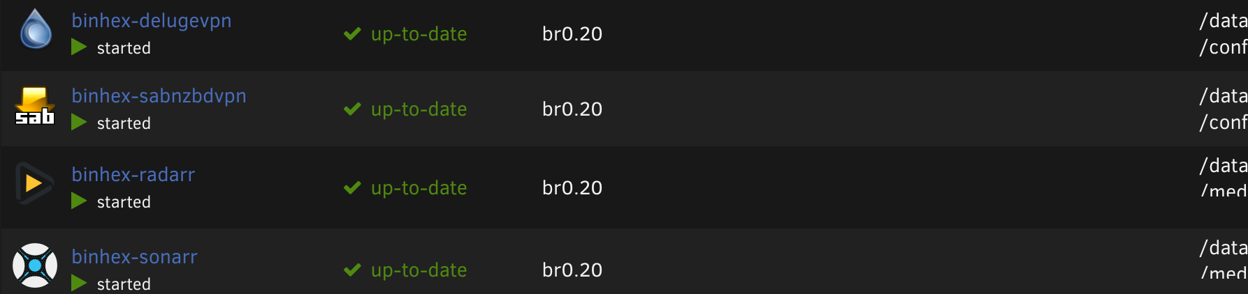

I’m encountering an issue with my DelugeVPN (using NordVPN) and ARR (Radarr/Sonarr) setup that was functioning correctly until earlier this week. I have Deluge and the ARR applications running in VLAN 30, each with its own IP address on Unraid. These applications connect directly to each other via their 10.30.x.x IP addresses. Deluge is also configured behind a reverse proxy for WebUI access.
The problem is that I can no longer access Deluge WebUI through its URL, nor can Radarr/Sonarr connect to Deluge using its 10.30.x.x IP address. However, I’m still able to access Deluge from my desktop on VLAN 10 by using its 10.30.x.x IP address, but not via the URL. Seems like Radarr/Sonarr can ping it as well and it can ping Radarr/Sonarr as well.

On 8/12/2024 at 10:04 AM, Mlatx said:
All my dockers use custom IP's
Try setting this container to bridge and use the server IP.
Something is broken with the container. I use fixed IP's on all my dockers without issue. This one worked correctly up until a month ago. Something broke in a recent update where the webui link doesn't work. It works under bridge mode but does not work under a custom network with fixed IP, which it did for the past couple of years.
