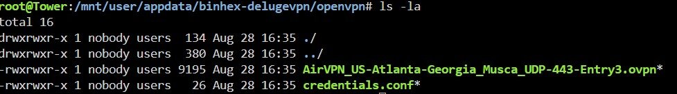

I have made progress of a sort. I cleared the docker, reinstalled, pulled the oven cinfig files again. I noticed in the log file it saying somthing about my password having characters that could cause issues authenticating, so I changed my VPN password too.
I have no idea what made the difference, but it loaded up with the VPN happy and I was able to download Ubuntu. I had my laptop open too and was browsing around and all seemed fine. For about 10 minutes. Then I lost DNS service for everything on my network except the unraid machine. Through the command prompt in unraid I can ping www.google.com so I assume it's DNS is working fine.

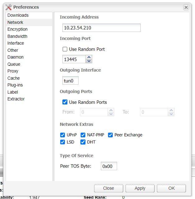

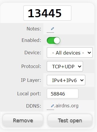

I had DelugeVPN working just fine. I downloaded 2 to 3 dozen torrent files without issue and plenty fast.
All of a sudden I have dropped down to maybe 9 KiB/second
This is not a VPN location issue and I'm not even sure it's a VPN issue considering that I logged into AirVPN from my laptop to download a torrent and it was fast. I used that same location to create a single site config file on AirVPN and loaded it into deluge openvpn folder.
Maybe something is wrong with my attempt at port forwarding. Not 100% certain.
I have attached several documents.

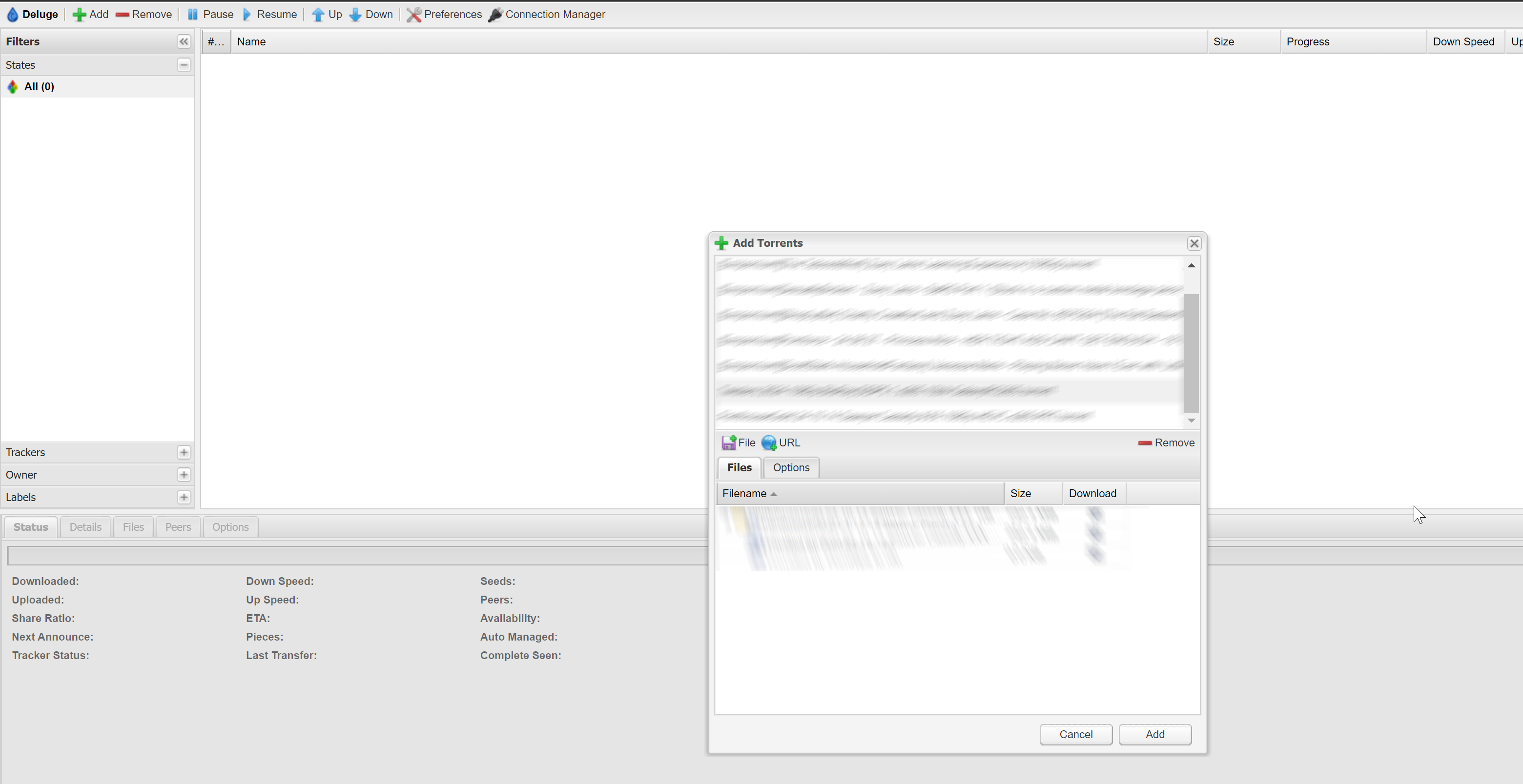

Is there any fix for the broken "add torrents in the web UI? Previously it was possible to add multiple torrents at once but seems to no longer work.
i've seen the same issue since around May, same issue in multiple browsers, i've rebuilt the container since then too and still have the issue so it doesnt seem like a config problem.
I'm assuming most other people add files differently, I've resorted to using a monitored folder but its a pain when i want ignore some parts of the download.

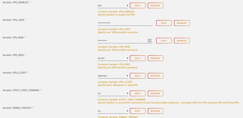

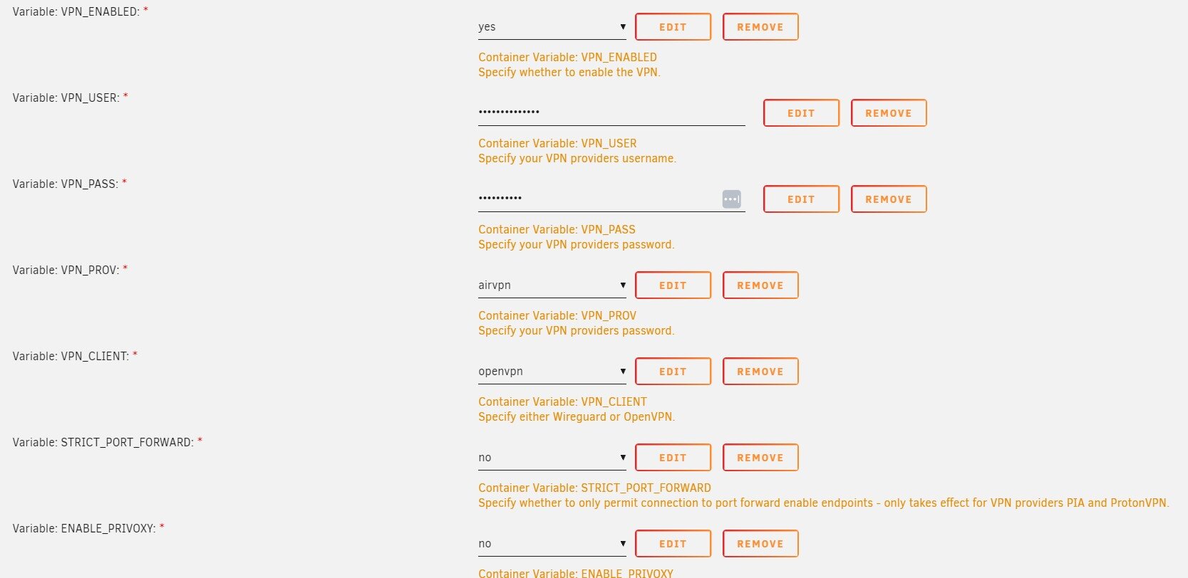

Been using this container for quite some time and it has been great. I really like it. Recently I have something odd happening and I cannot resolve it. The container doesn't appear to bind to an IP even when configured to do so.  The logs show no issue and it appears to be running. Anyone have an idea what I might be missing?

15 hours ago, auth100488 said:
I mean, I could try and torrent through the actual vpn on a vm but it seems odd that hide.me would limit the bandwidth for paid customers.
You need to check if your vpn provider offers port forwarding and then open up a port and put that port as the incoming port in Deluge. Torrenting without an open incoming port will always be slow.

For some odd reason I can only add one torrent file at a time. When I try to bulk add more than one file and click the add button, nothing happens. But if I choose only one file, it adds it no problem. This problem has persisted for a while. The docker is up to date. The OS is latest. I've tried multiple browsers.
Anyone seen this before and if so is there a fix? Thank you!
