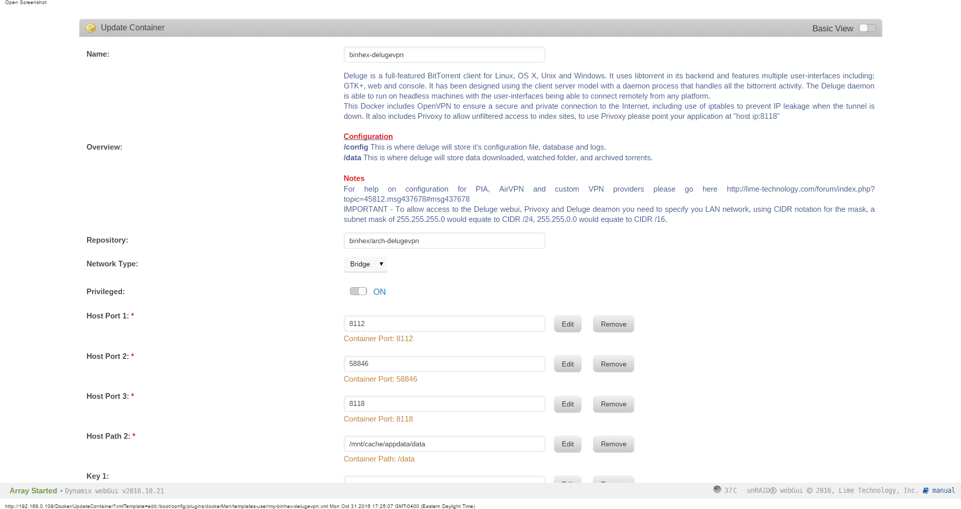

Hi guys.  I'm trying to get this running and I think I have a conflict with binhex-sabnzbdvpn.  When I try to install delugevpn I get an error
docker: Error response from daemon: failed to create endpoint binhex-delugevpn on network bridge: Bind for 0.0.0.0:8118 failed: port is already allocated.
It appears sab is also using this port as shown in 'deployed ports"
binhex-sabnzbdvpn 8080 8090 8118
binhex-delugevpn  8112 58846 8118
I don't know enough about how virtualization works to know what this port is used for and if I can change or remove it.
I do have ENABLE_PRIVOXY=no in deluge as mentioned earlier in this thread.
Looks like you have port 8118 defined in both dockers?  Did you try changing one of them?  I think you only need the first two for each anyway.
I did not try changing anything yet.  Both dockers installed with that port mapped (container=8118, host=8118).  If this port is not needed would I just remove the setting ("Remove" button)?
The Host Ports on my binhex VPN dockers match yours (the first two ports) but neither is using 8118.  Is it mapped as an additional port?  Maybe try deleting your config and pulling the latest docker.  Just take a screenshot or something of the advanced view tab for each.
The docker installed with 3 ports.  This was done earlier today so I believe it is the latest version.
I removed the 8118 port and it installed, stared, and seems to run without issue.
Thanks for the help!
8118 is for the proxy over vpn feature binhex added.
Yeah, just noticed that. Would it make sense to use different ports as defaults for each docker?
No. There is no need or benefit for a typical user running multiple instances on different ports. Only one privoxy should be running at a time, no matter how many of binhex's VPN enabled containers you are running.
