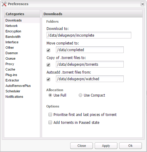

so what is the path you have defined in deluge for completed stuff? if its NOT in /data or a subfolder of data then it will just move the completed download to somewhere else inside the container, you need to stop all downloads until this is straight.
see attached screenshot for how i have mine configured, note how ALL paths start with /data.
