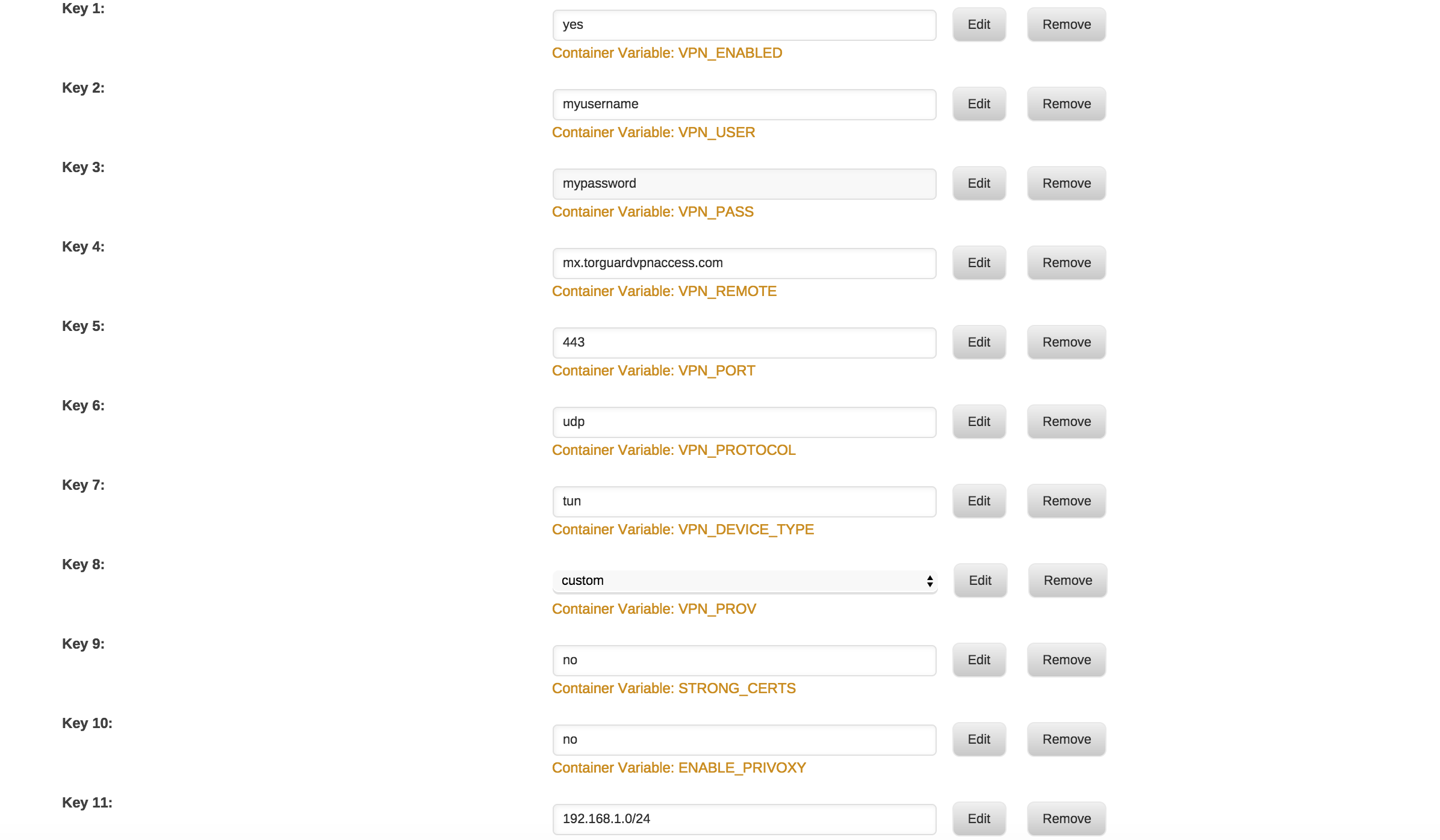

The only thing I can see in your settings that is different from when I first had this problem many moons ago is
Key 10:  no
Container Variable: ENABLE_PRIVOXY
was set to
Key 10:  yes

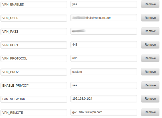

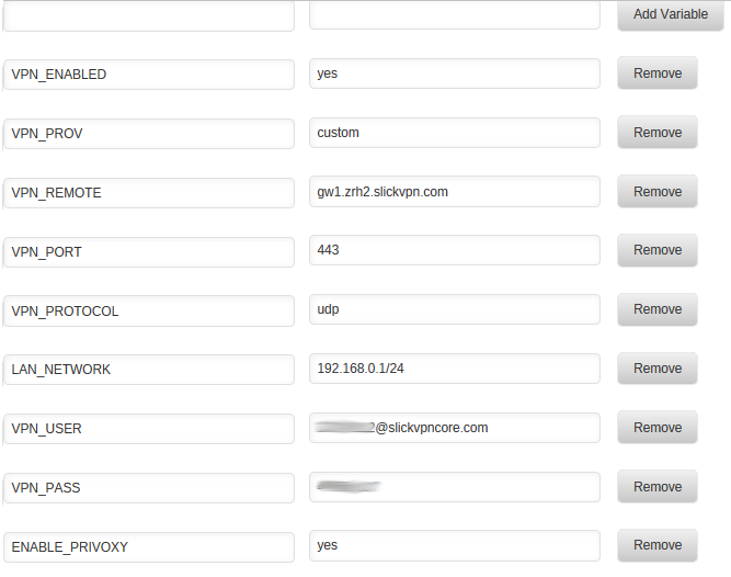

I wonder if anyone can help, i'm trying to set this up with SlickVPN but having no luck  :( i believe I've entered all the settings correct and placed the ovpn file in the correct place but no matter what i do or change i cant get the web ui to load so i guess I've done something wrong i cant see.
gw1.fra2.slickvpn.com.txt
supervisord.txt
That screenshot is completely different to the supervisord.log can you update it please
Sent from my SM-G900F using Tapatalk
hmm odd. Ok so i deleted the old supervisord log and took a fresh screenshot of my settings just before starting the docker which generated this supervisord.log. Hopefully those match now
supervisord.txt
looking at the log i would say its failing to authenticate with the vpn provider due to missing cert(s) or problems reading the inline cert in the ovpn file, line from log:-
Fri Dec 30 17:25:06 2016 Cannot load CA certificate file [[iNLINE]] (no entries were read)
at a guess i would say your ovpn file is corrupt in some way and thus the inline cert is stuffed, re-download the ovpn file from the provider and overwrite the existing.

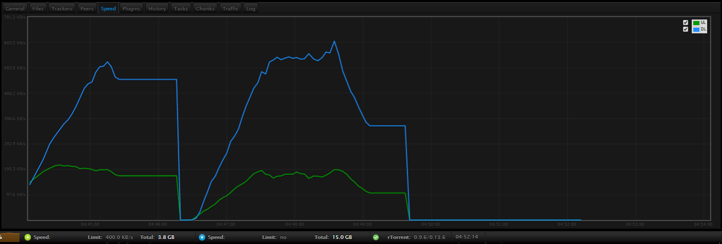

Both my Deluge and ruTorrent are using AirVPN
Deluge seems to be fine, rutorrent on the other hand.....
Its start, download for a bit stop, wait, download for a bit, stop - over and over
here is a snip I just made of the speed graph from rutorrent - I am not maxing out my 20MB DSL .....
Ideas?  It was fine until I moved and went from cable to this dsl - dsl is all that is avail here
Myk
I would guess your upload rate isn't restricted, try also restricting your upload to about 80% of Max upload, for a standard adsl2 line that would be about 50KB/s you will notice download rate should stabilise and the VPN won't drop (assuming speed drop to zero is VPN dropping due to upload starvation)
Giving that a try
Thanks
Myk

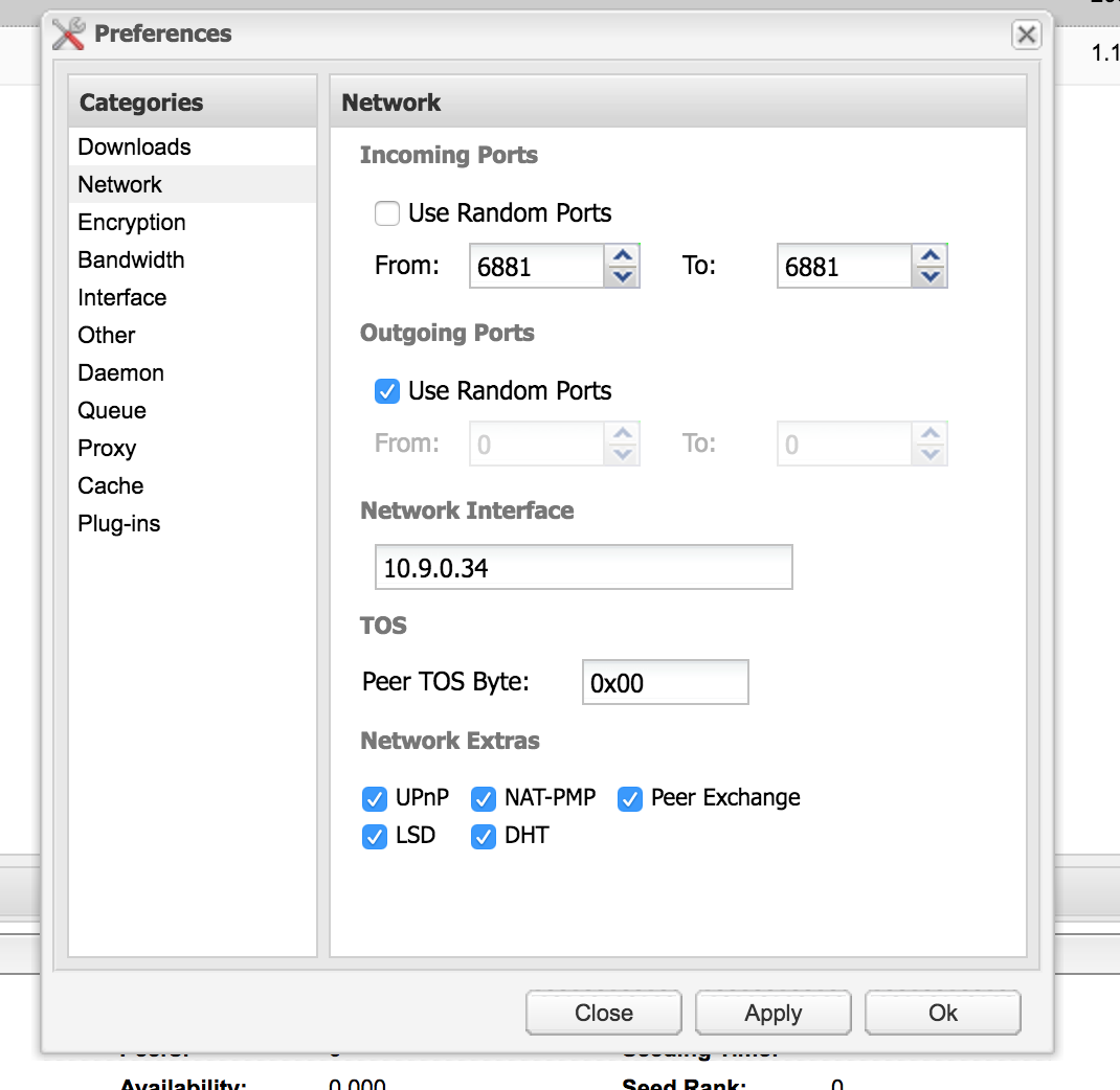

i followed the instruction and have set it up with torguard as the vpn provider. I am able to bring up and access the webui. However,  the download never starts due to "Tracker Status:
checkmytorrentip.net: Error: Connection timed out". any help would be much appreciated.
following is the latest log
