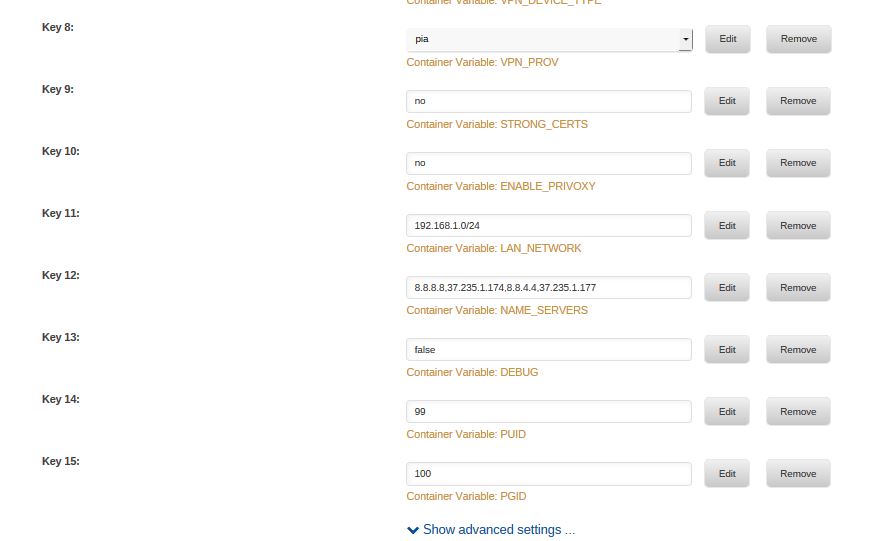

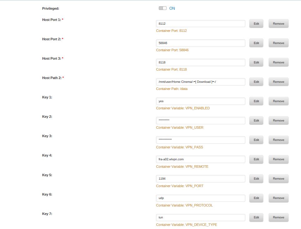

Can't access webUI - unraid 6.2.4
Hello, I can't access the Webui with the 8112.
First, I've created /config/Openvpn folder where I put my ovpn + crt files.
You'll find my parameters and logs below :
-> Logs

-> Parameters : into the picture attached
Could you please help me?
Thanks
You have the VPN_PROV (ider) set to "PIA". If you are using PIA then change your VPN_REMOTE to a PIA one, otherwise change VPN_PROV to 'custom'.
OK, I change to custom :

New issues :)

could you please post the entire supervisord.log file, it looks like this is missing the all important top section of the log, what vpn provider are you connecting to btw?.
Thanks for your reply.
My VPN provider is usenetserver.
ovpn file :
client
proto udp
dev tun5
remote fra-a01.wlvpn.com 1194
resolv-retry infinite
nobind
persist-key
persist-tun
persist-remote-ip
#ca vpn.crt
tls-client
remote-cert-tls server
comp-lzo
verb 3
auth SHA256
cipher AES-256-CBC
Supervisor log :
2017-01-16 08:23:54,028 DEBG 'start-script' stdout output:
[warn] Password contains characters which could cause authentication issues, please consider changing this if possible
2017-01-16 08:23:54,079 DEBG 'start-script' stdout output:
[info] Default route for container is 172.17.0.1
[info] Setting permissions recursively on /config/openvpn...
2017-01-16 08:23:54,082 DEBG 'start-script' stdout output:
[info] Adding 8.8.8.8 to /etc/resolv.conf
2017-01-16 08:23:54,089 DEBG 'start-script' stdout output:
[info] Adding 37.235.1.174 to /etc/resolv.conf
[info] Adding 8.8.4.4 to /etc/resolv.conf
[info] Adding 37.235.1.177 to /etc/resolv.conf
2017-01-16 08:23:54,108 DEBG 'start-script' stdout output:
[info] Adding 192.168.1.0/24 as route via docker eth0
2017-01-16 08:23:54,108 DEBG 'start-script' stderr output:
RTNETLINK answers: Operation not permitted
[info] ip route defined as follows...
[info] Starting OpenVPN...
2017-01-16 08:23:54,483 DEBG 'start-script' stdout output:
Mon Jan 16 08:23:54 2017 OpenVPN 2.3.12 x86_64-unknown-linux-gnu [sSL (OpenSSL)] [LZO] [EPOLL] [PKCS11] [MH] [iPv6] built on Aug 24 2016
Mon Jan 16 08:23:54 2017 library versions: OpenSSL 1.0.2j 26 Sep 2016, LZO 2.09
Mon Jan 16 08:23:54 2017 WARNING: file 'credentials.conf' is group or others accessible
