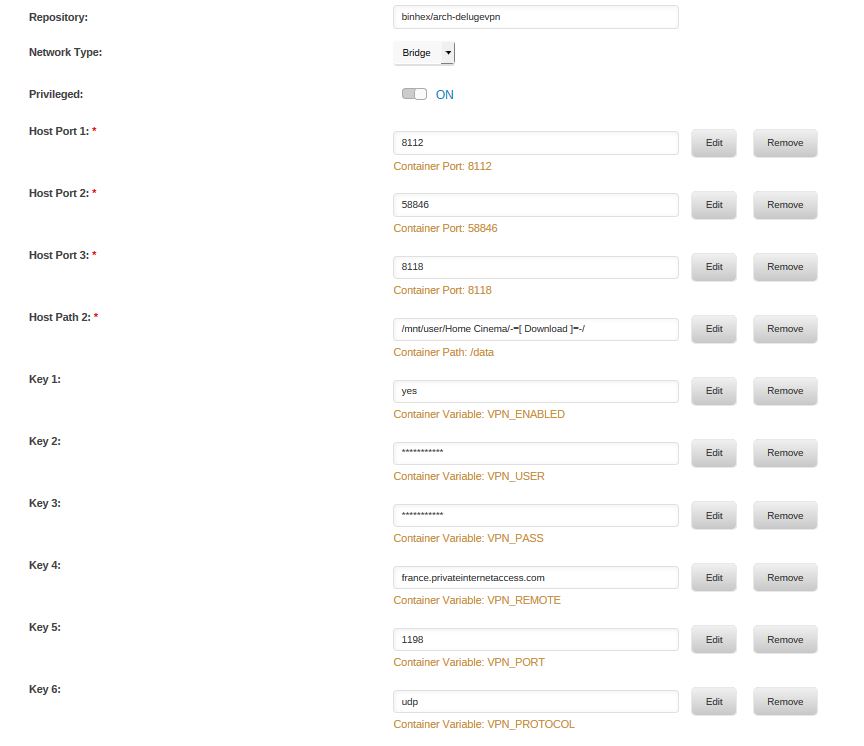

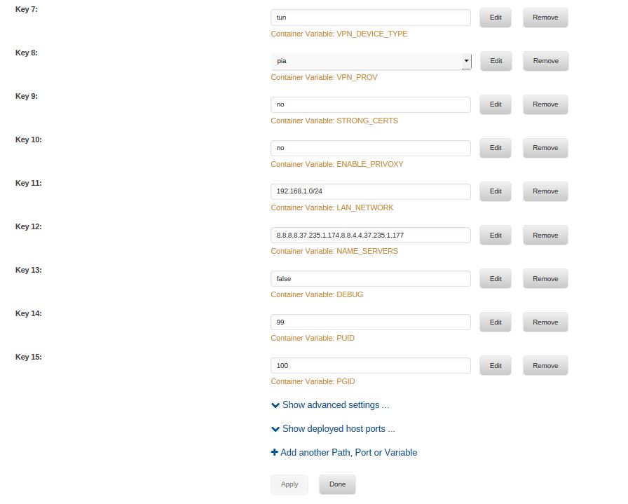

Thanks for your reply.
My VPN provider is usenetserver.
ovpn file :

Hello,
Hope you're well.
Yes, I am an unraid user.
1 - I have extracted new files from my provider to config/openvpn
2 - I put priviledge "on"
3 - I change my setting from "custom" to "PIA"
here come the new supervisor.log.
thanks !!
supervisord.zip

but your provider isnt PIA as can be seen by the VPN_REMOTE value your specifying "fra-a02.wlvpn.com", right? if it isnt PIA (private internet access) then set it back to custom, you will also then need to delete again whats in /config/openvpn/ and re-dowload from your provider your cert and ovpn file.

Hi Jonathann, Hi Binhex,
I quit usenetserver vpn and I've subscribe to PIA.
I've downloaded ovpn + crt files from https://www.privateinternetaccess.com/openvpn/openvpn.zip, and extract them to boot/config/openvpn

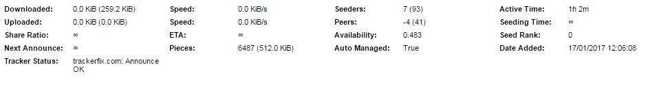

I can access Web UI, and i've added torrent files. Deluge load them, tracker is nice, but deluge does not download.
I don't understand... :/
Please check config attached :
1 - I've opened 58846 UDP and TCP port on my router
2 - I sent a ping to france.privateinternetaccess.com and I've reached 108.61.122.152. Log told that I reached another ip : 108.61.122.157:1198. maybe it's normal, I don't know.
So, could you please help me?
I attach screenshot, and supervisor file.
Thanks

The path for your data volume mapping is a bit non standard, can you try setting it to something with no special characters, my theory is that deluge cannot write to that path and thus no downloads start. Also you are configuring deluge app to write to /data right?

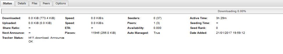

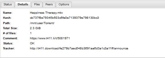

OK, change data path to /mnt/user/Home Cinema/Torrent/ and tried to /mnt/user/Torrent
Same problem.. 3 hours without download.
I think you're right. Deluge does not write on the disk. The proof is no file is created into the folder when I load a *.torrent to download.
any idea?
