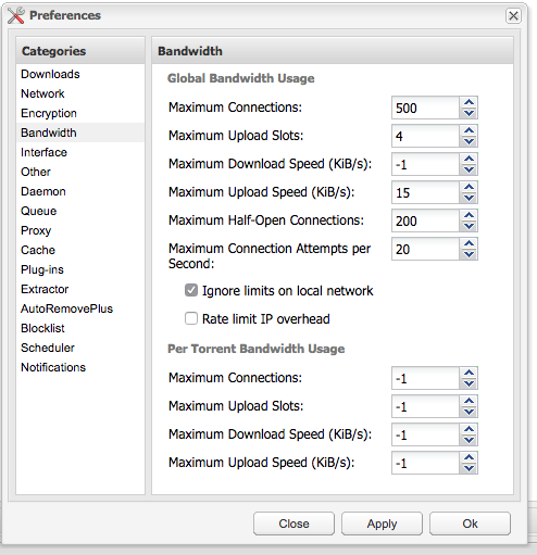

it probably is DHT, have you tried turning this off and all the other 'network extras'? (see screenshot) also make sure privoxy isnt being used
edit - sorry i just re-read your post, when you say deluge is paused do you mean all torrents in deluge or do you mean the deluge docker container itself?,  if your talking about the container then i cannot see how this is possible?! o.O
Edited by binhex

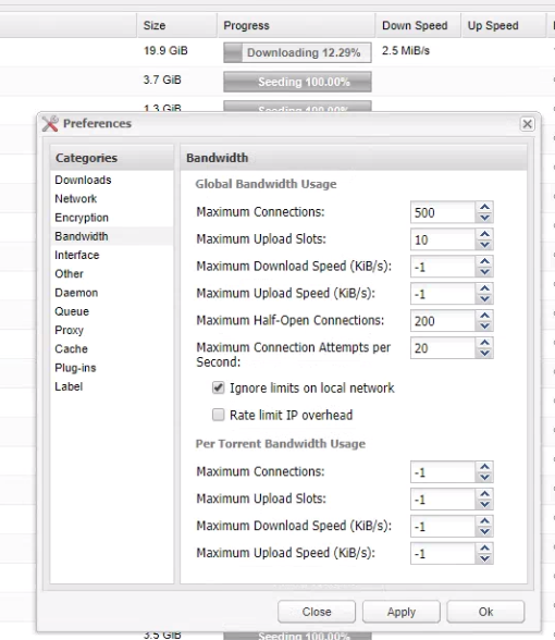

Anyway, here is how my Deluge is set up and the speed I'm getting:
5 minutes ago, nlash said:
Ah yeah, I realized that after I submitted.
you probably want to limit your upload rate, failure to do this can mean your upload rate will choke your connection and cause your dl speeds to be low, i advise setting your upload rate to 3/4 of your max upload line speed, again keeping in mind bits and bytes :-).
