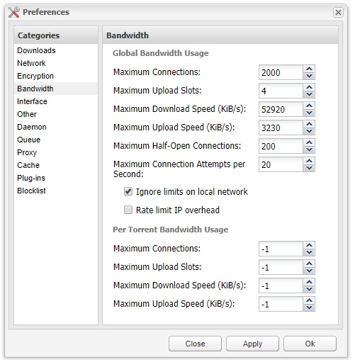

Yeah, I have the same speeds regardless of how I have my upload set.
Rate limit IP overhead is unchecked.
At this point I'll just assume it's because of the reverse proxy Deluge is behind.

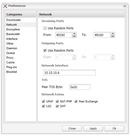

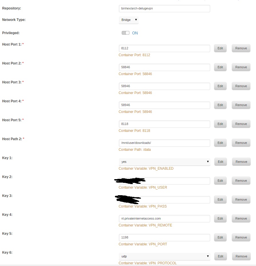

I'm having issues getting speeds higher than 500 kb/s down.  I installed this docker via the [Spaceinvader One method.](https://www.youtube.com/watch?v=km0y9lmYXE0) (which I assume most people have done).
I am connected to the Netherlands server, but I have not changed Key 5 "VPN_PORT" (or any of the ports other than the PIA username/password) in the docker.  I changed the Deluge incoming port to 49160 and made sure to forward that port in my router.  Any idea why my speeds are so slow?
This is a mistake, so once the vpn tunnel is established any outgoing and incoming traffic goes over the tunnel for this container, it doesnt matter if you have all your ports forwarded on your router, it wont make a difference, the port forwarding is done at the vpn providers end not your router.
so as you're using pia as your provider, the port forwarding is automatically done for you, all you need to ensure is that your connecting to an endpoint that suports it, which nl.privateinternetaccess.com does.
so in short, remove any ports you might be specifying in deluge and allow the magic ive baked in to set it for you, and whilst your at it, remove that port forward on your router, its doing diddly squat.
So I should change the Deluge port back to 1198?
Edited by clowncracker
no, just tick use random port, and then restart the container.
fyi port 49160 is used when the vpn is NOT enabled, then you DO need to use a set port and port forward on your router.
